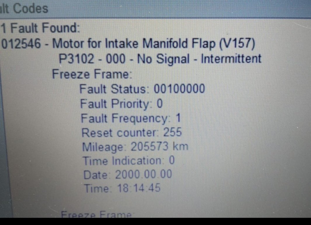

Hi, my issue is I have the engine light on, vag reader said V157 open curcuit. On inspection the flap was jammed. After cleaning with carb cleaner I can now see it working on engine shut off (closes for a couple of seconds, then opens again), but after clearing codes the engine light reappears shortly after. Fault code is still V157 motor.
Air con fan doesn't come on (vagcom reader says needs regas, and apparently won't come on if that's the case), I have the climatronic model, the aircon blows cold in cabin, but not icy, another reason I am trying to find the shared fuse. No mention of it in owners manual. I don't have the fuses above battery as on mk 1,all fuses in box next to battery are fine.

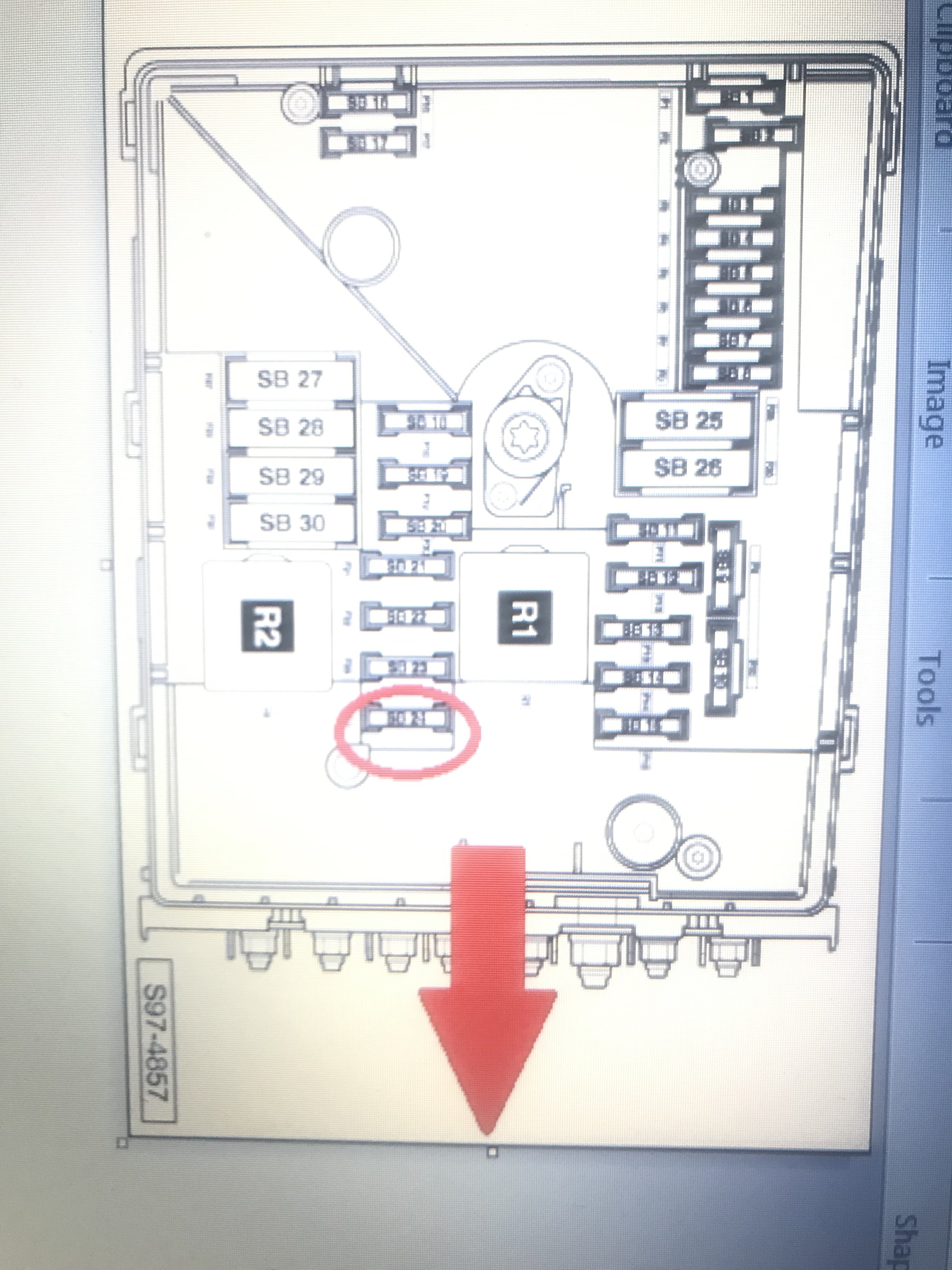

The SB fuse box which is by the battery on my car under a large plastic cover.
If you can see your flap working now you cleaned it, the fuse can't be blown as confirmed by your checking in the under bonnet fuse box by the battery. (not on the battery)
Your fuse should be on SB24 10A for earlier cars. But would need your VIN to get the correct CFD for your car to know exactly.
The red arrow points towards the front of the car, SB24 10A is marked in red.
Edited by 3T51704x4

What's the exact fault code that you're getting?

Thanks all,
This is the original readout attached

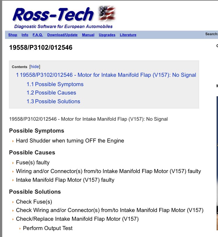

Thanks, I'd googled that, I don't have any shudder at shutoff,which makes me think the value is working, and as I say, I can see the flap closing for a few seconds on shutoff
So live and earth are ok as the motor is working, sounds like the feedback to ecu causing the DTC.
Either going to be continuity interrupted by broken strands within the PVC of the wire OR a knackered V157.
