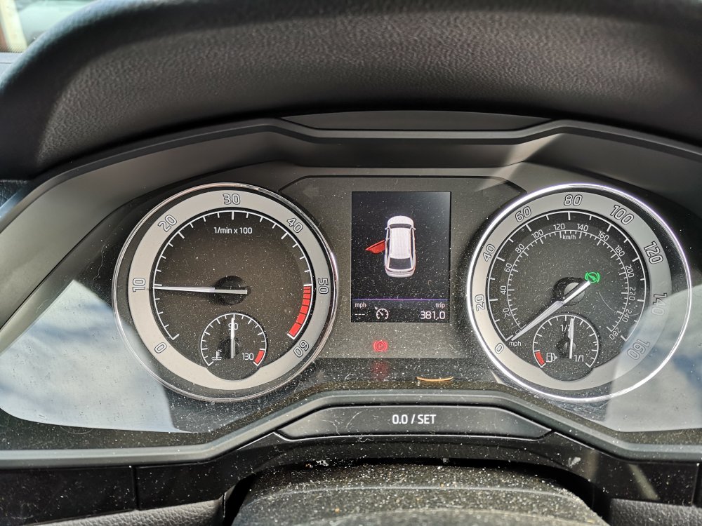

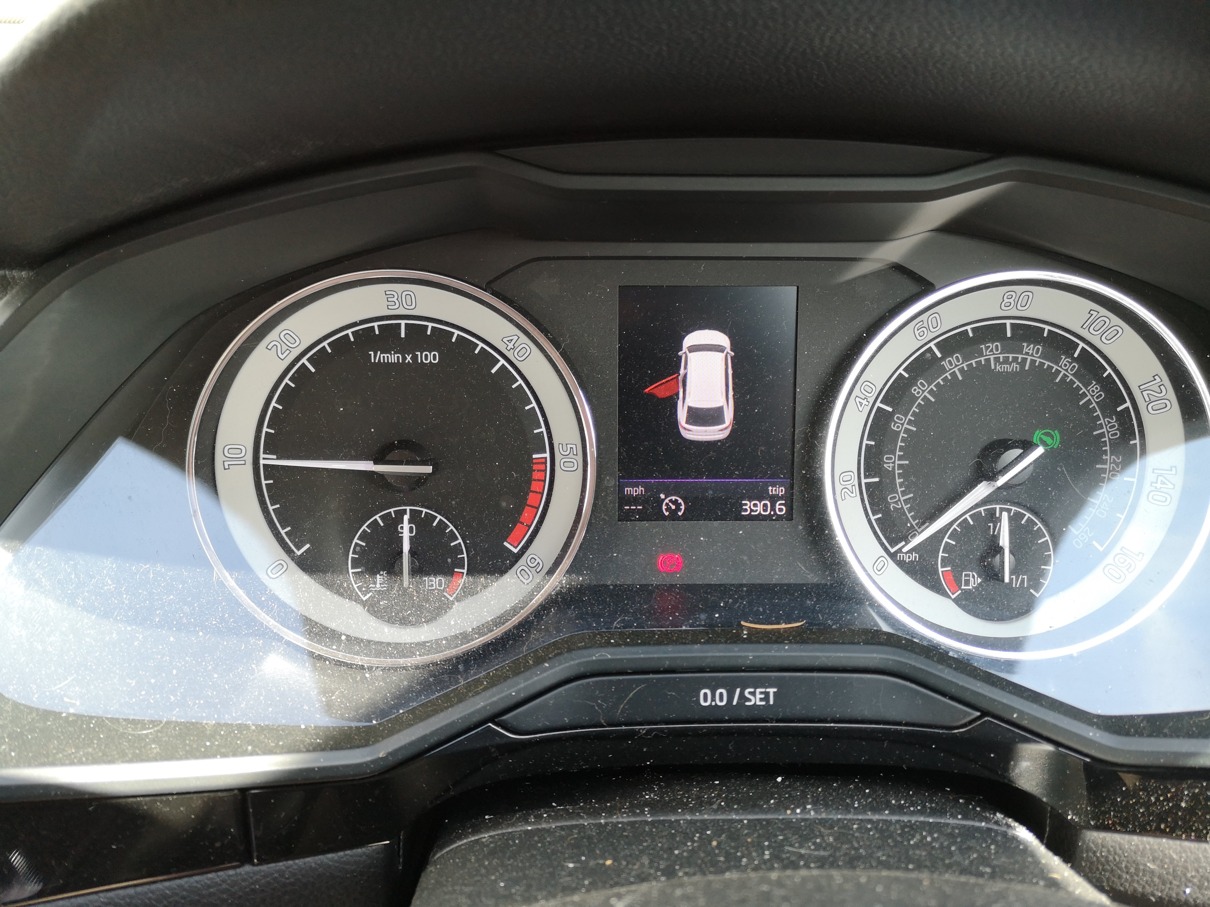

Do you ever clean your instrument cluster?
Yeah clean the car and I bet all the probs vanish !
Think it's from the beach as lists location as Pendine Sands, Wales.:blush
Thought you put Vanish in the washing machine?:thinking:
