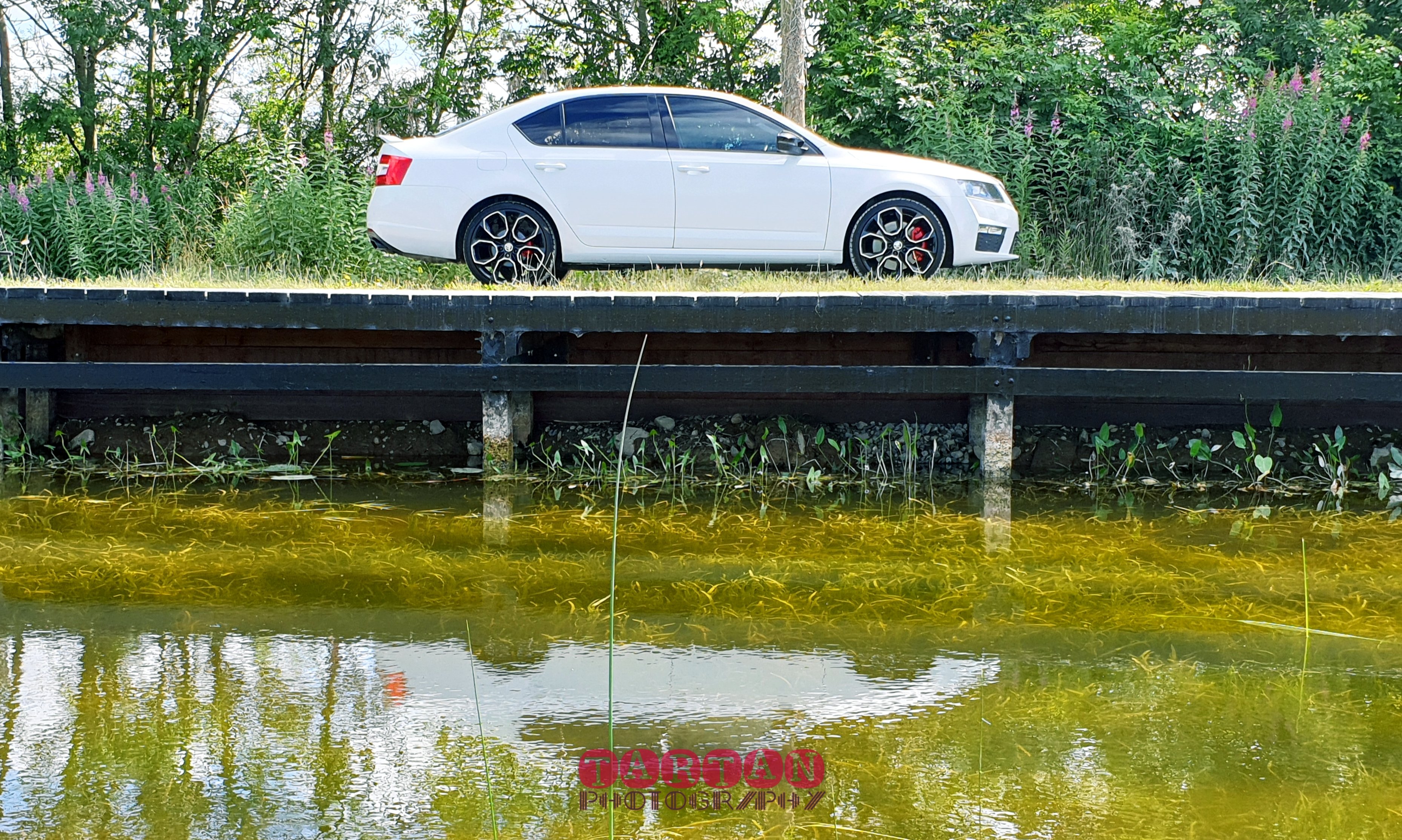

20190409_181020.jpg.80a388c76a0678183b2825767f39227e.jpg20190409_180925.jpg.a963fcd0312d9f91598be12b552aee36.jpg
15 front and 20 rear, tyre choice can make a difference, im now running 235 Pilot Sport 4 and the gap is even smaller. still no rub!
