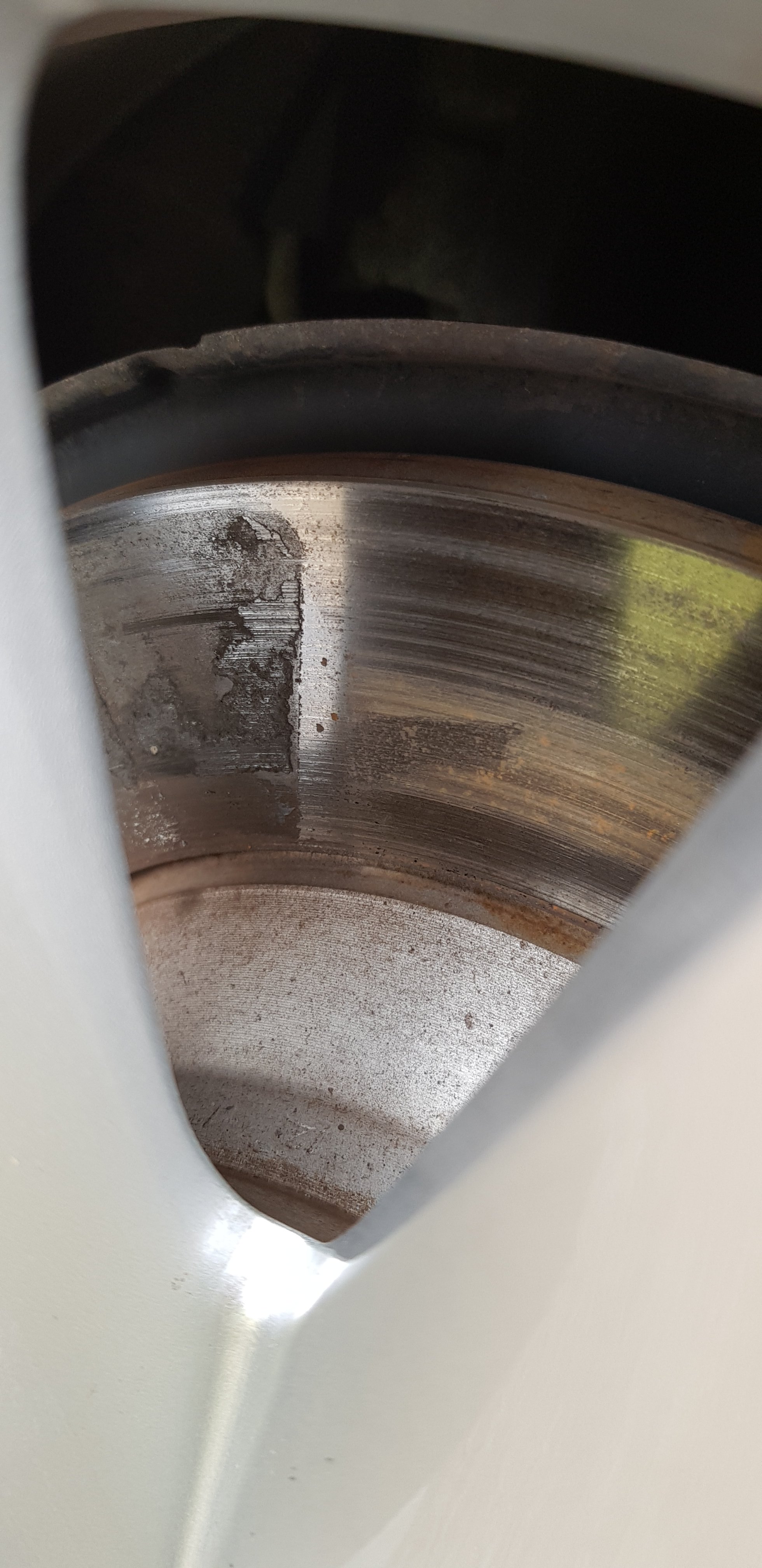

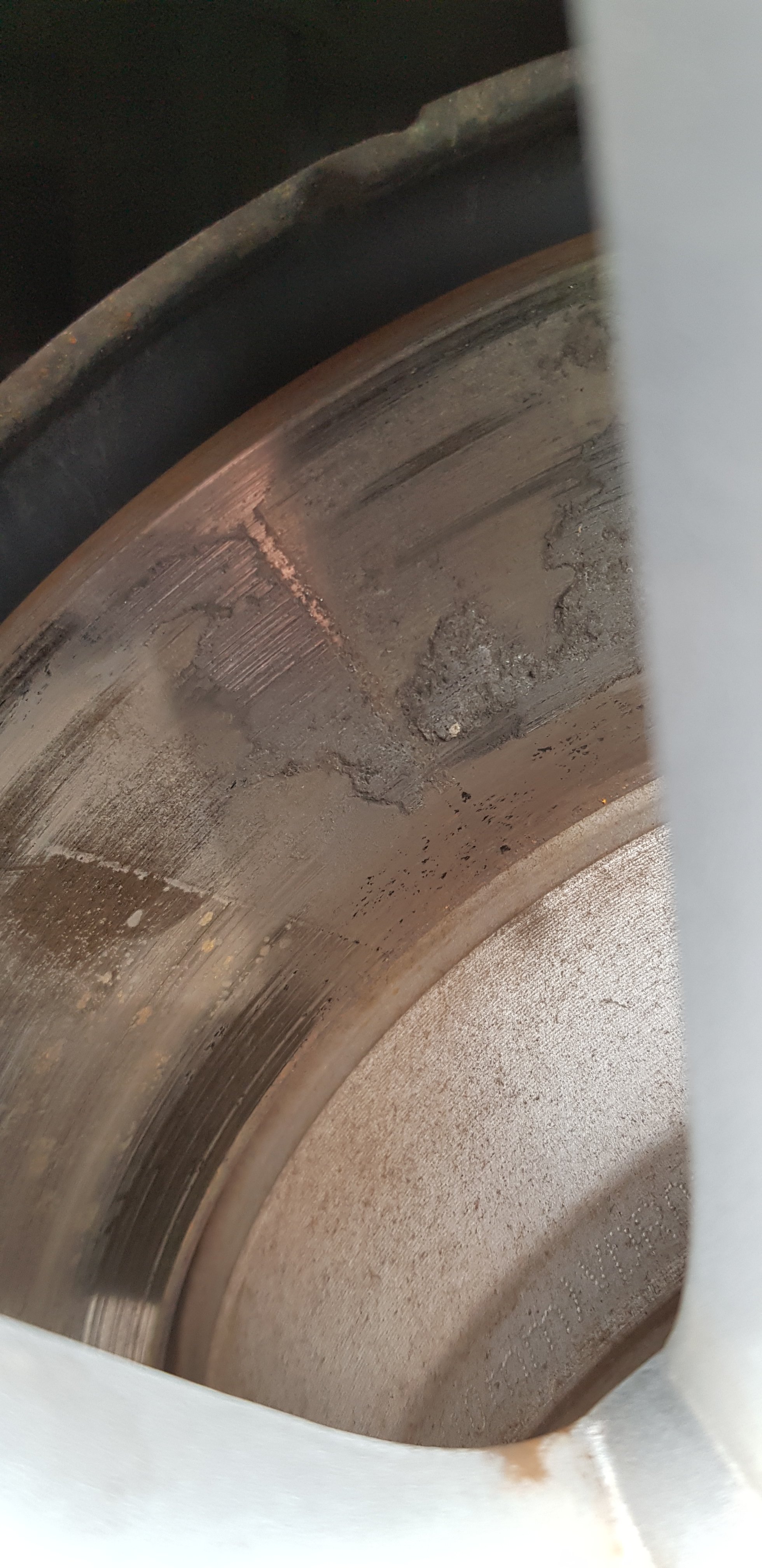

Interesting, @Awol. I can't see any pad-shaped areas but on the rear off-side disk there is a distinctly visible discoloured area that feels rough to the touch. Maybe this is a zone of corrosion responsible for the noise? All the other discs looks clean and smooth (but perhaps that's deceptive).
Is there any possibility I could make things worse following your drive-and-brake-hard recipe? Might it be worth taking the car to the dealer? Or will they simply do what you suggest and charge me for it?
Well I can see a pad shaped area on your photo but more seriously also a large delaminated area where part of the disc surface has detached. This is the source of the banging. The disk is toast. Complain under warranty as that delamination shouldn't happen and indicates the disc was manufactured with faulty material.
Good luck however getting past the wear and tear get out clause stonewall that Skoda will try on. This is not wear and tear. Shout it out loud to them.
Have another look, to me it looks more like the surface of the pad that has adhered to the disc! You can even make out the slot in the middle.
Actually on the first pic it does look more like the disc that is buggered, its so hard to tell. Either way, I've never seen anything like that on an old car never mind a new one, bit disappointing to need a brake job so soon
Edited by SuperbTWM
You might be right, it could be pad material on the disc, though I don't how it would manage to stay adhered to the disc.
Needs better photos or someone to inspect, wheel off even better.
