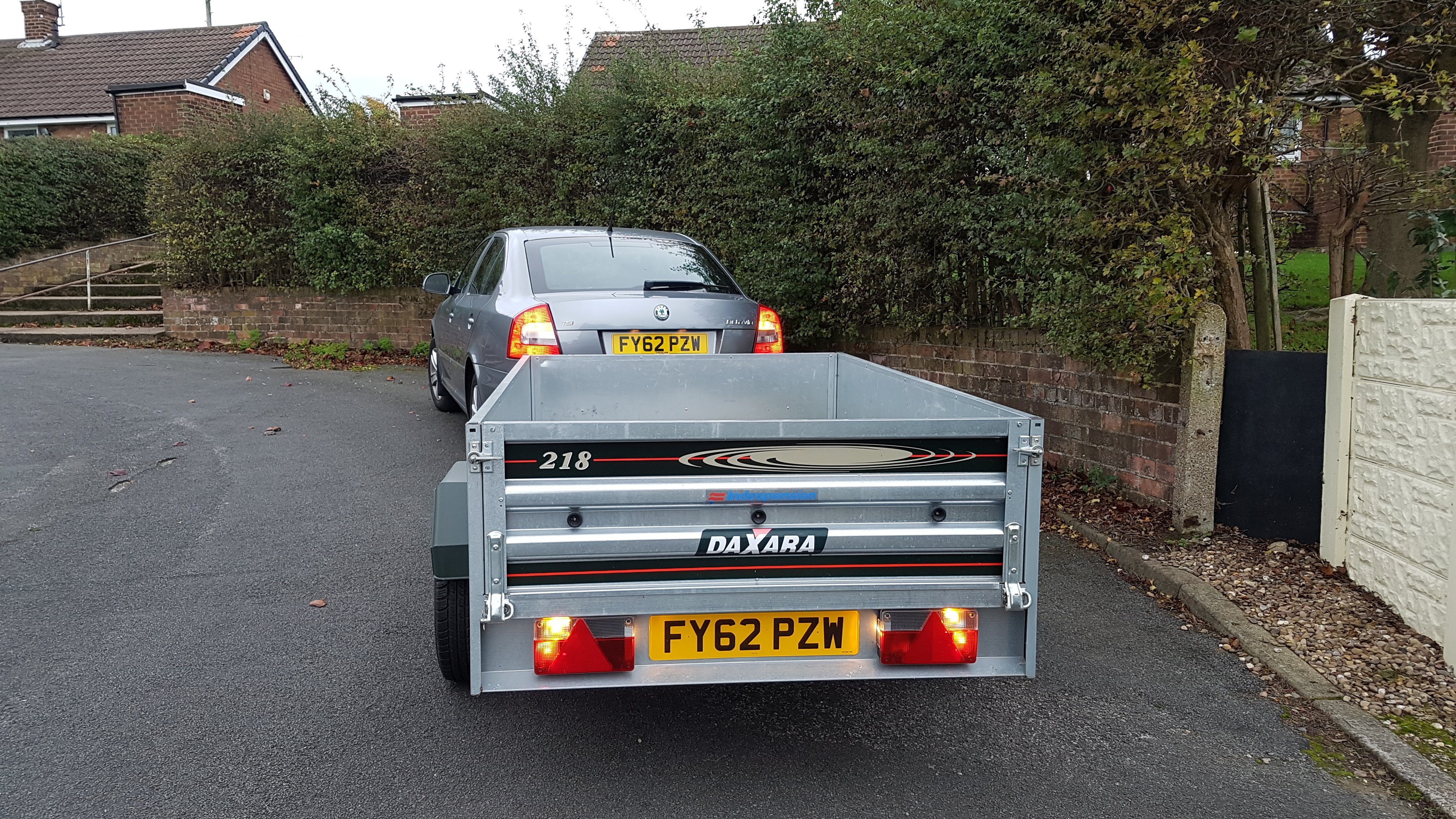

Gave in to impulse lol
bought a brand new trailer, only a little fella but it fits in the garage and does what we want it to...
came flatpack so had to squeeze it in my husbands car, crikey is it ever heavy!
edit:
as it’s a lightweight fella, does anyone have any tips for stopping it skipping around when empty?
