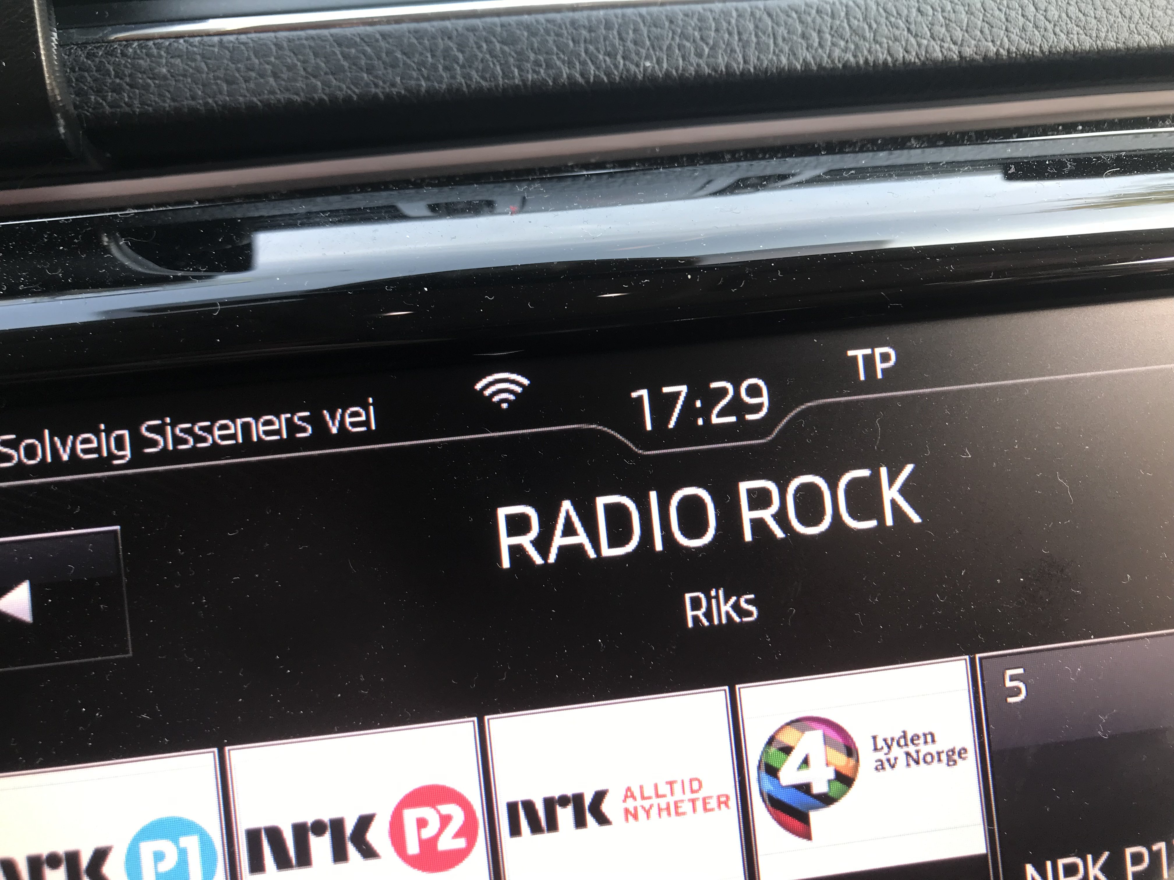

When I ordered the car it was an option if I would have a SIM card slot. I did not choose that. However there is still possible to connect the car to a WiFi. I might use my iPhone, and connect the Columbus to the 4G.
When I have connected the Columbus there is an icon beside the clock that indicates it is a WiFi connected infotainment.

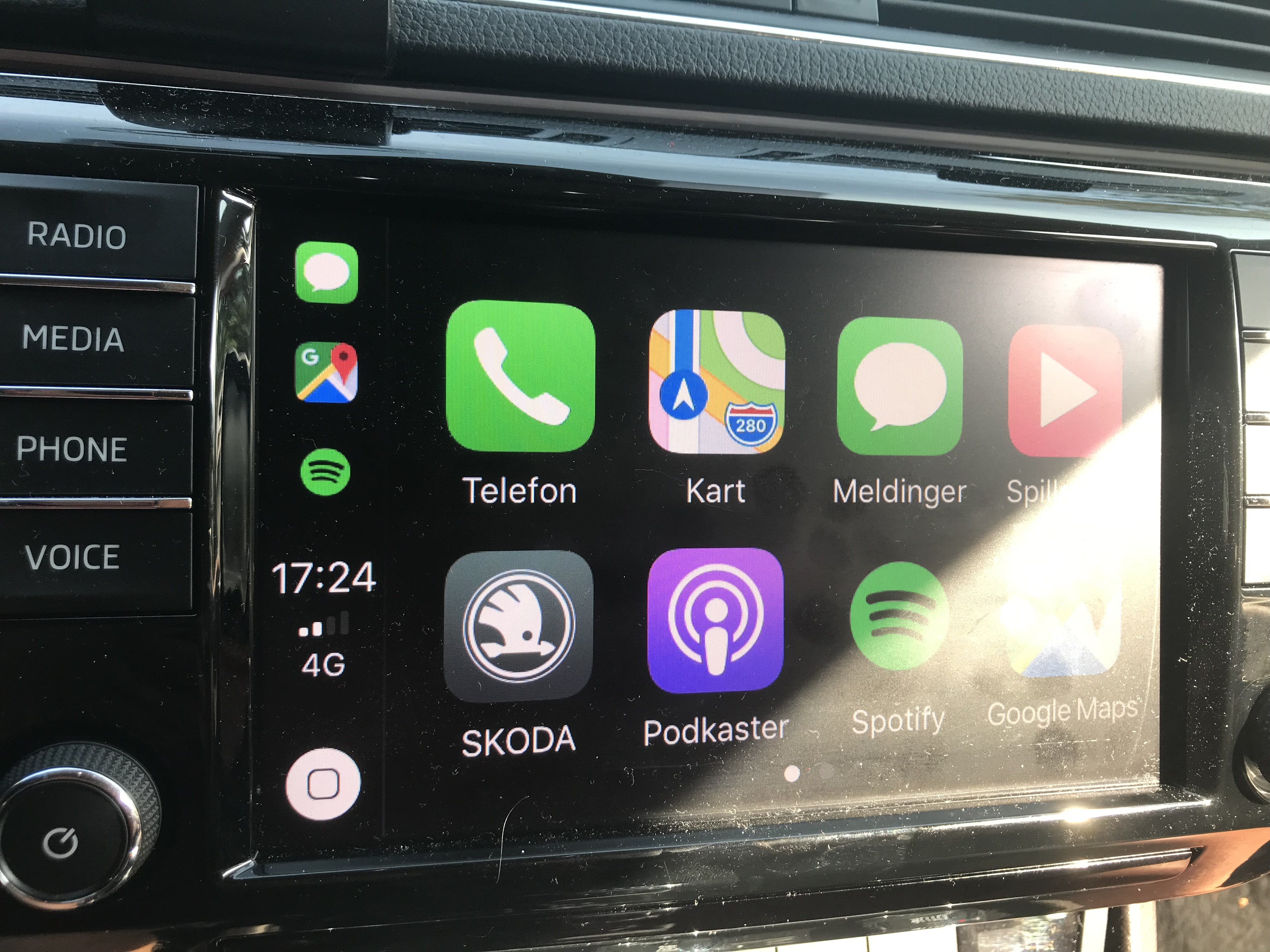

And when I connect with the CarPlay it appears a 4G icon.
Look at the pictures.

The 4G in the first pic is just showing that your phone has a 4G signal currently, rather than a connection your car has to the internet.
You can’t connect the car to your phone’s mobile data through CarPlay - CarPlay requires a physical connection and the WiFi connection to your phone only works wirelessly.

Yes, the Columbus does. I have done that. I parked my car home, and connected the Columbus to my WiFi at home. I then connected my iPhone to the hotspot, Columbus. It worked.

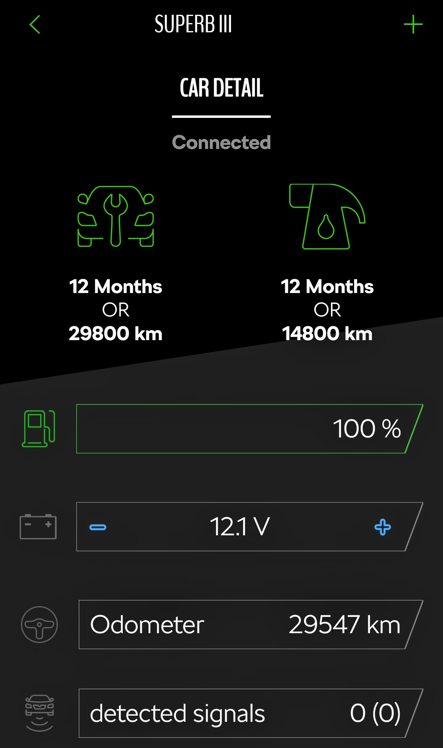

By connecting to the car's WLAN, u can launch the MySkoda app to see additional info...
But yes, otherwise the WLAN feature is useless.
