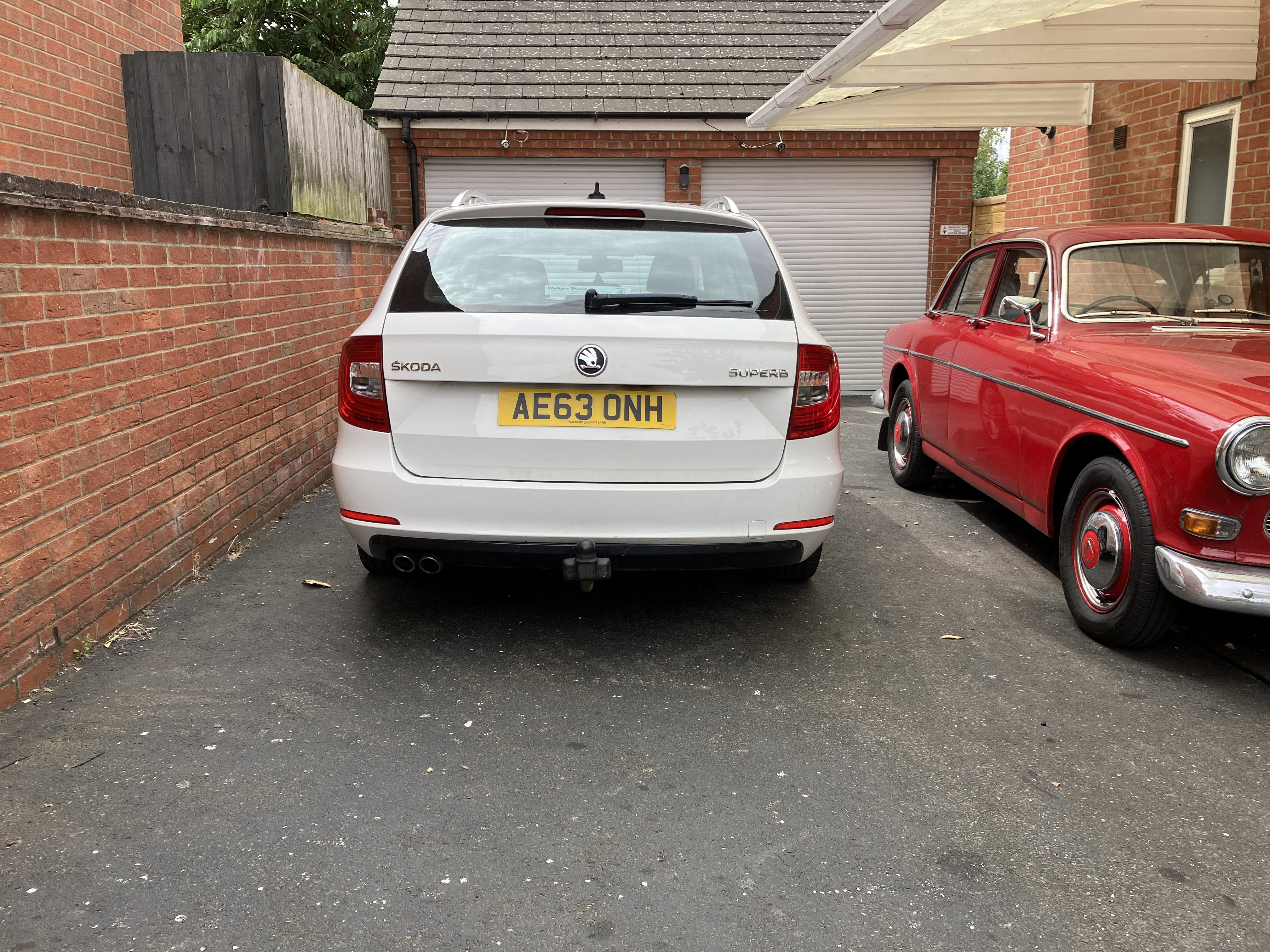

I’ve just taken the motor car out for a test drive, everything is straight and level:
… a good job 🙂

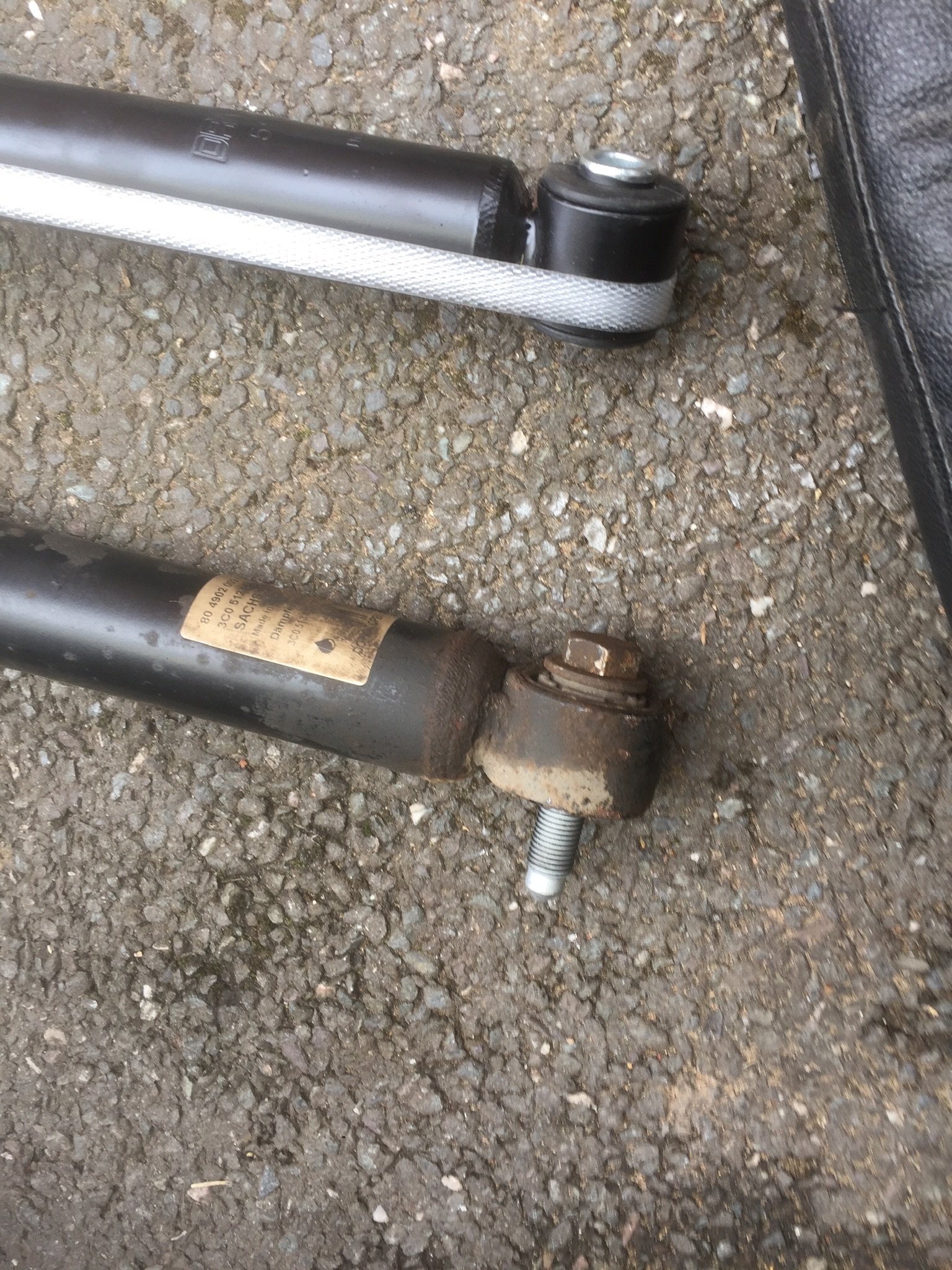

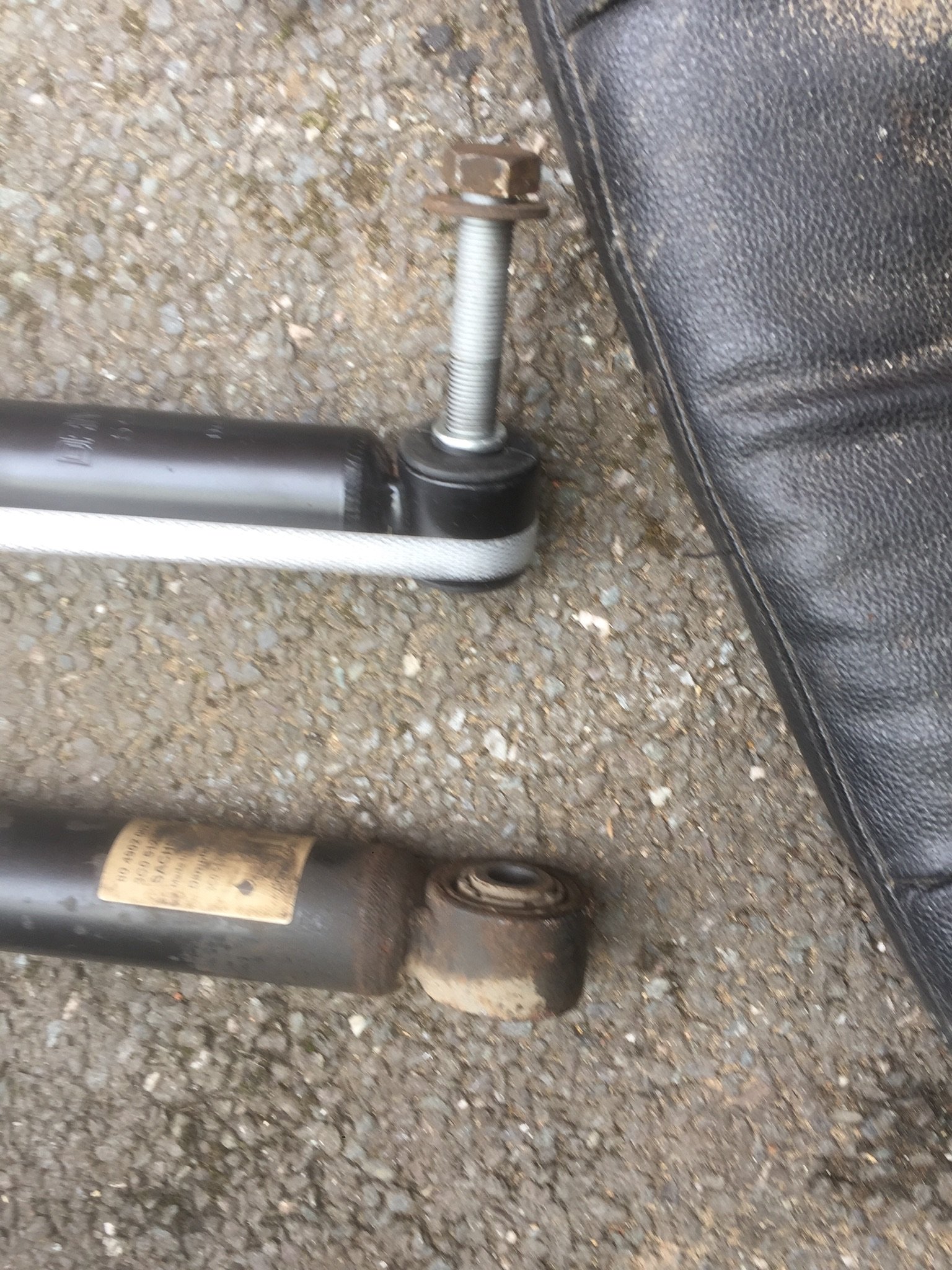

The good news is the bolts arrived in the mail, I followed chimaera's advice (which worked perfectly) and everything came apart easily - the bad news is that the (online) motor factor had sent the wrong shock absorbers. Everything looked fine with the new parts until I checked the bottom bolt for size, and found it was too narrow to accommodate the 21mm bolt:
This is how it fits in the original:
... everything had to be re-assembled and the shock absorbers will have to be exchanged for the correct parts - so this will be a job for next week. Fortunately this is not an urgent task, it was just an advisory point on the car's recent MoT test, but it is still irritating to have wasted a couple of hours.

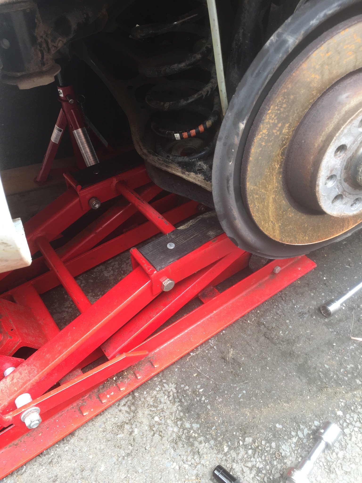

This job really shouldn't take long once I have the right parts. Once the wishbone is lowered and the spring dropped out, access is really easy. I used my motorcycle lift to lower the wishbone and realign the bolt afterwards:
This worked perfectly, and in addition allowed me to get the suspension to the right height for torquing up the bolts.

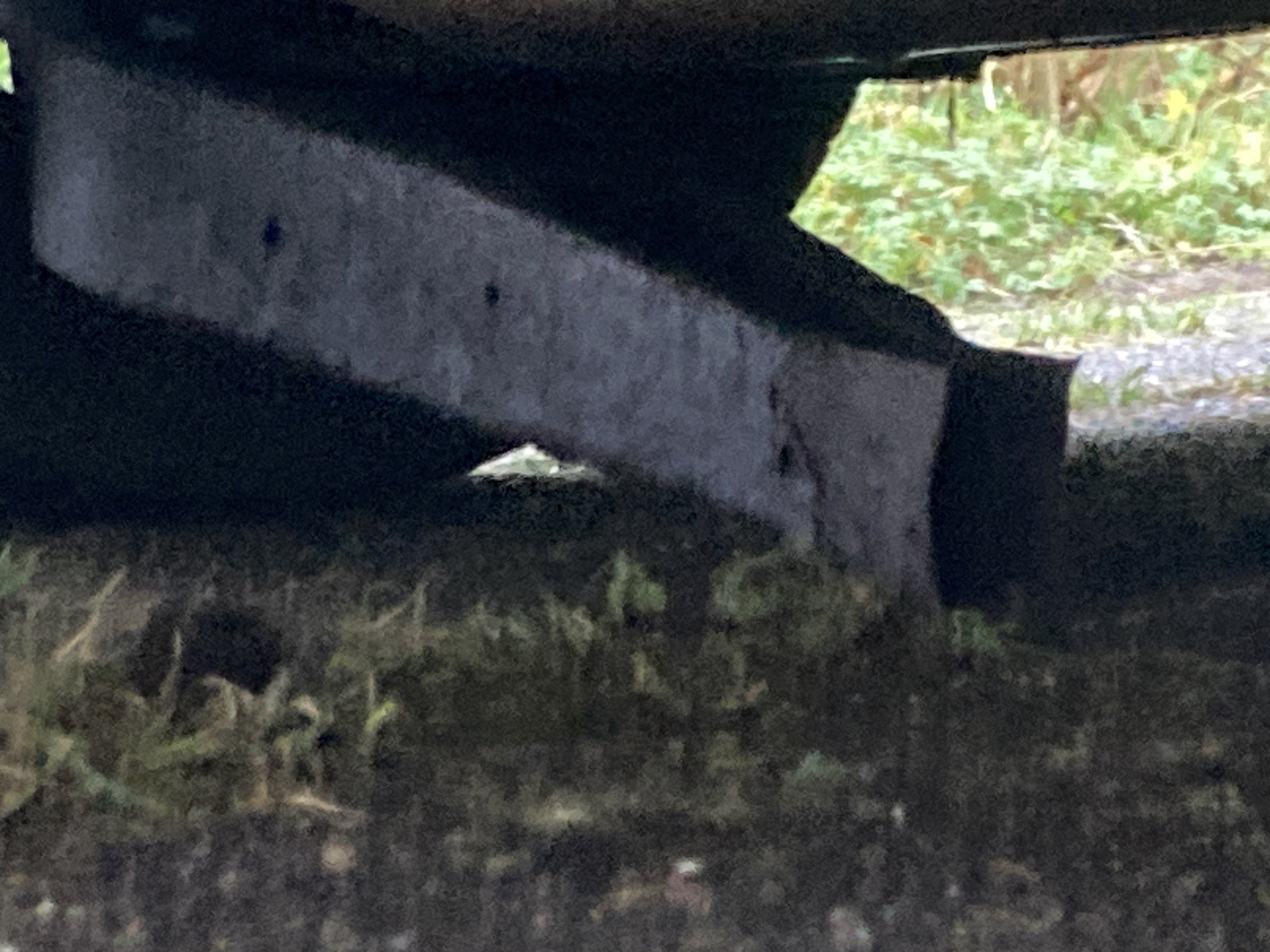

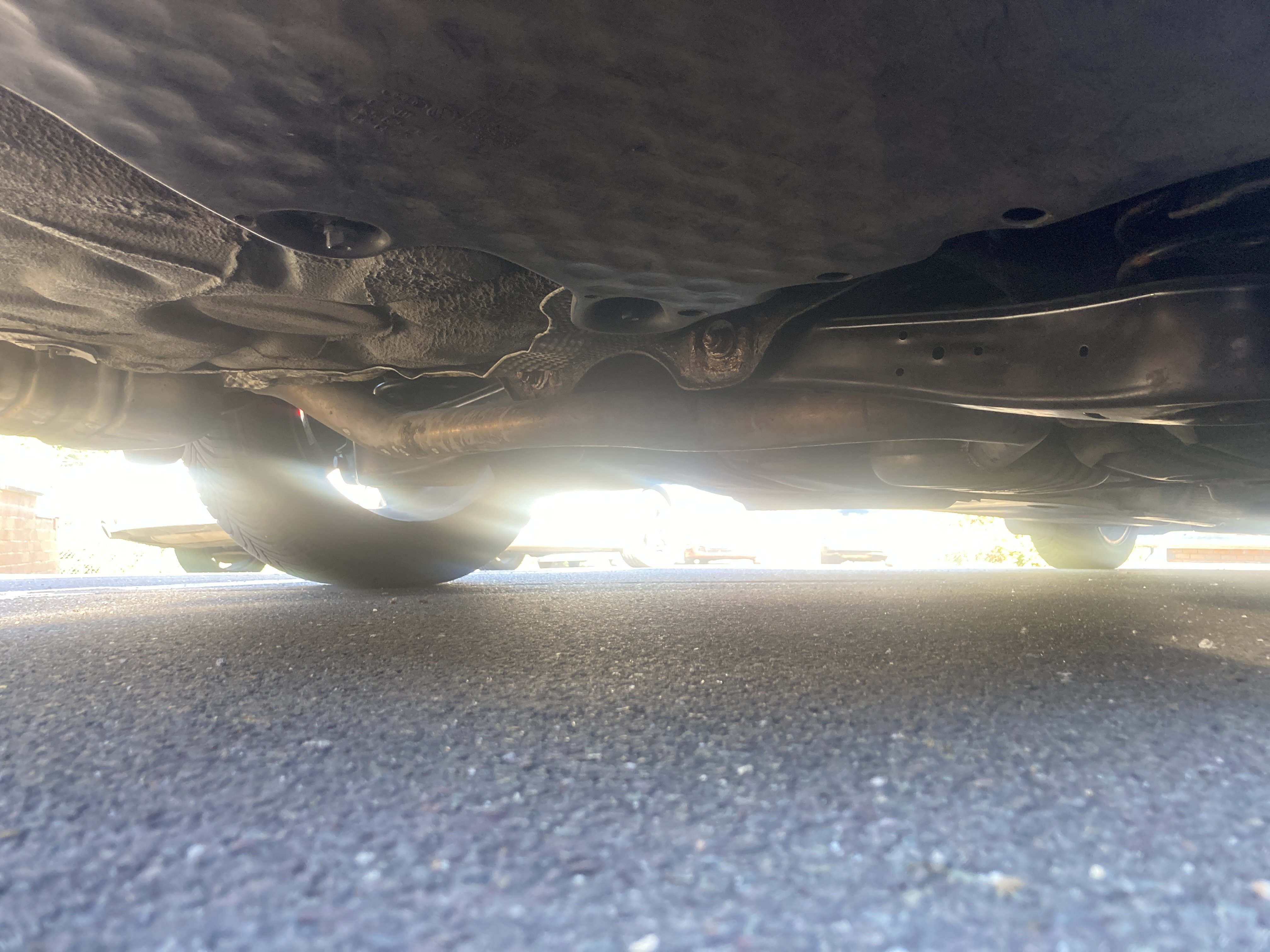

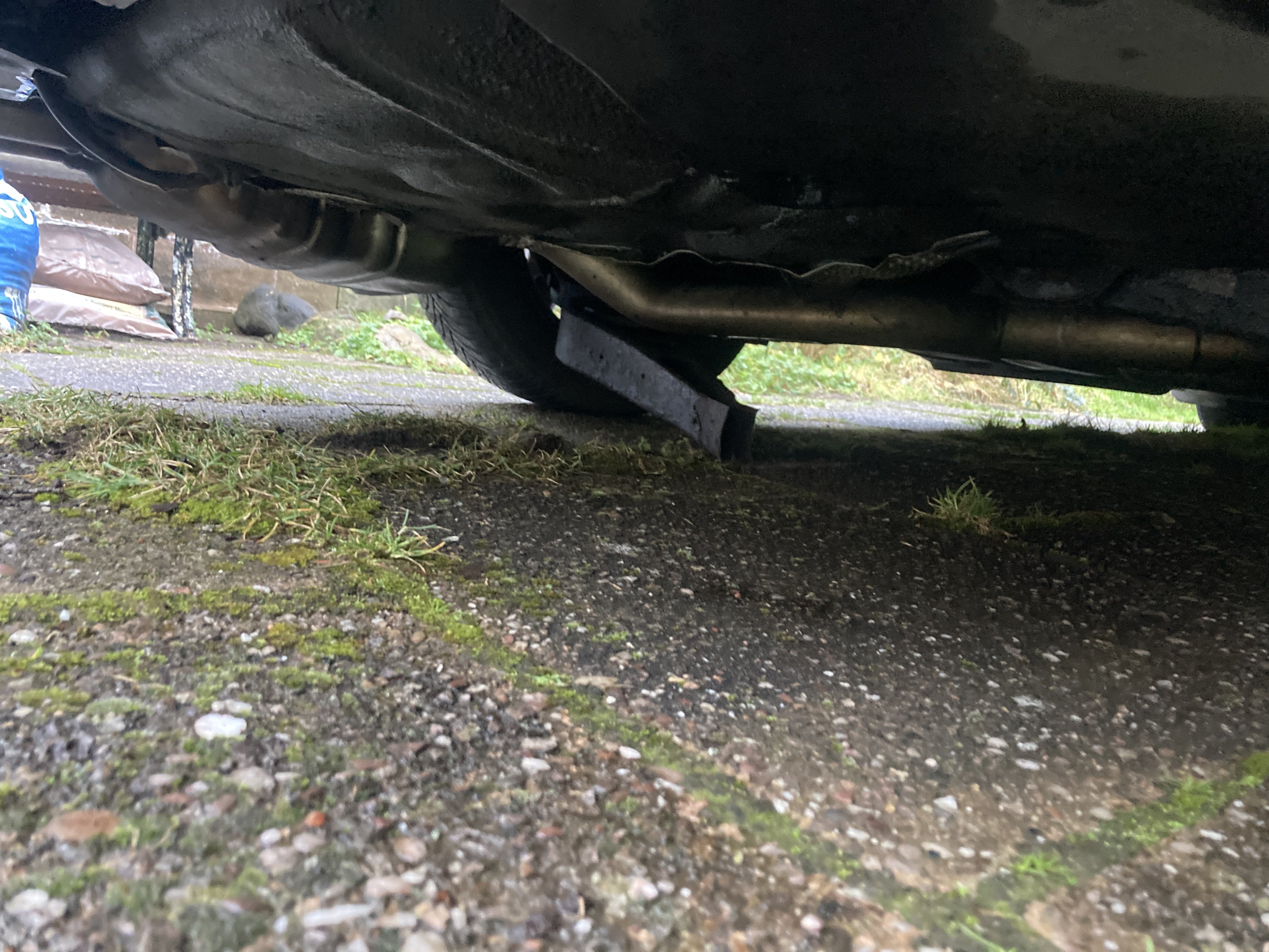

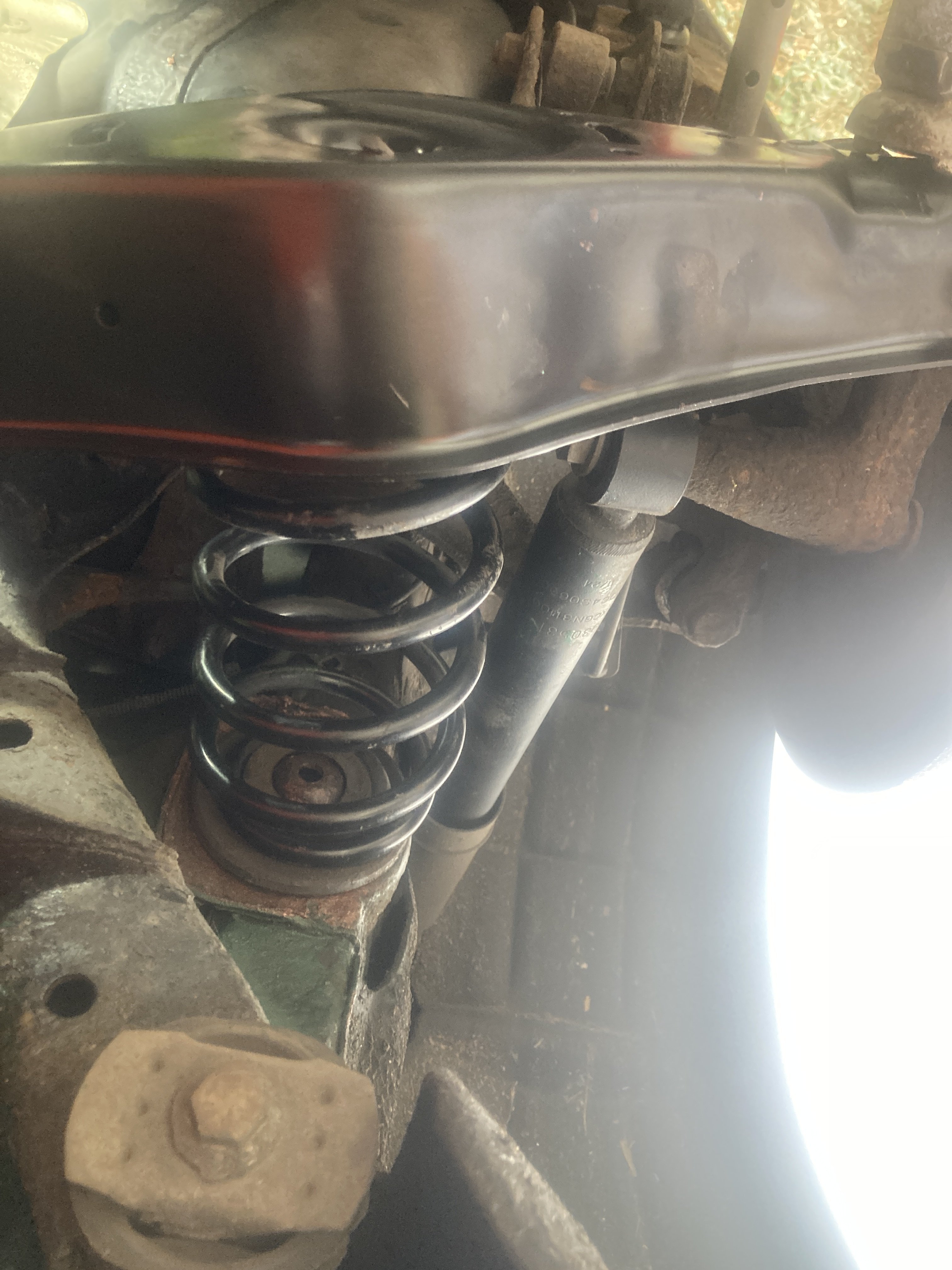

I'm in the middle of this job (write-up to follow later as part of a bigger project) and am struggling to locate suitable axle stand points as if jacking up from the side rail there isn't any space left to put the stand in beside the trolly jack.
In the pic above it looks like the axle stand is under the rear subframe, just in from the mounting bolt - is this considered ok? Or any other suggestions?
On my Mk5 Golf the car is so short and much stiffer than the Skoda that I can jack the front and the rear wheels come off the ground!!
Correct, you can find a suitable spot on the subframe to use your jackstand. Or even better a suitable spot where the subframe is mounted to the chassis.
Any thoughts about actually (gently) jacking up from the subframe mounting point? If its ok to support it from?
NB - on my golf, with Racingline (VWR) springs in it, when I jacked up the lower suspension arm to set the ride height for the final torquing of the bolts the car was raising off the axle stands - I'm expecting the same with the B12 kit when I fit it. So, actually carefully jacking under a sound spring platform arm seems to be ok, but not my first choice!!

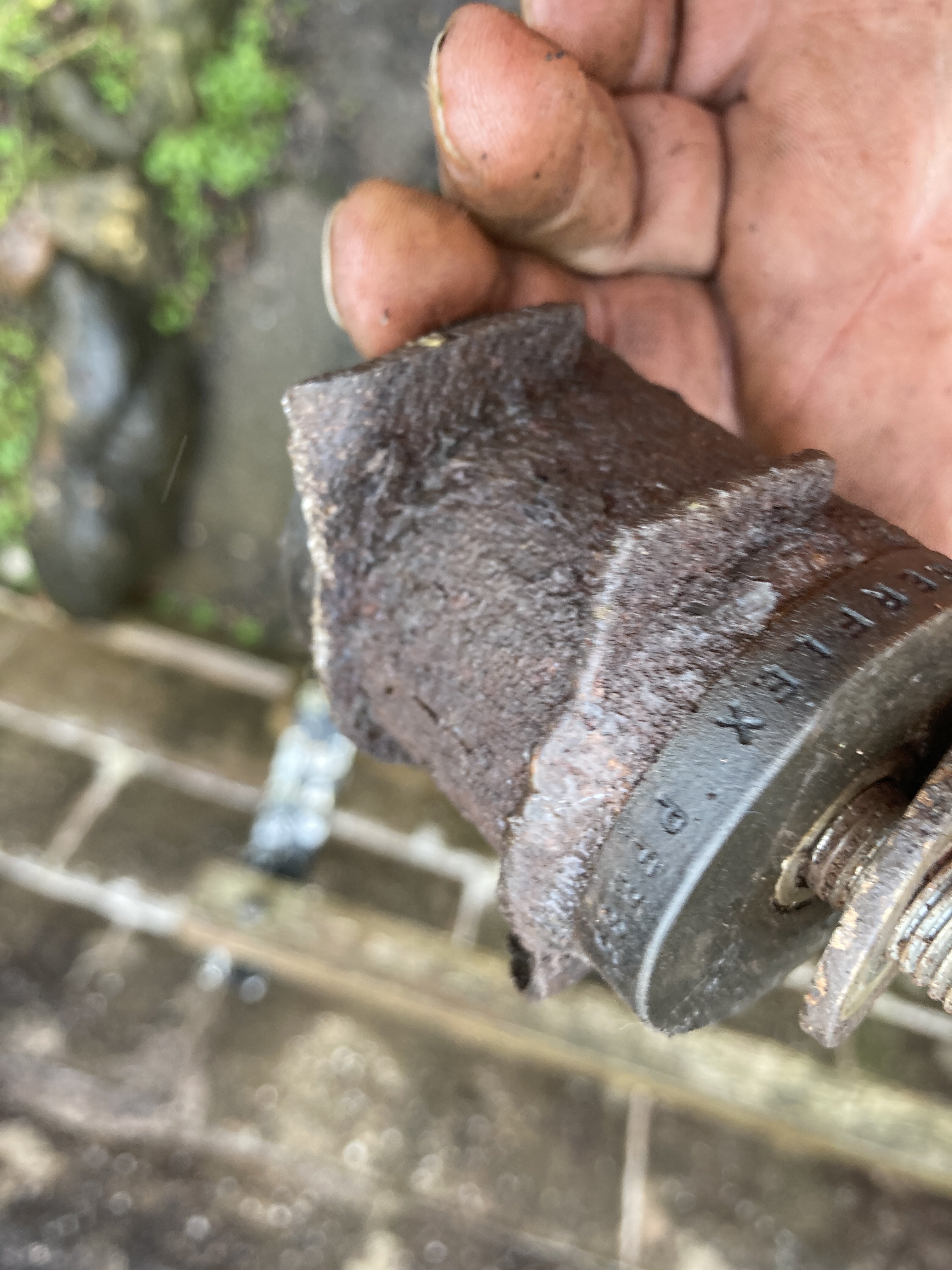

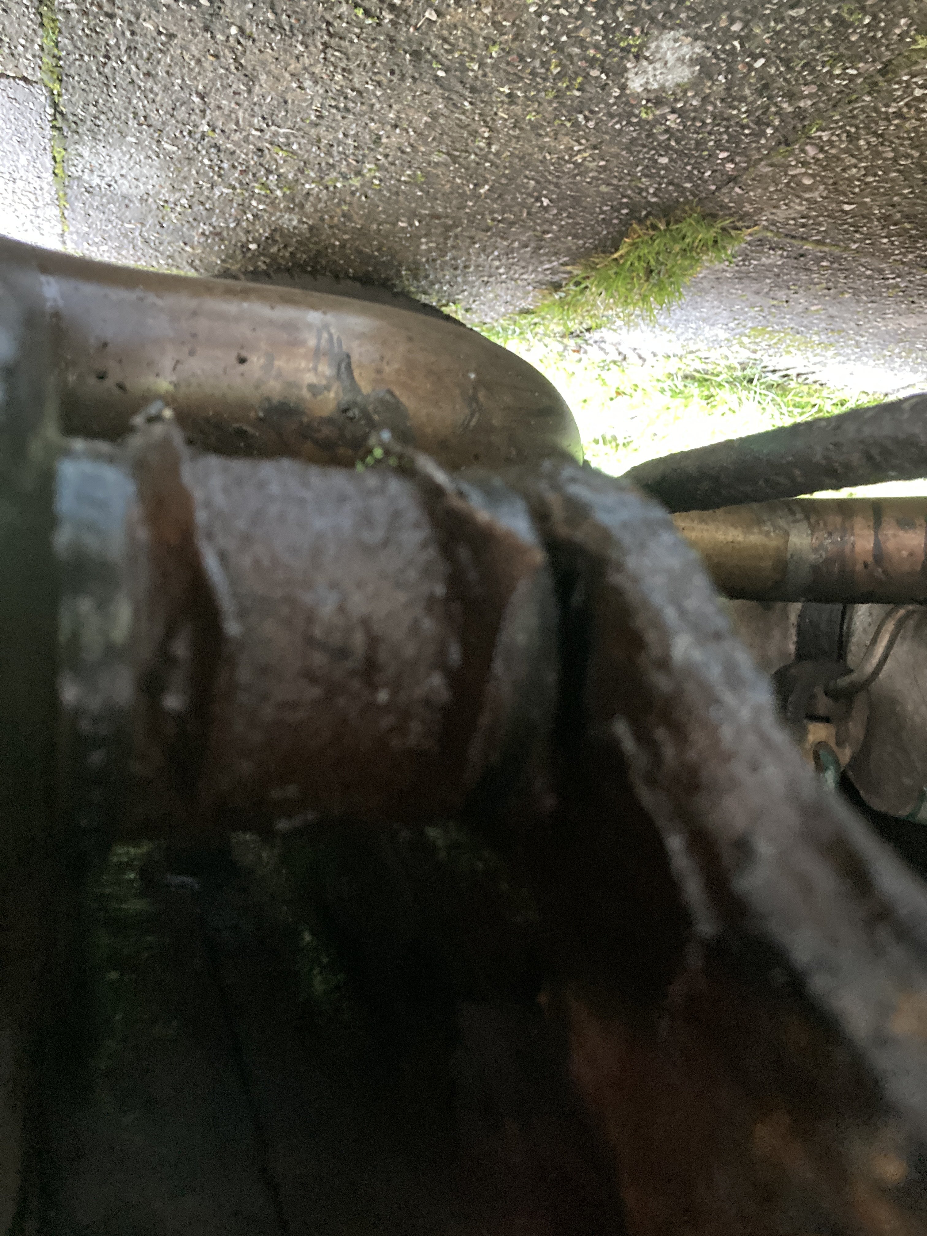

Also seriously look at the condition of the rear spring platform arms - My 10y/o 50k miles Mk2 Superb arms are rotten. Unfortunately I cant get the inner bolt out of the arm so it needs to go to the local workshop for the arm replacement, but I will have done the shock and added the spring and rubbers.
Take note of the post above, changed my shocks and springs then this happened…
Arms are not dear, avs car parts has all the bits,so change the arms and bolts both sides and got realigned.

Better view of the arms
You've done well there @Nackuk - I could hear mine creaking with the rust when I was jacking them up to get the shock bolt torqued at road height.
