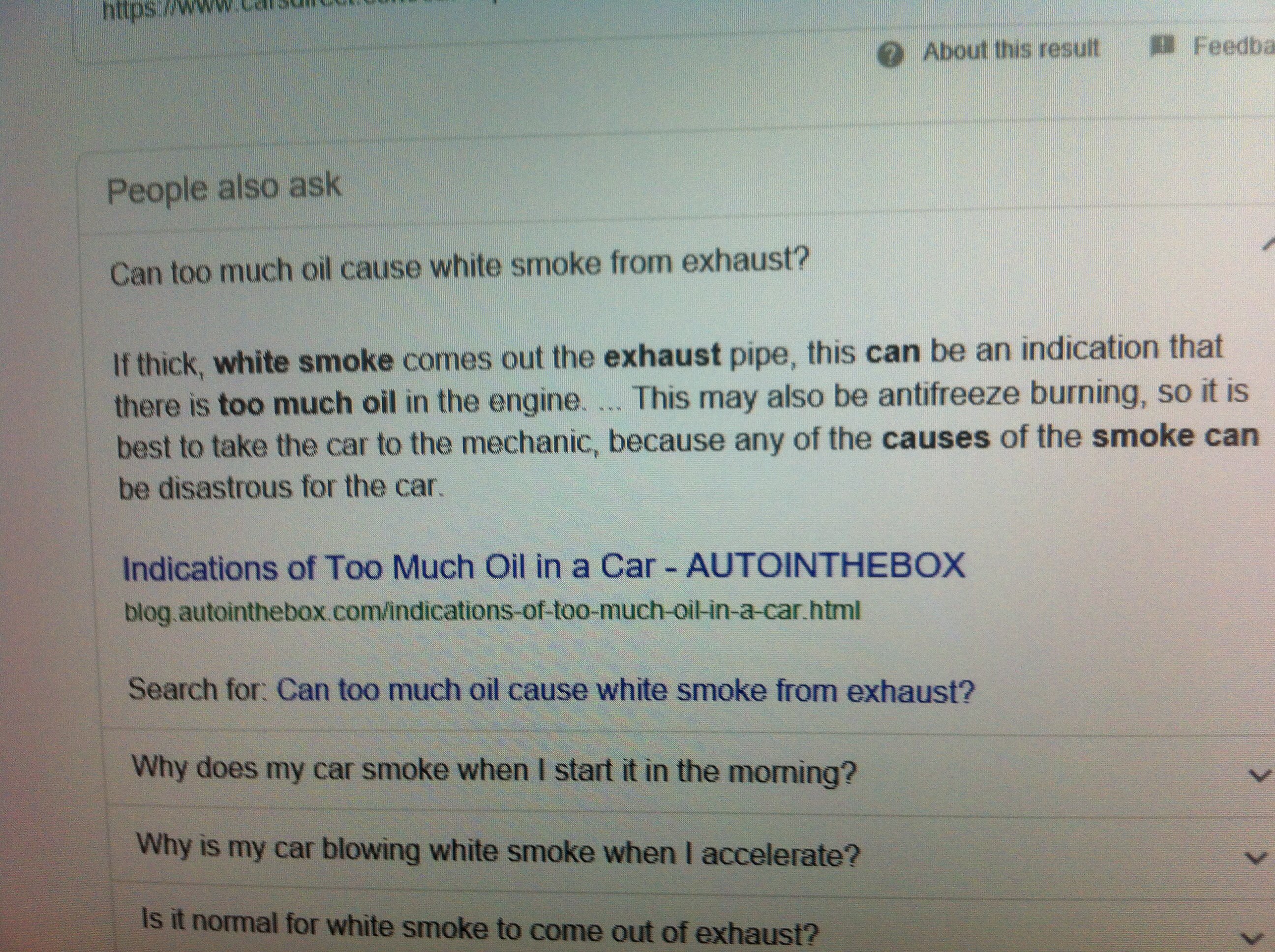

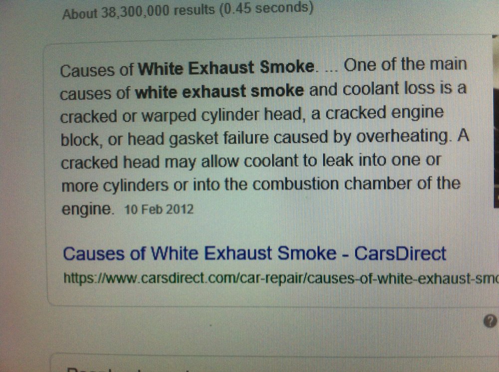

Could be one of these reasons.
Thanks. I looked into those and doubt it falls into any of those non-turbo categories. Only happens when really boosting power using turbo. Otherwise clean.
