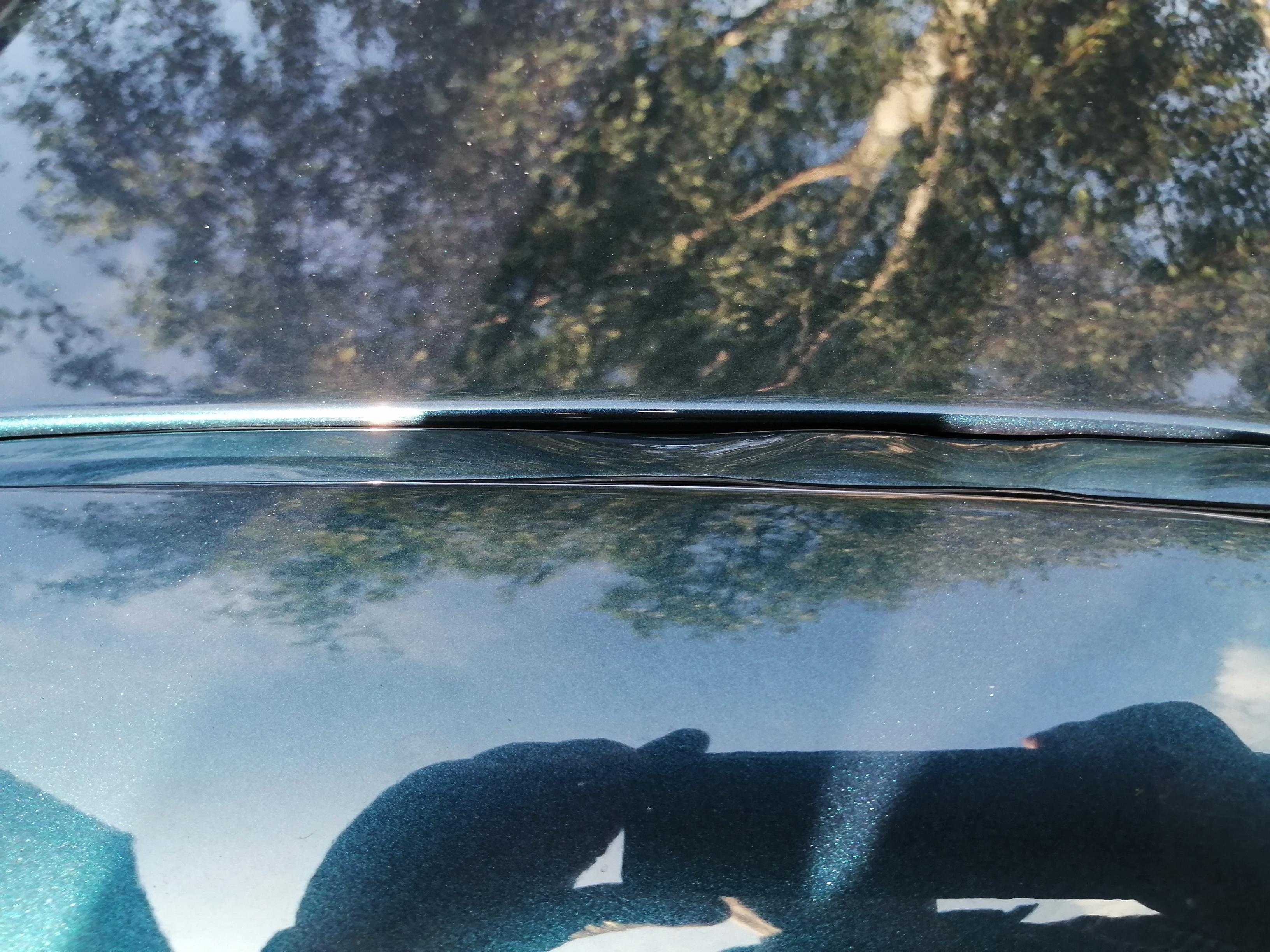

OK, an update on the trim problem, after a very long time of trying to find one in car salvage yards, I have finally located one and will driving around 200 miles in a round trip to collect next week. It only cost £24 but sadly not in colour, so I have to source the matching paint still, but I'm looking forward to fitting this as I'm getting fed up with the ugly look of old trip after it was ripped out by one of those American style car washes. I don't appear to have posted a photo of the poor trim piece, so I'll post below now.
If it all goes well, I'll lift out the O/S one and fit it closer to the windscreen as that one is now slowly being lifted out of the channel with the wind hitting it.
Thanks for the useful tips and comments already posted here.

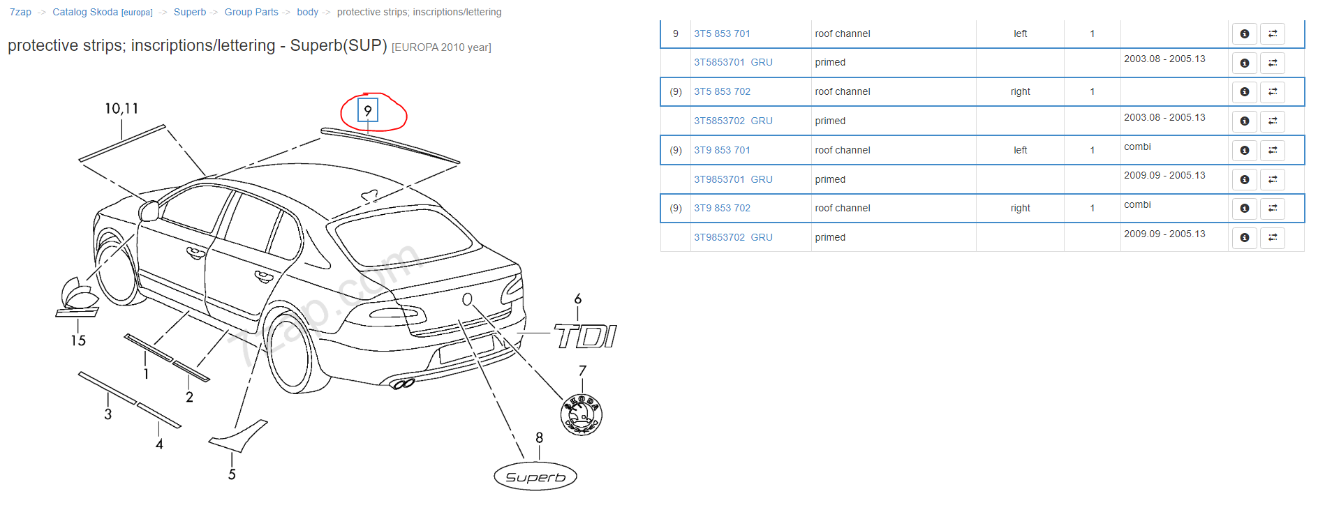

I know this is an old thread, but does anyone happen to have the part number for these?
Hatchback
Left: 3T5 853 701
Right: 3T5 853 702
Combi/Estate
Left: 3T9 853 701
Right: 3T9 853 702
