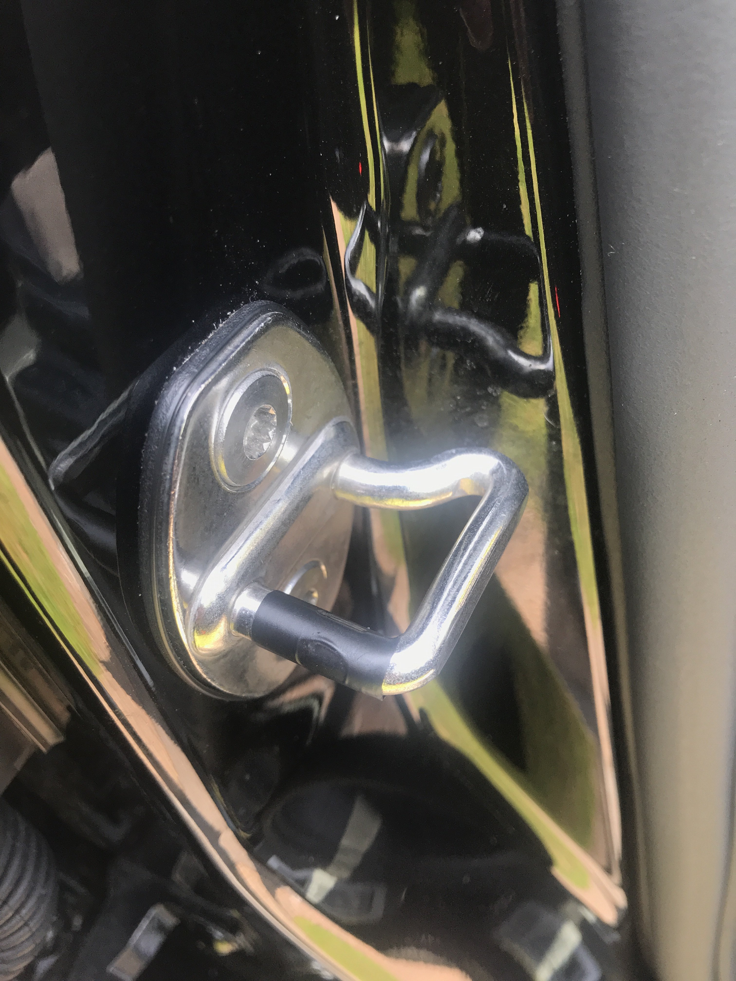

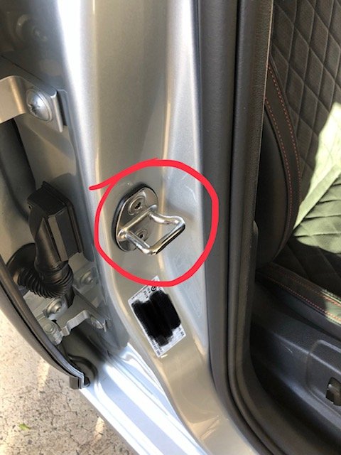

Well I've come up with a temp solution for now:- Some tape on the door striker has solved the issue. So for me it's the door latch clacking on the door striker.
I've tried to loosen the door striker and tap it in towards the car lightly to try and tighten/pull the door in when it's closed, but it didn't appear to move at all?
There is grease being left on the tape so I'm not convinced it's a lack of grease on the latch that's the issue. Not sure on a total fix now?
