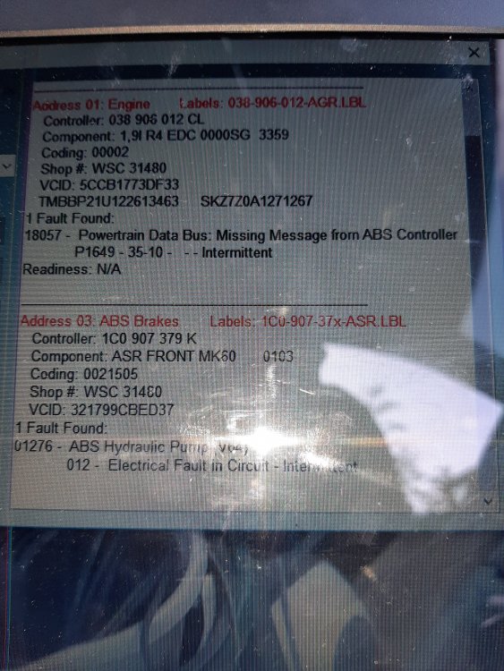

Hi all please help me I have these fault codes any help would be great I.e what wires am I looking for? Where is the grounds for the pump? And which fuses do I need to check
The top fault code only came on today but the other has been on for a couple of days help please

@a18nkd - OK, the first stop is the fuses on the battery top. Check those very carefully, and take note that the usual place for them to break is under the fixing nuts.
Problem fixed all fuses look ok or at least I thought when I took the fuse out closest to passenger side there was a tiny black dot so i sanded the blade to clean it up this morning then when I have drove back home did not come on once problem solved thanks for everyones help pleased as we die to go to blackpool at the weekend
