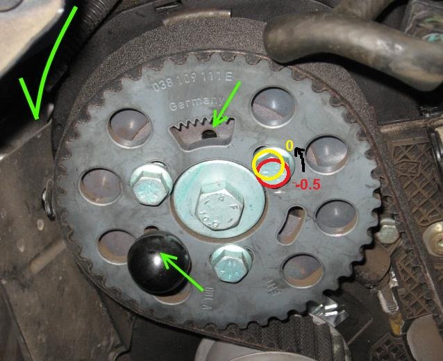

2 minutes ago, J.R. said:
Thanks!
Lower green arrow is over black domed head camshaft alignment locking pin I assume. Yes
Green arrow at left is direction of engine rotation, in my head I thought mine was the other way but it does make sense with the zero and minus markings in yellow and red. Engine direction is clockwise
So what is the purpose of the hole and the teeth at the top marked by the green arrow? 19 years since this engine was launched, 12 years I spent working on them in the dealer network and I have never known or seen it documented
On my car you cant get your head low enough to see the hole without a camera. I use a mirror

Thanks Techie, it all makes sense now.
Convention would be that the engine turns clockwise when viewed from the crank pulley but i did not take that for granted, I pulled the car forward in 5th gear and it did indeed turn clockwise, my memory had not failed me.
The arrow on the diagram is incorrect but were the engine to turn that way then at least the +ve and -ve values would make some sense if they relate to valve timing as it is the units are expressed as kilowatts which just adds another layer of confusion.
Good point re the mirror but it looks like there is nothing to see anyway!!!
This is a post from forum member rotodiesel who seemed to be the font of knowledge for the PD engine, but who unfortunately doesn't post on here any more.
There is no engine driven fuel pump on the AVF engine - it's a PD.
"Mark and pray" cambelt changes will produce this result. The correct crank and cam locking tools must be used in order to preserve camshaft timing. It's also essential to fully understand the principle of tensioning the belt with the 3 camwheel to hub bolts slackened - locked-in torque is prevented by this.
With the correct tools and procedure, the timing (KW = kurbel winkel) or crank angle, will be almost spot on, and can be checked with VAGCOM or similar.
I have changed many of these belts, and every one has been within the permitted KW tolerance by using the VAG lock tools and observing the correct procedure.
These engines are not for monkeys to work on.
rotodiesel.

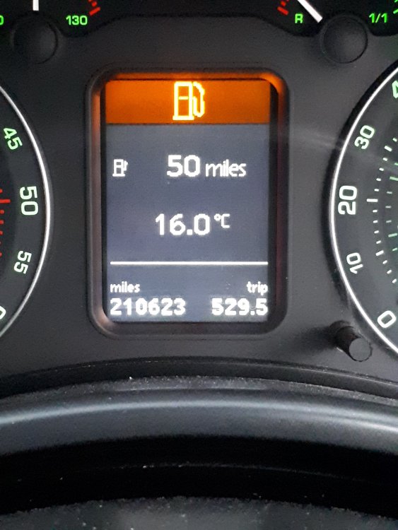

So a ran the car until the light came on and a got 545.1miles and 50miles left on the MFD.
So a kept on driving and taking a chance but a couldn't take the chance anymore and a got 556.3miles with 30miles on the MFD.
The MFD was displaying 36.1 MPG.
So what am asking is what does people think ?.
MFD needs recalibrated.
The torsion value needs adjusting.
Or just leave it alone and drive it and forget about it.
Cheers

You have missed the crucial piece of information, how much fuel did you put in to refill the tank to the brim and was it brimmed on the previous refill, only with that will we be able to calculate your MPG and advise the fuel computer correction factor to be used with VCDS.
I reckon you actually had a further 50 miles after the range would have read zero which would make your consumption around 53mpg, as a taxi driver I would actually expect more but I dont know what your journeys are like.
When you say 36mpg on the MFD you are pressing the button to give the overall figure since the last reset/100 hours of driving arent you and not just the mpg of the current journey?
Assuming you are then scroll down and advise how many miles are recorded for the average consumption.
Sounds like you need to do a correction in VCDS but I think its limited to +/- 15%, mine was 13% out. You will need the accurate fuel consumption and for that you need to know exactly how much fuel it took to refill the vehicle, anything else includinga asking other peoples advice is a waste of everybodys time.

A have only brimmed the tank once to see how many miles a would get out of a full tank.
When a brimmed it the light was on so a don't no how much fuel was in before.
As the MFD was on number 2 a think that's the over all MPG not on the individual journey as on number 1.
A put 53.19 litres in @ 130.9 litre which was £69.63 that was to brim it from when the light came on if that helps.
Number 2 is the overall mpg.
As you have brimmed the tank last time and hopefully zero'd the trip meteror recorded the mileage you just need to do the same next time after running the tank as low as you feel comfortable taking care to brim it in the same manner and then you will have a definitive mpg figure and we can advise you of the correction value for VCDS.

A na but that's the way we talk lol so a need to fill tank again and take it from there.
What i do is reset the trip 2 on mfd when i refuel brim to brim. That way i have the distance and indicated mpg for every tankful i use,and avg speed etc, which all helps better understand my driving habits.
But anyhoo, from posts above you did 556miles on 53.19litres.
Thats 10.45mls /litre  or... 47.5mpg.
Ballpark. Your mfd is off, but it also depends on when that trip 2 was reset last.
