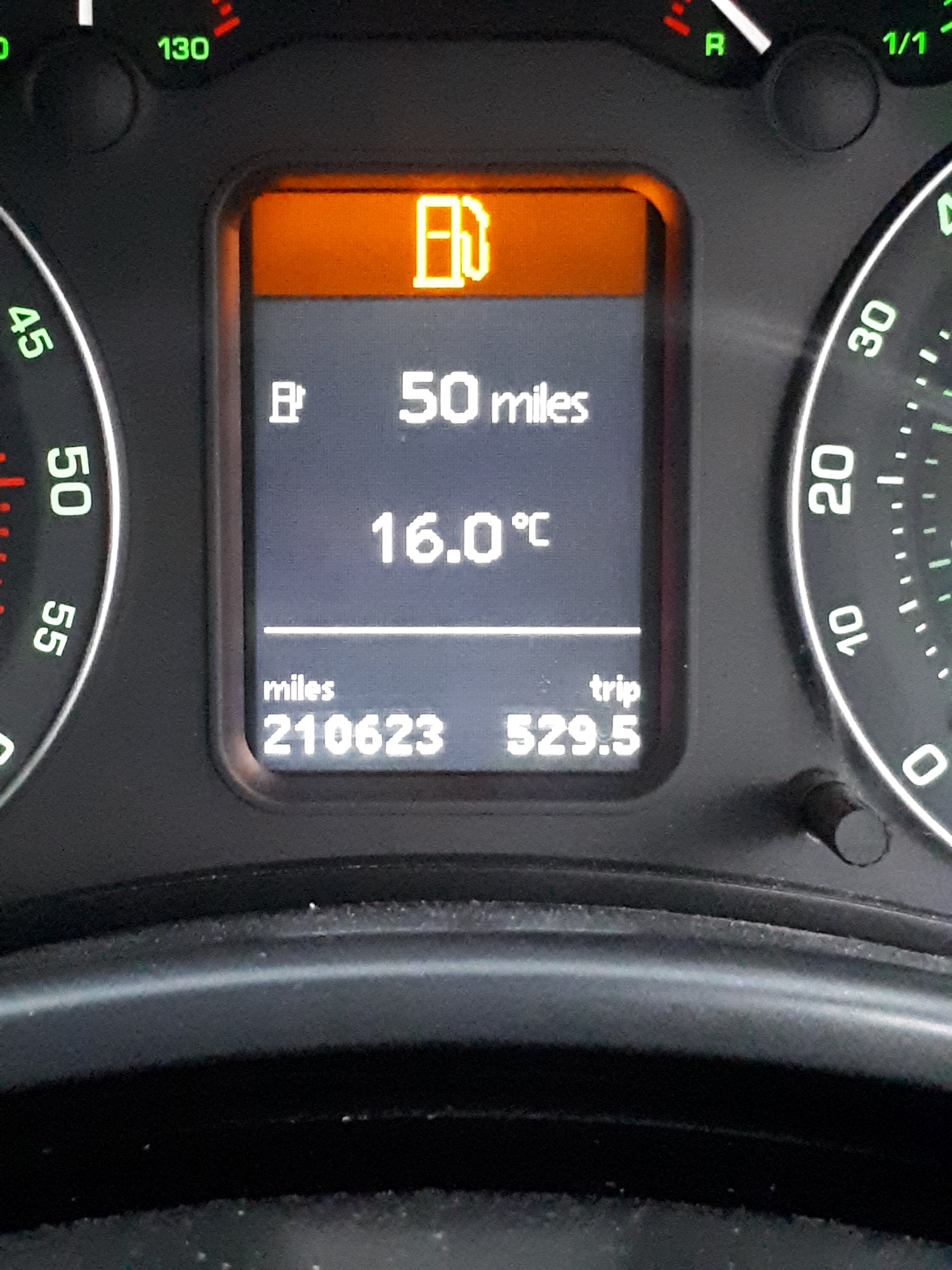

Well me light come on at 546.9miles.
Number 2 is saying 39.2mpg.
Number 1 is saying 38.7mpg on the MFD.
On the MFD it said a had 25 miles left to go.
A put 49.91 litres in to brim to get the 546.9 miles
So to brim it again a put 53.89 litres in see how many miles a get this time.
So a think a have worked it out a was getting 51.5mpg  which a don't think that's right

So just an update 're brimmed the tank it took another 53.19 litres.
on the trip meter a done 546.6 miles and on the MFD display said a had 25 miles left to go.
The fuel light came on at 527.7 miles.
The MFD display was displaying 38.5 on trip 2.
Well that calculates as 46.7mpg..

So this is what the dash says just another update.
