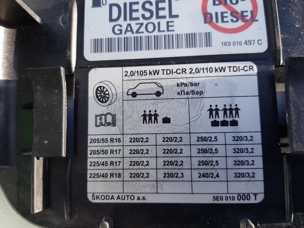

Anyway, getting back to your original question. That chart shows the front and rear cold pressures for whatever size tyres you have and dependant upon the number of people & luggage. Use the bar settings (2.2 etc) as all tyre gauges will show that.

The data plate in the OP says that anything between 32 and 36 psi is fine for the front tyres and 32 to 46 psi at the back, depending on loading. As far as I remember, mine also recommends 36 psi as being more economical.
