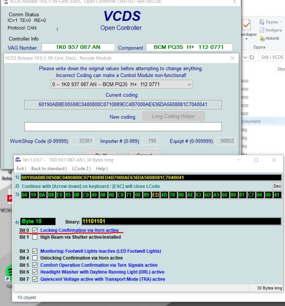

Obviously i manage to **** up my car totally with a Chinese counterfeit Ross-tech HEX-V2 usb interface.
I was trying to activate  bit 0 "Locking Confirmation via Horn active" under byte 15 for the 09-Cent. Elect.
Picture taken right before pressing "Do it"
Got message "Code accepted".
This resulted in a loss of Fotwell Lights, DRL-lights, Parking-lights, Fog-lights, some fault codes and probably something else.
I now realized that the entire longcode for the module had changed completely from what it was before i activated bit 0 under byte 15.
It had changed to:
190AB8E00508C0400800C0710089ED4B7000AE636DA5608081C704004100 ,the old code were:
60190AB8E00508C0400800C0710089ED4B7000AE636DA5608081C7040041 (before activating bit 0)

You changed byte 18...
Given the original value was 00 you either need a dealer or knowledgeable VCP/Odis user to sort out your light configuration.
You might be able to find something that's close if you Google for the code list.
I had assumed that selecting one of the options (in this example bit 0 ) was a safe option.
also as this is labelled bit zero how did it result in a change to byte 18..I feel I am missing something obvious re bits and bytes?
The whole long coding got shifted one byte to the right.
