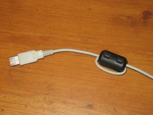

Did you fit a ferrite core on the wire for the dashcam? They normally come in the hard wire kit and are designed to minimise interference.
They look like this and fit this way, with the cable looped through. Ideally as close to the dash cam end as possible iirc.
No I hadn't previously, but I ordered some from amazon (3mm core) as I saw this as a possible solution, I fitted one each end and bingo! I now have perfect DAB and FM reception. Thanks for the suggestions and advice, finally can listen to radio again without constantly changing channels!

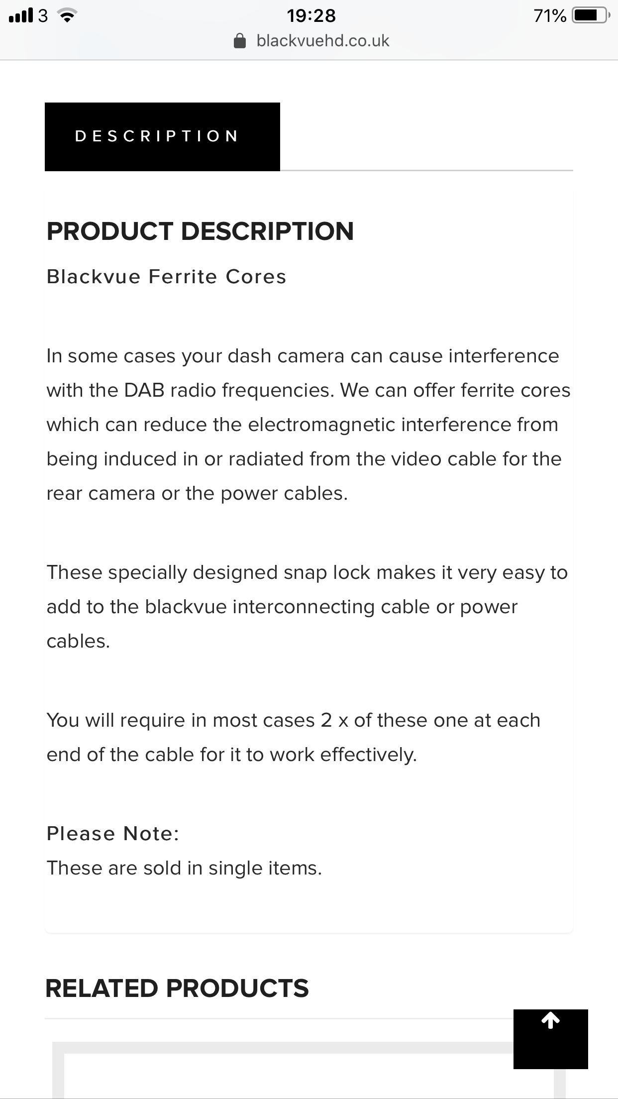

I thought you fitted one at each end rather than just the dash cam end of the cable?
The nextbase hardwire kit only comes with one, so unless you buy an extra one its all you'll have. From doing some quick reading, it seems to depend if there is a device at both ends of the cable to protect. In the dash cams case, one fitted closest to the device should be all that is needed to cut interference... but having one at both ends isn't going to cause a problem.

I was just going on what Blackvue recommend on their website. They sell them as single units but recommend using two per camera.
Interesting, and also... WOW they're expensive from BlackVue, making out a reduction from £9.99 to £8.99 is a bargain when you can get 10 of a similar size cable for little over a fiver on amazon delivered. The entire hardwire kit that came with a ferrite core was only £14 ish.
