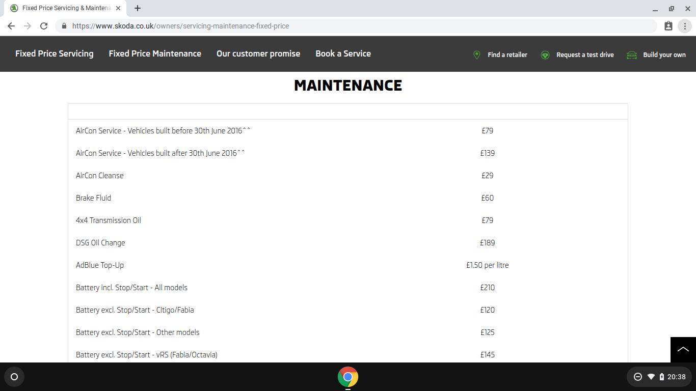

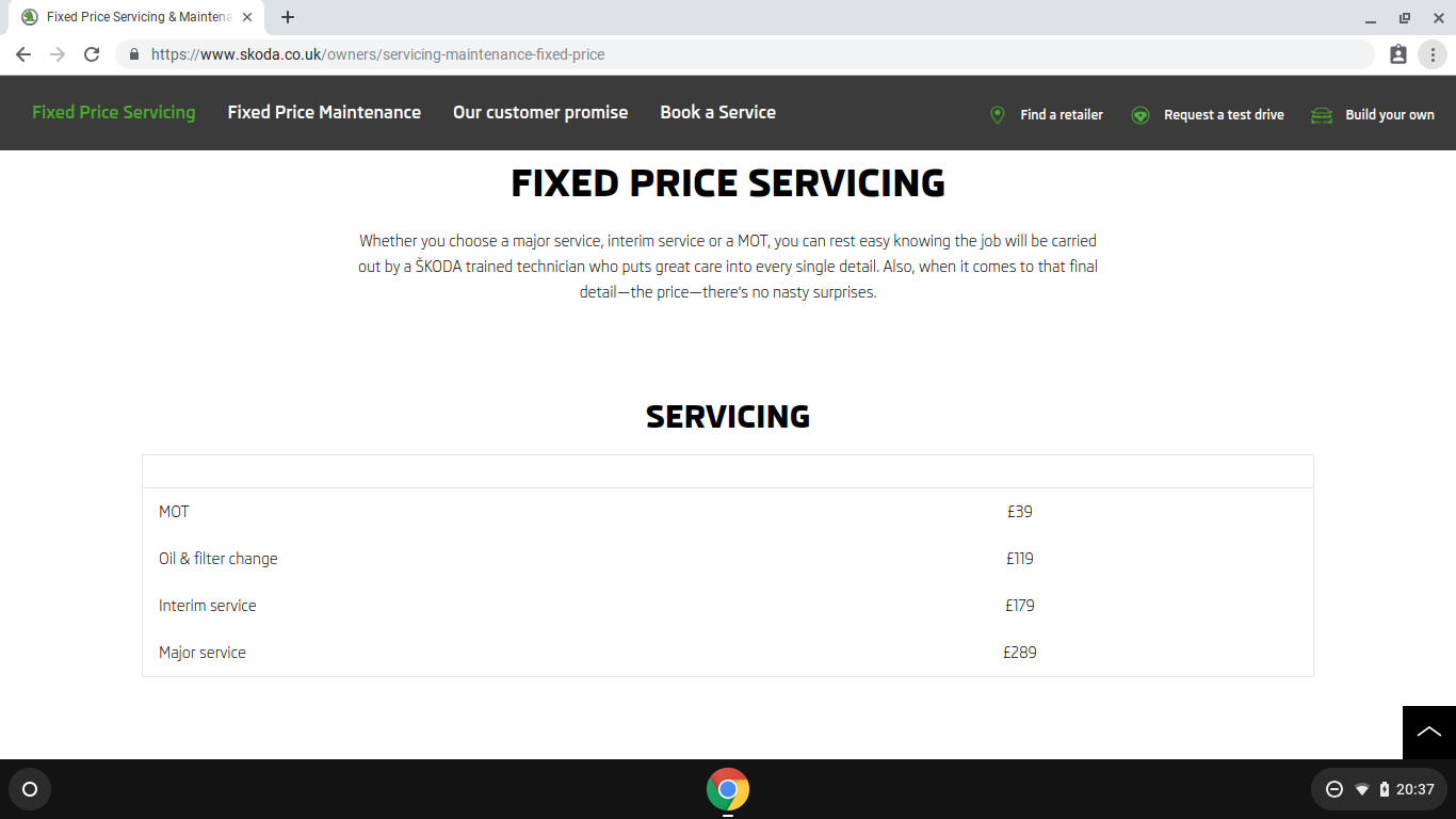

*******The DSG Service Interval is @ 40,000 miles, so you are over that.*******  £189
If you are paying for a Major Service, tell them you want the Air Filter and Fuel Filter changed, & you are not paying to have stuff not done.
Was the Brake Fluid changed last year? That is another £60.

Its booked in for a Major Service and they will provide a Print Out of the Service which does have the independent VAG Specialists on there, so all good  on that point.
£289 lighter but, such is life :)

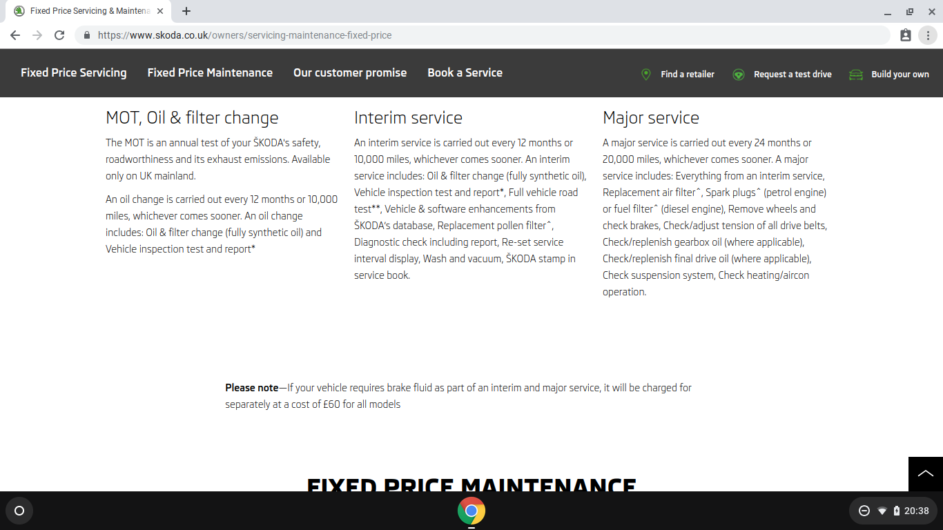

Sorry @Zenbasses, I missed this one. A couple of alarm bells are ringing. If your car is on variable, the time limit is two years, not one. So you shouldn't be seeing a message. That makes me suspicious that they have put it onto fixed, as @Roottootemoot suggested. Worth checking out when you take it in.

It is never going to be 20,000 miles with it on Variable. More likely 18,500 and that will not be dropping in miles, just 24 months or 18,500 likely if the Service Indicator is set correctly on Variable and no Inspection Interval still after 9,400 miles / 372 days. (One year and one week.)

In the UK, if correctly programmed, variable interval is set to 18,600 miles (30,000km) max and 744 days (2years, 2 weeks) max. If your driving habits,excessive cold starts,short distances, and a hundred other variables worry the ECU, it can dial down those figures to as little as 9300miles/1 year.

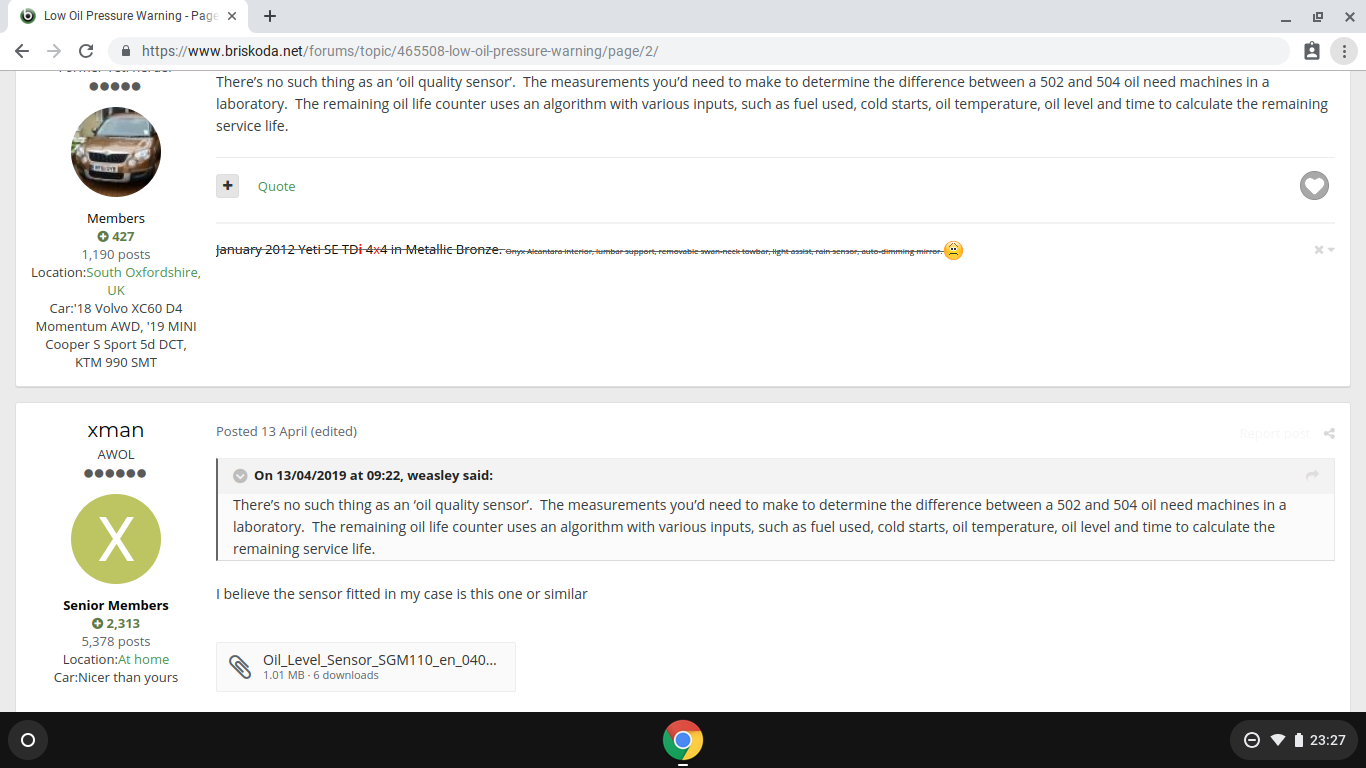

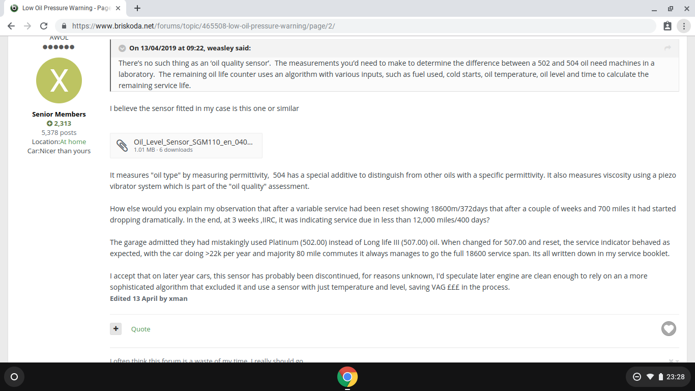

Yes, I have! Our 61 plate Octavia 1.2tsi (cam chain), it was filled with Platinum (502) instead of Longlife III by cunning Skoda staff, within 2 weeks and less than 1000 miles driving the indictor had rattled down from 18,600 to 13,000 miles and dropped daily by many times the driven distance.
Car normally went to between 17,000-18,600 miles between service indicator calling for service.
Returned the car for the usual tiresome *******ing of the service staff (one of which got fired shortly afterwards), new proper oil and filter and normal variable service was resumed.
Strong evidence for the oil quality sensor in this car detecting non 504 oil
But I know what you're getting at, with the release of EA211 and EA888 gen 3 engines, maybe the diesels too, they seem to have reverted to fixed or variable but really fixed twice as long regimes and no expensive oil quality sensor.
Perhaps they should change the name to Private owner/Fleet or arkward owner service regime.
It makes no difference to me what you believe, the wrong oil and what happened with the service indicator set to variable/ QG1, I witnessed with my own eyes, and monitored over 2 weeks. Garage when confronted, admitted they used the wrong oil.
