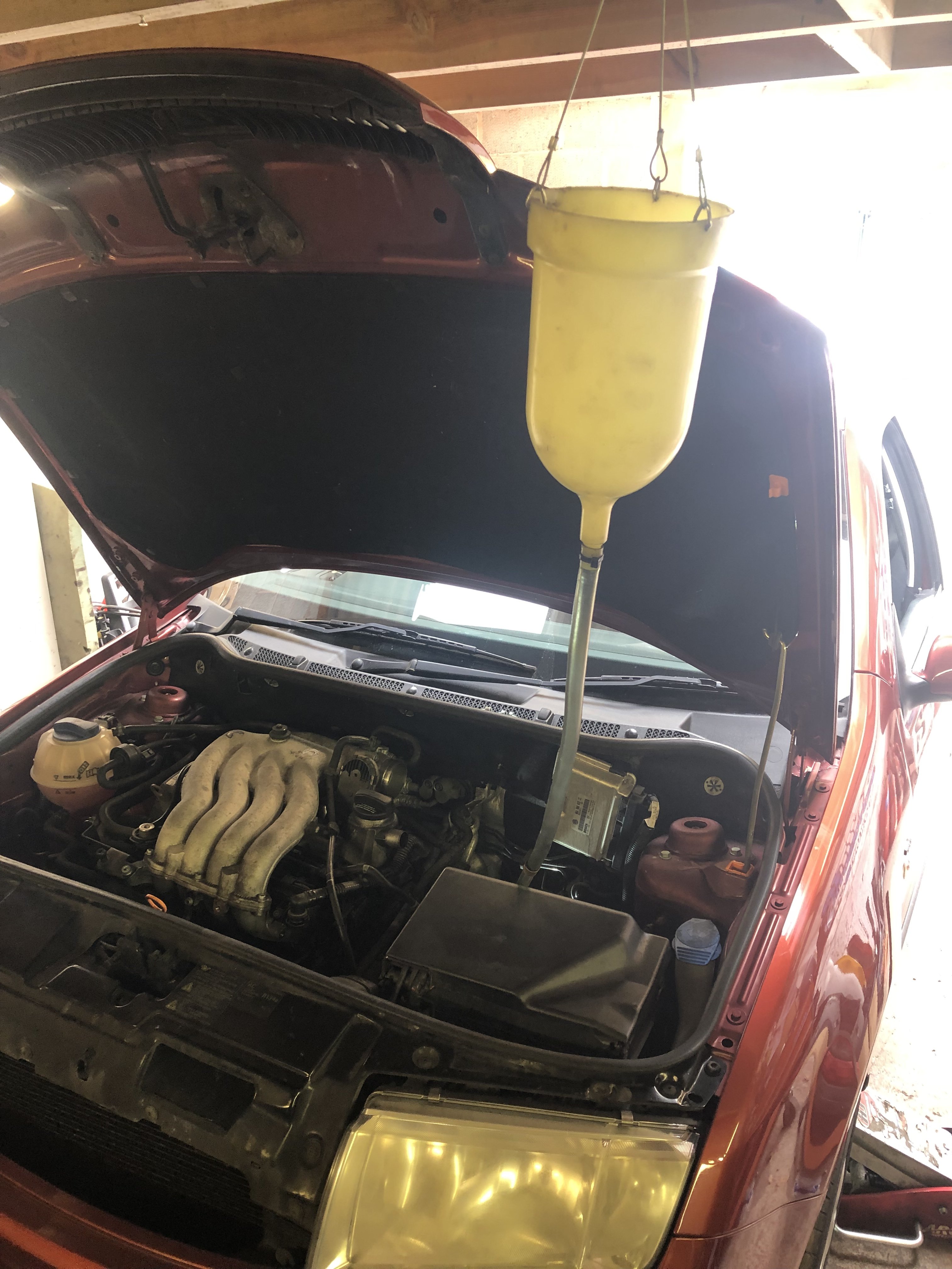

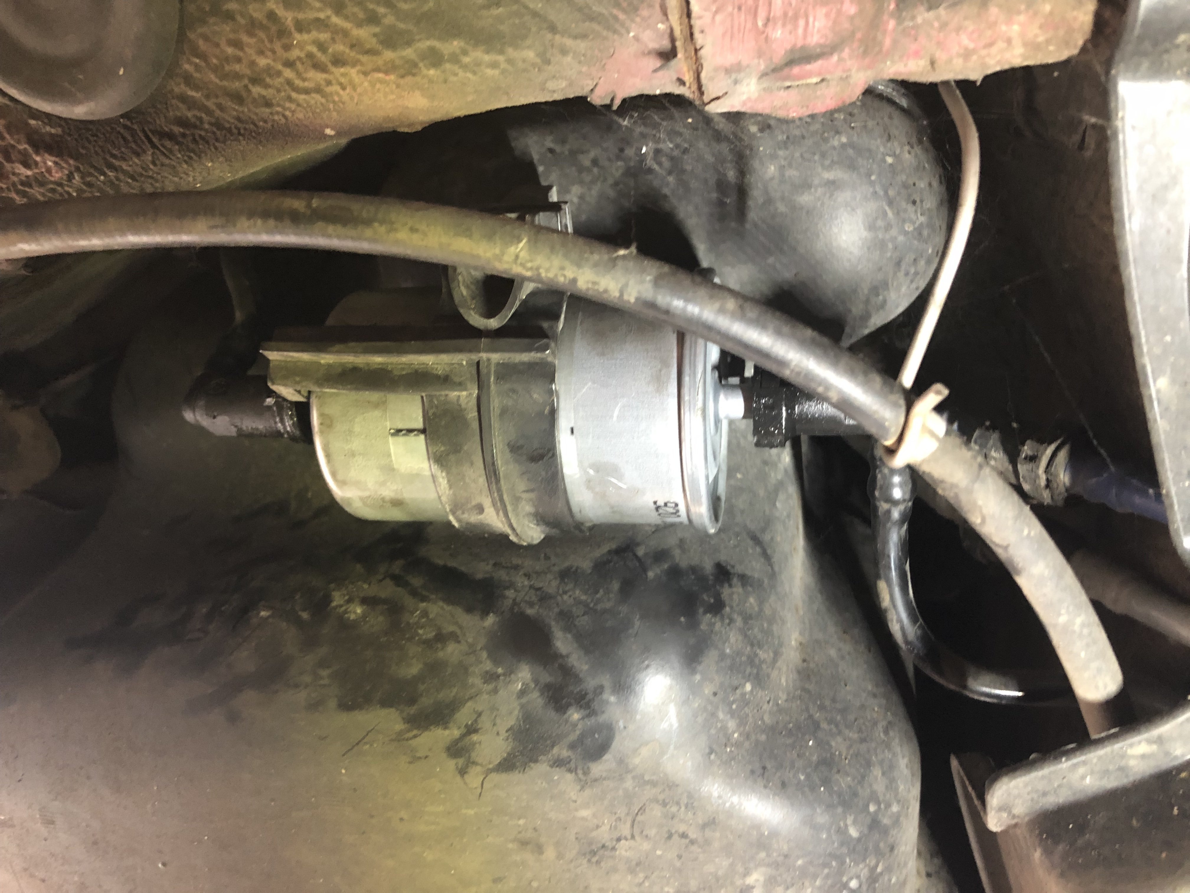

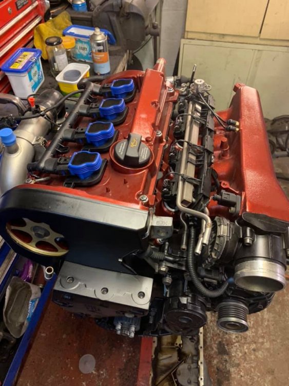

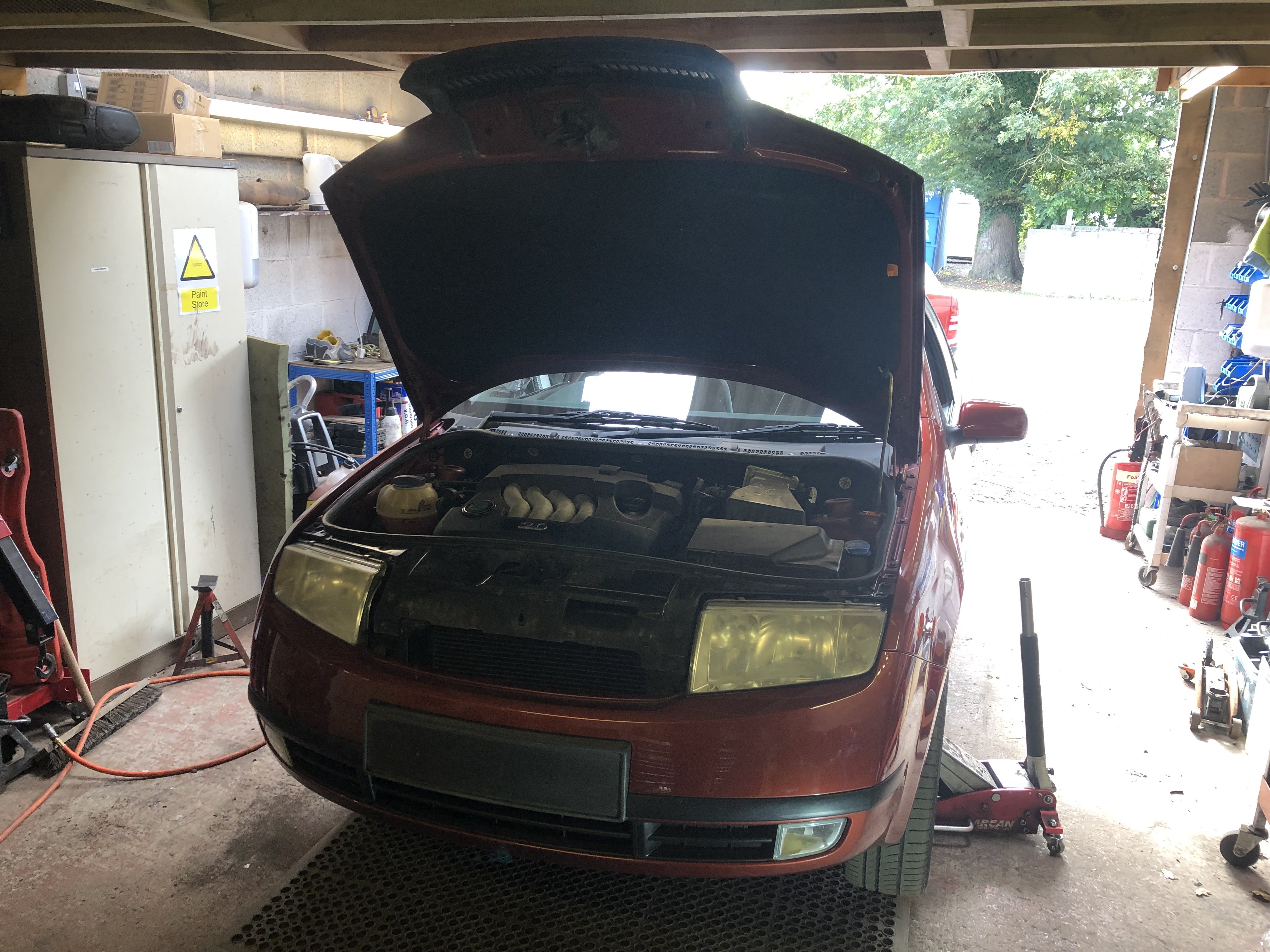

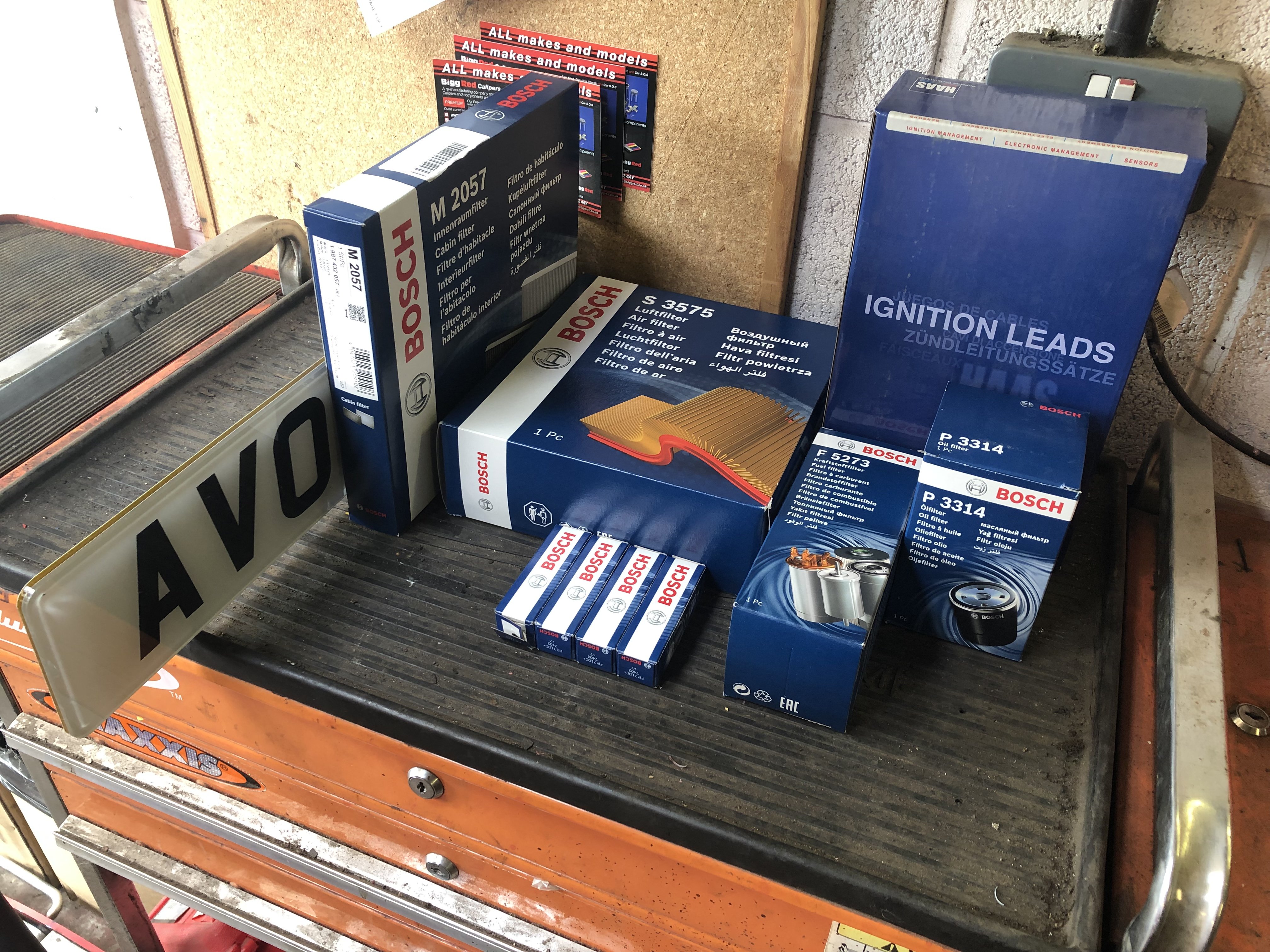

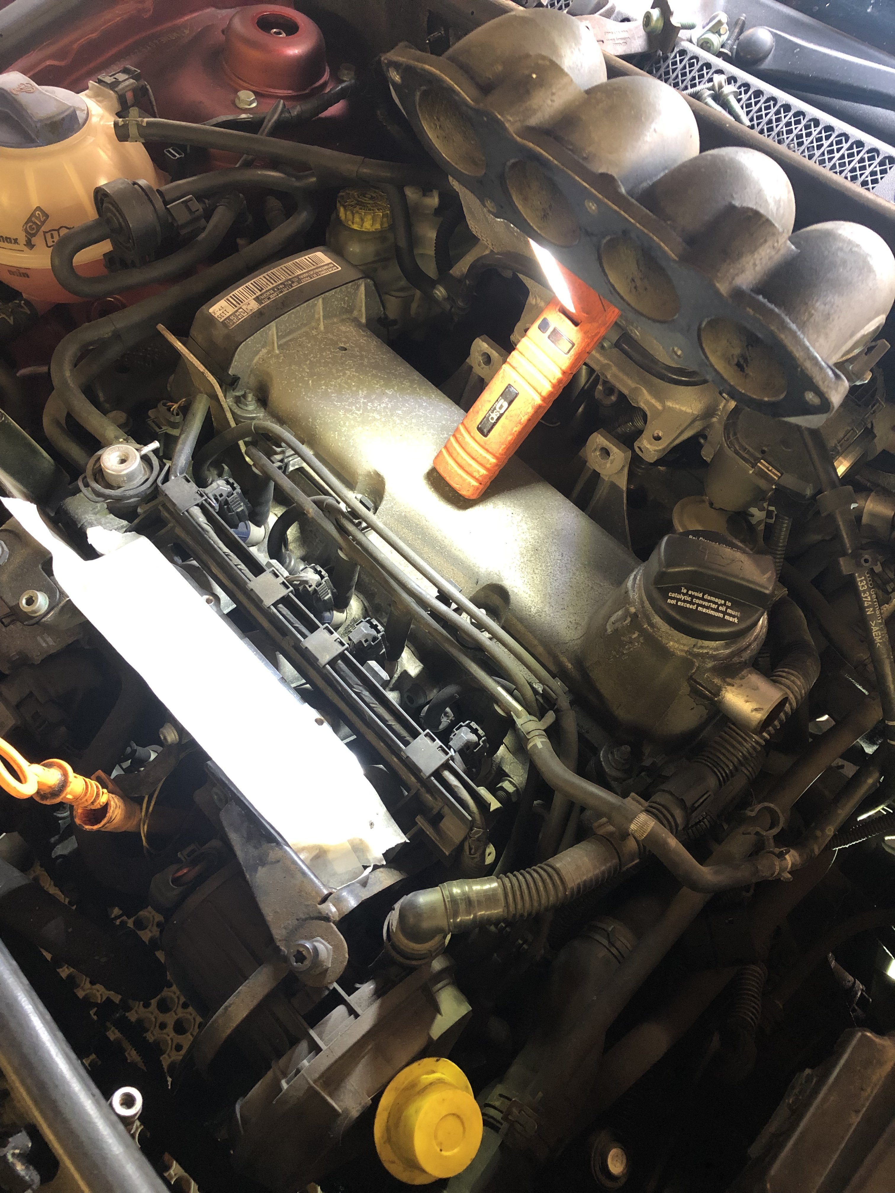

Decided to give it a thorough service and check over today.
Full service inc:
Engine oil
Engine oil filter
Air filter
Fuel filter
Spark plugs
HT leads
Gearbox oil

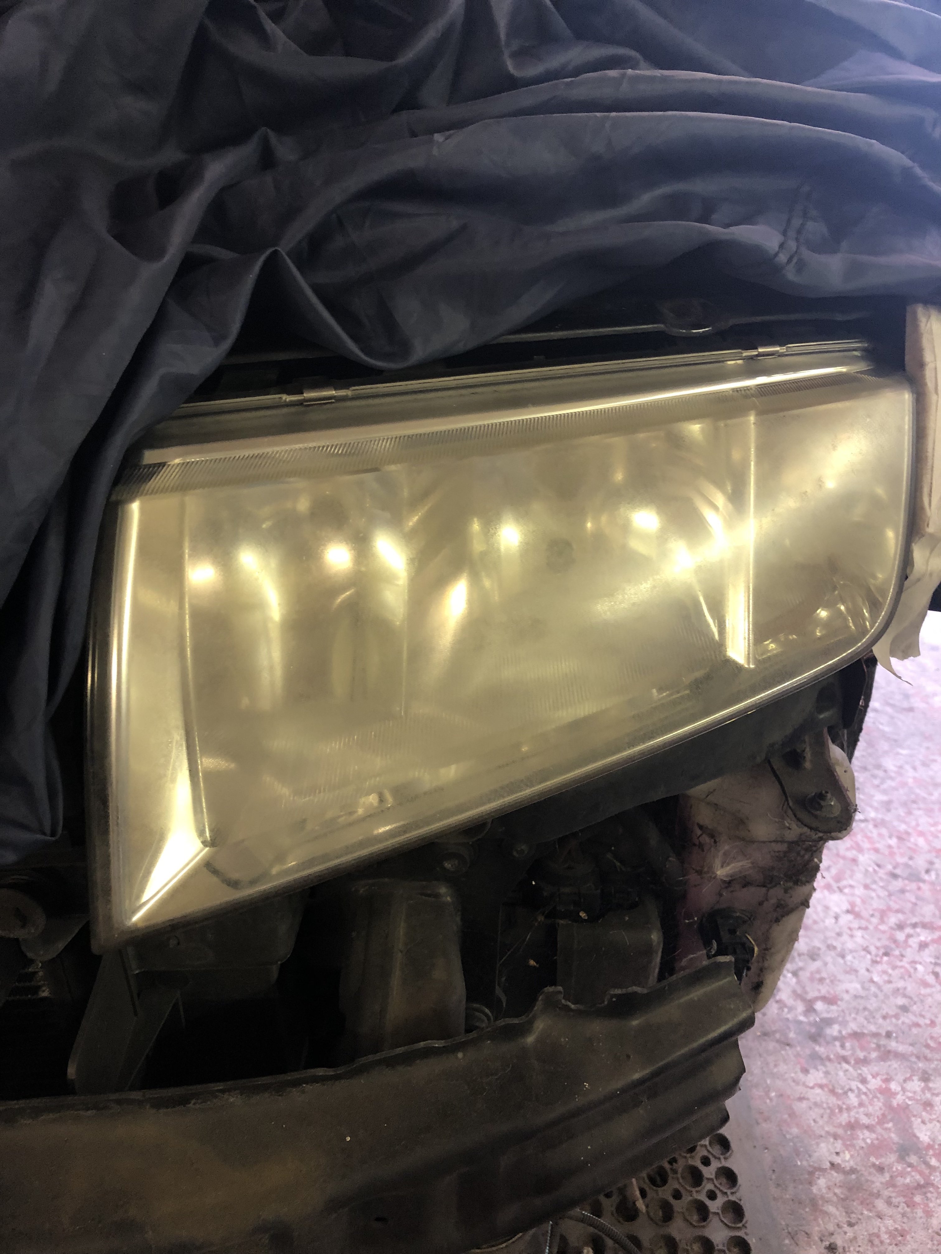

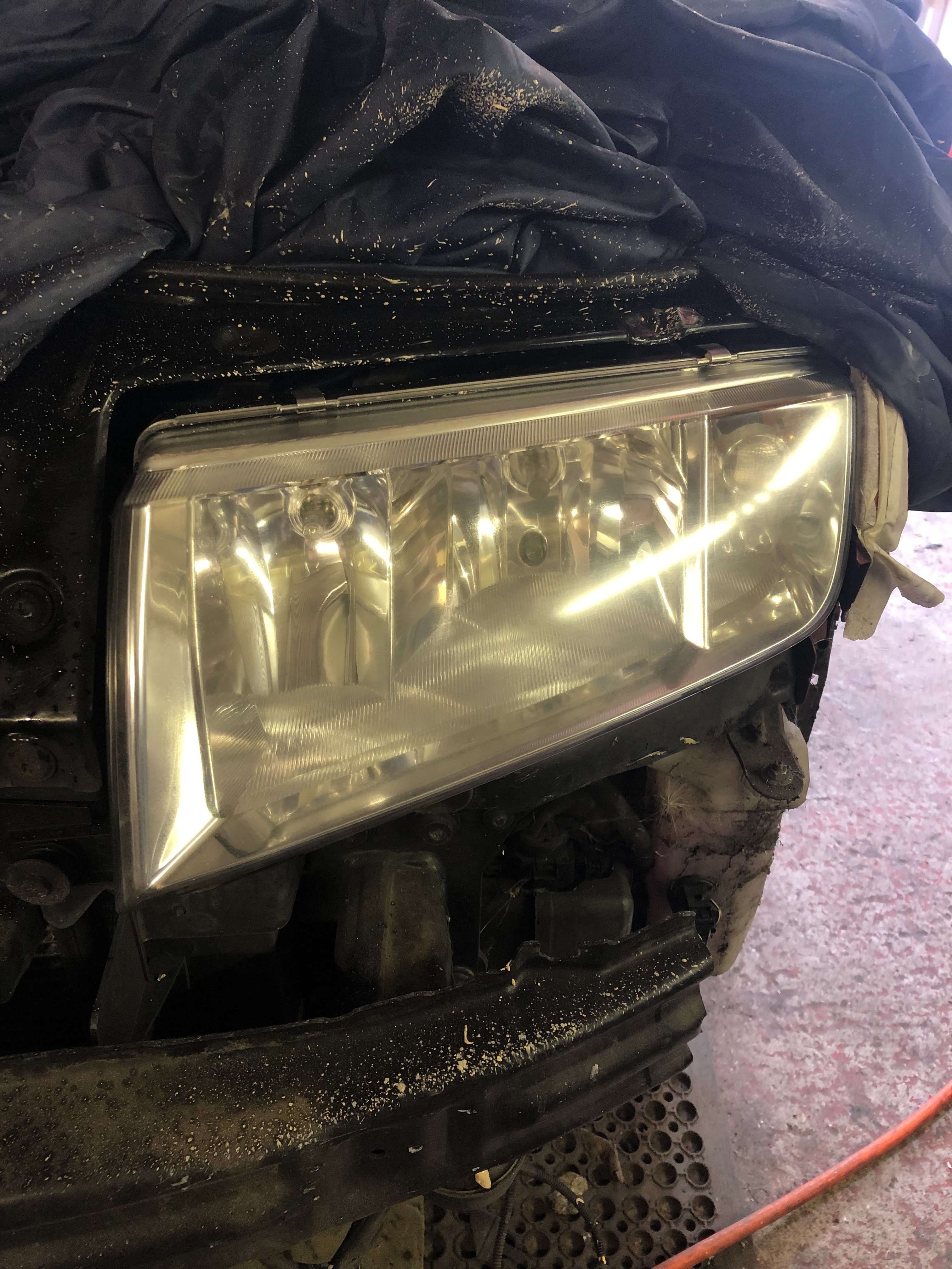

And I wanted to have a crack at polishing the headlights as they were quite opaque.

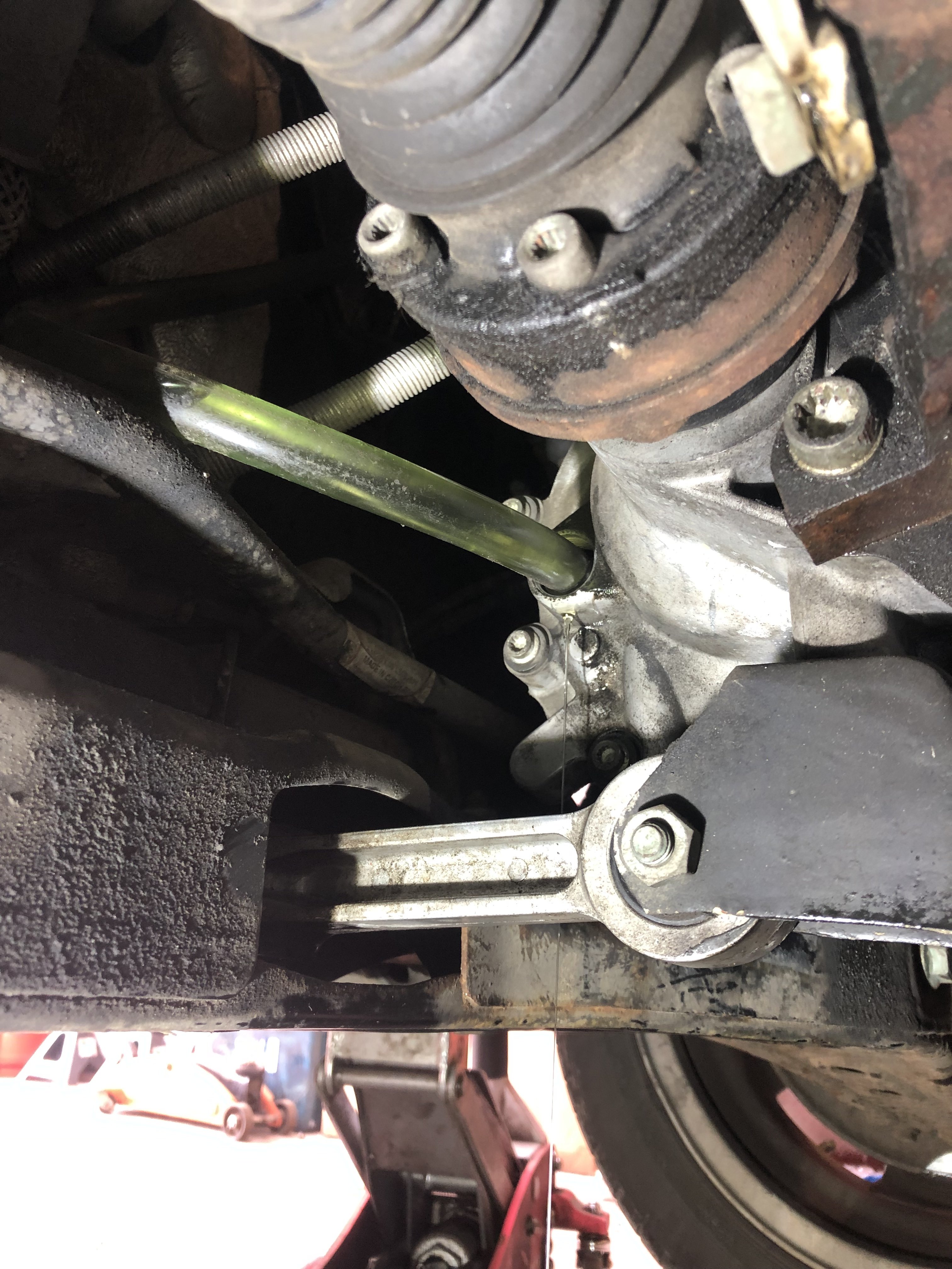

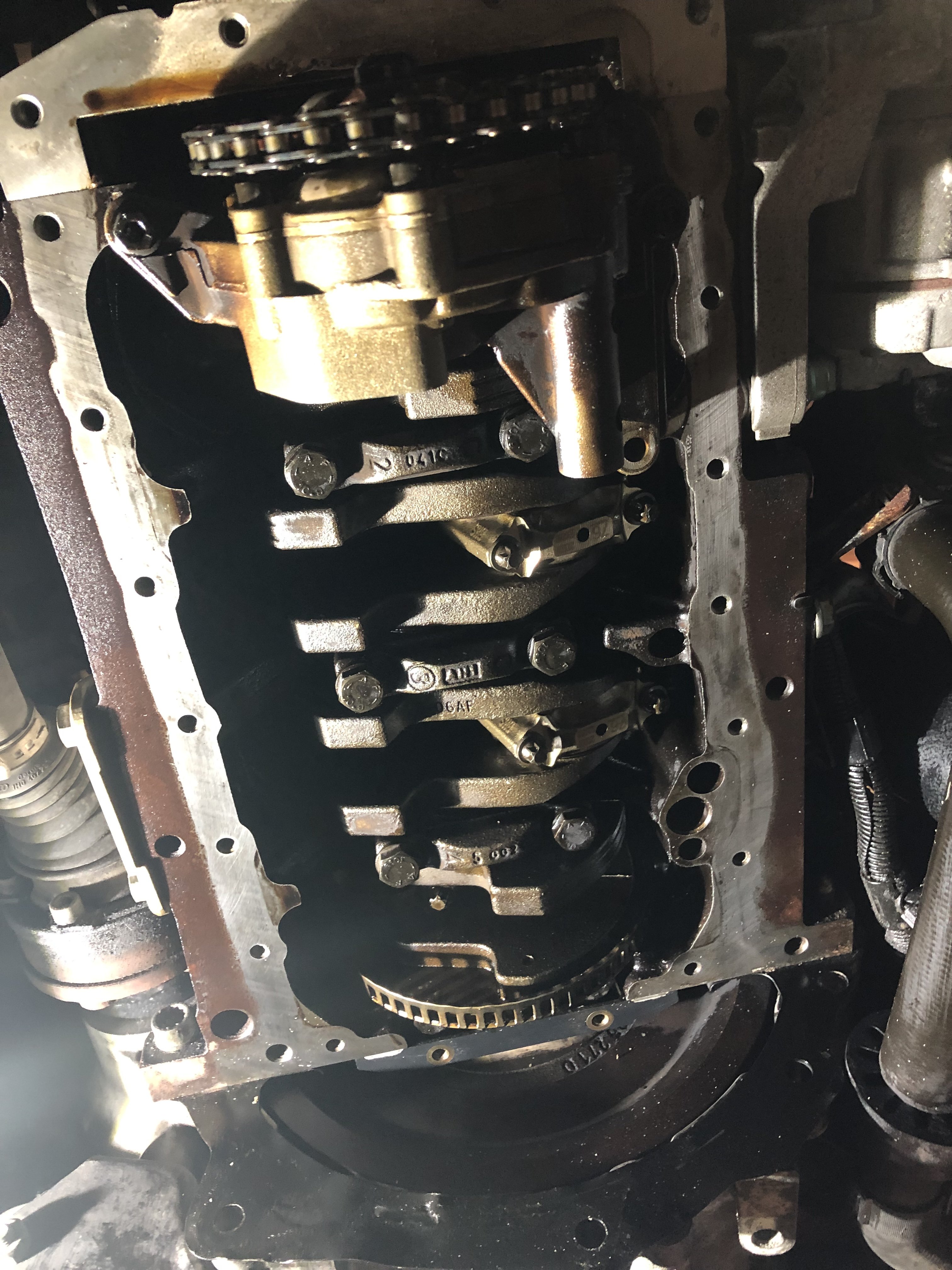

Went wrong almost at the start when the sump plug pulled the thread out of the sump, sigh. Still I had half a mind to drop the sump anyway to check the oil pick up pipe so at least that’s checked off the list now. Fuel filter was the original and some 17 years old, certainly didn’t want to come off, but got there in the end.

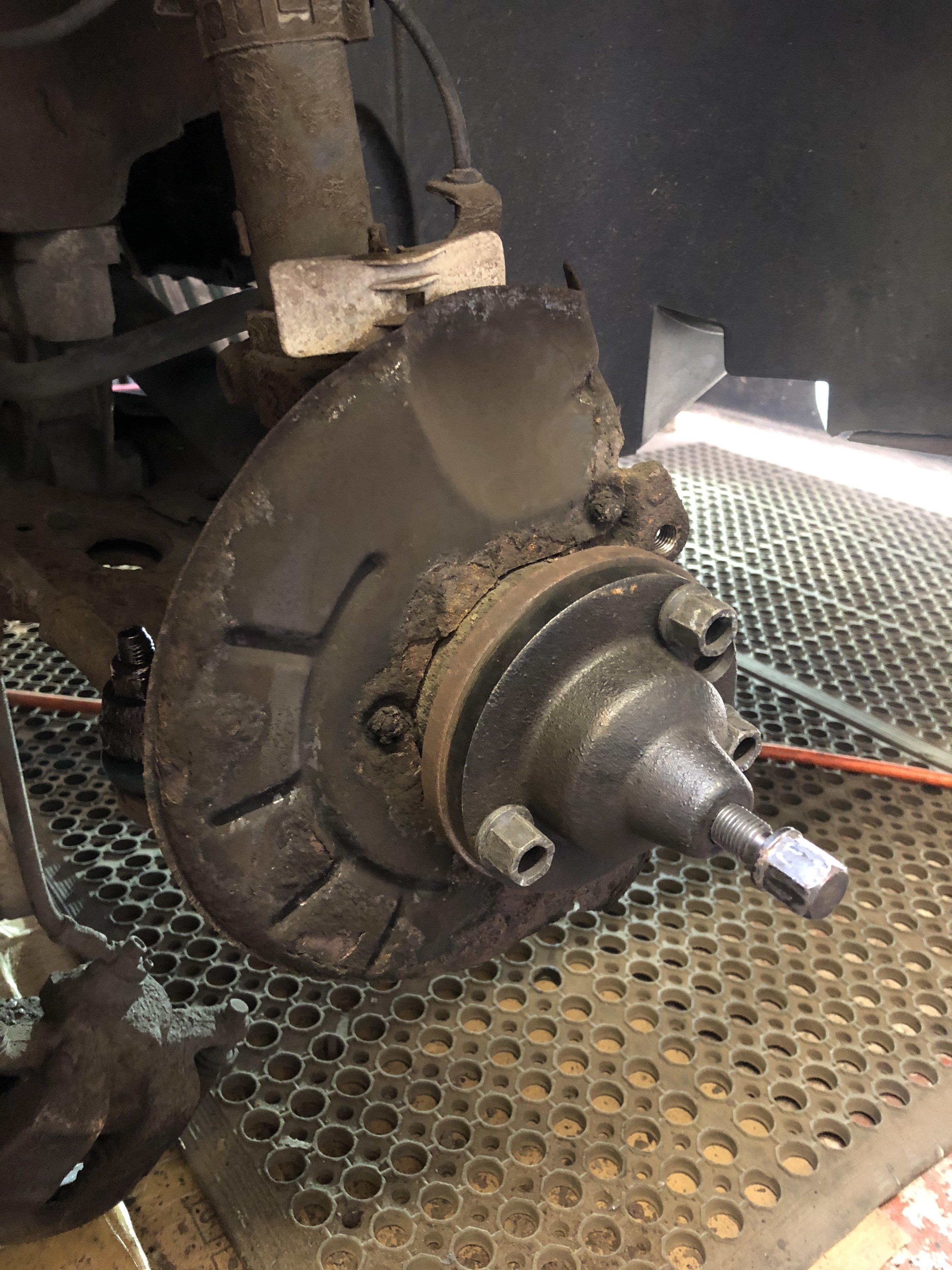

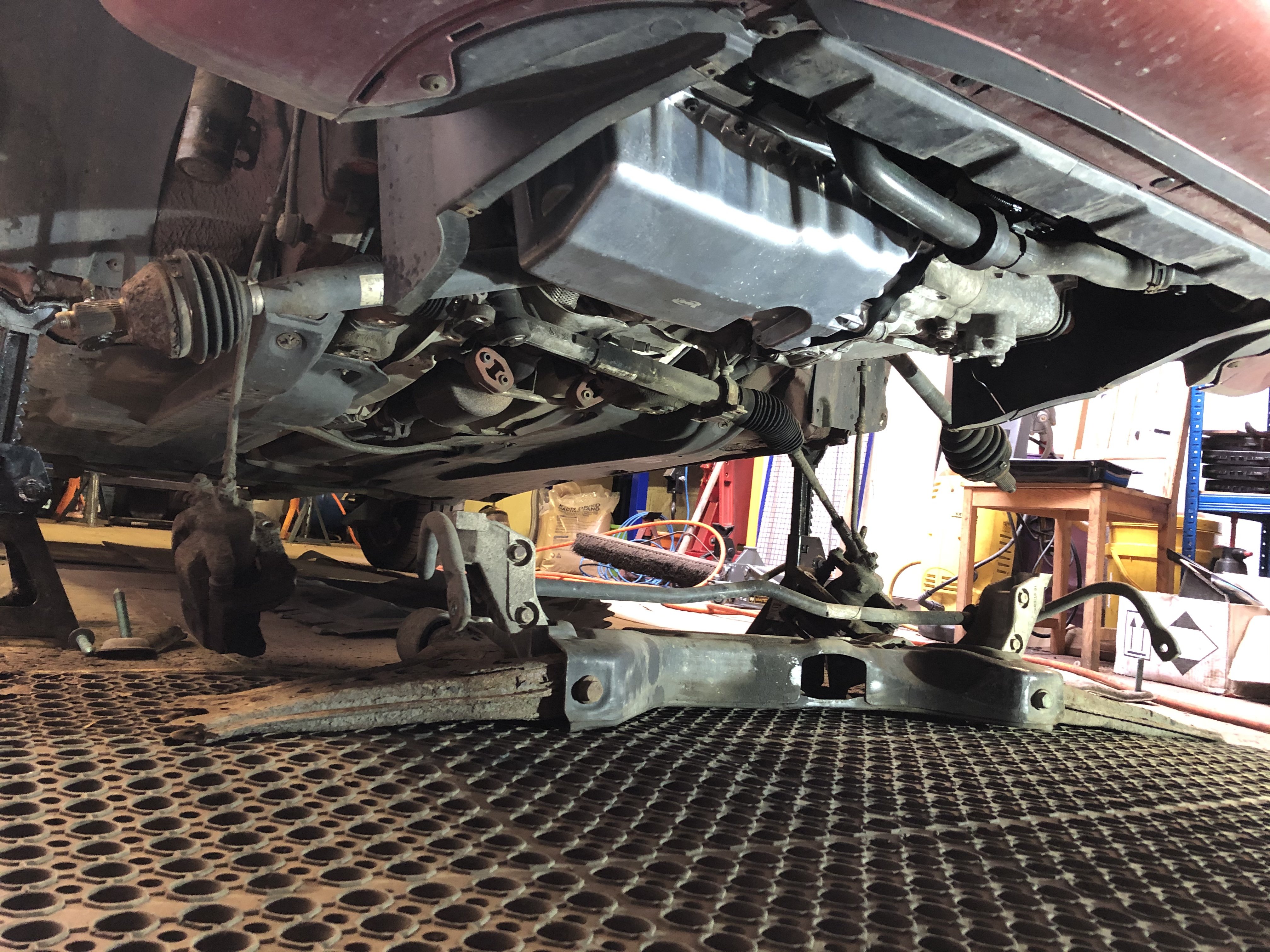

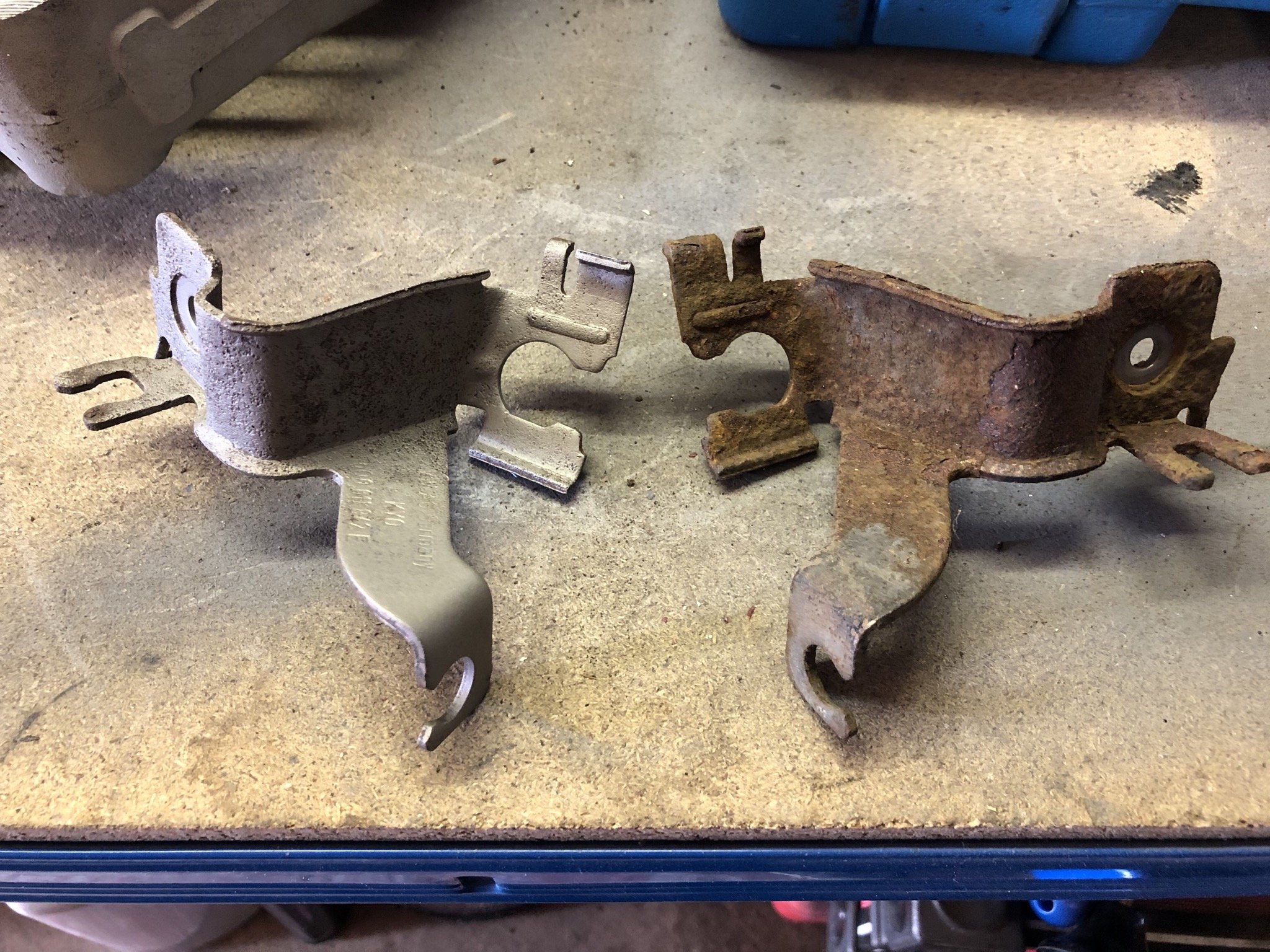

Some new stoppers for upfront on the Fabia. 😎

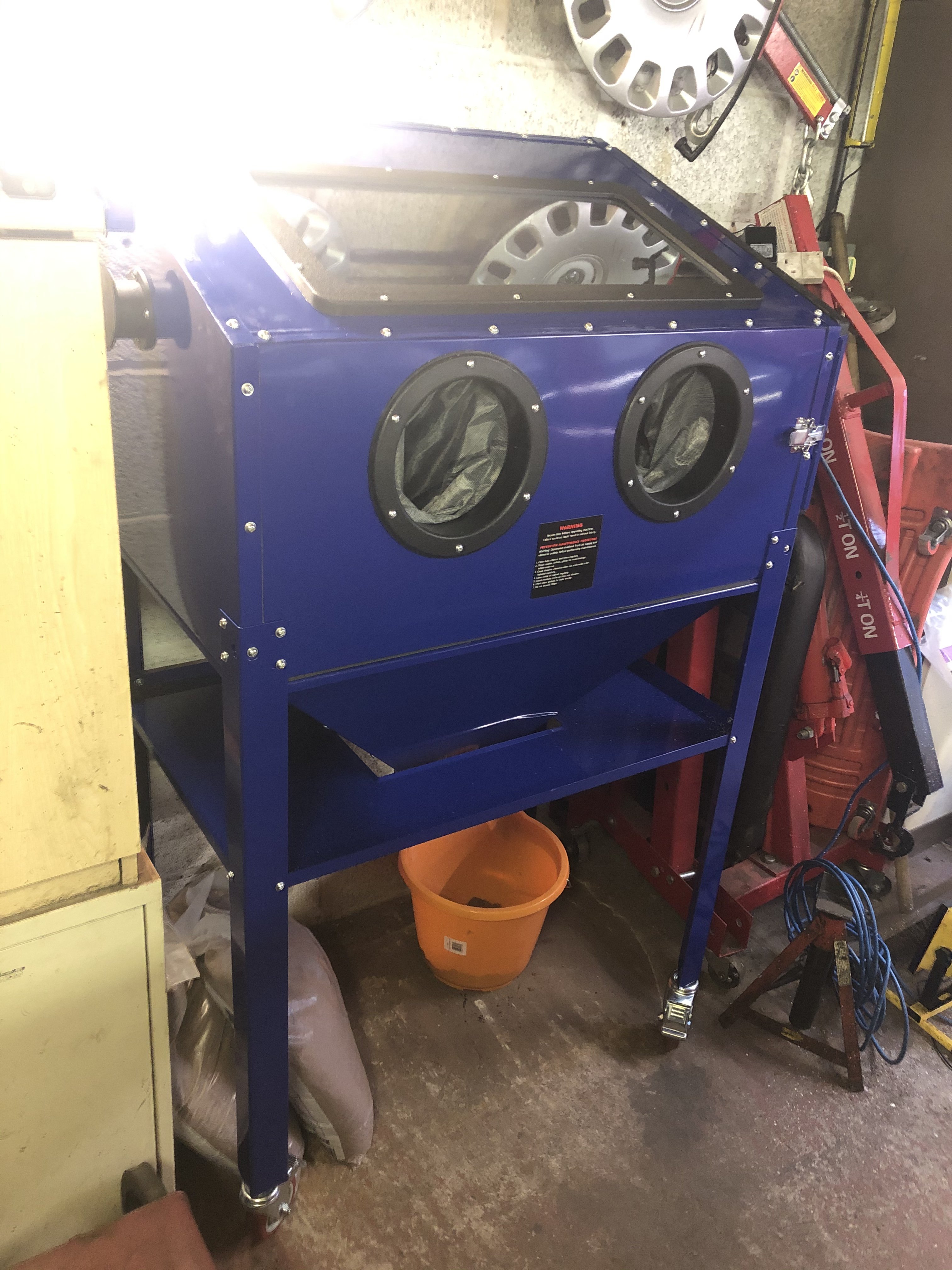

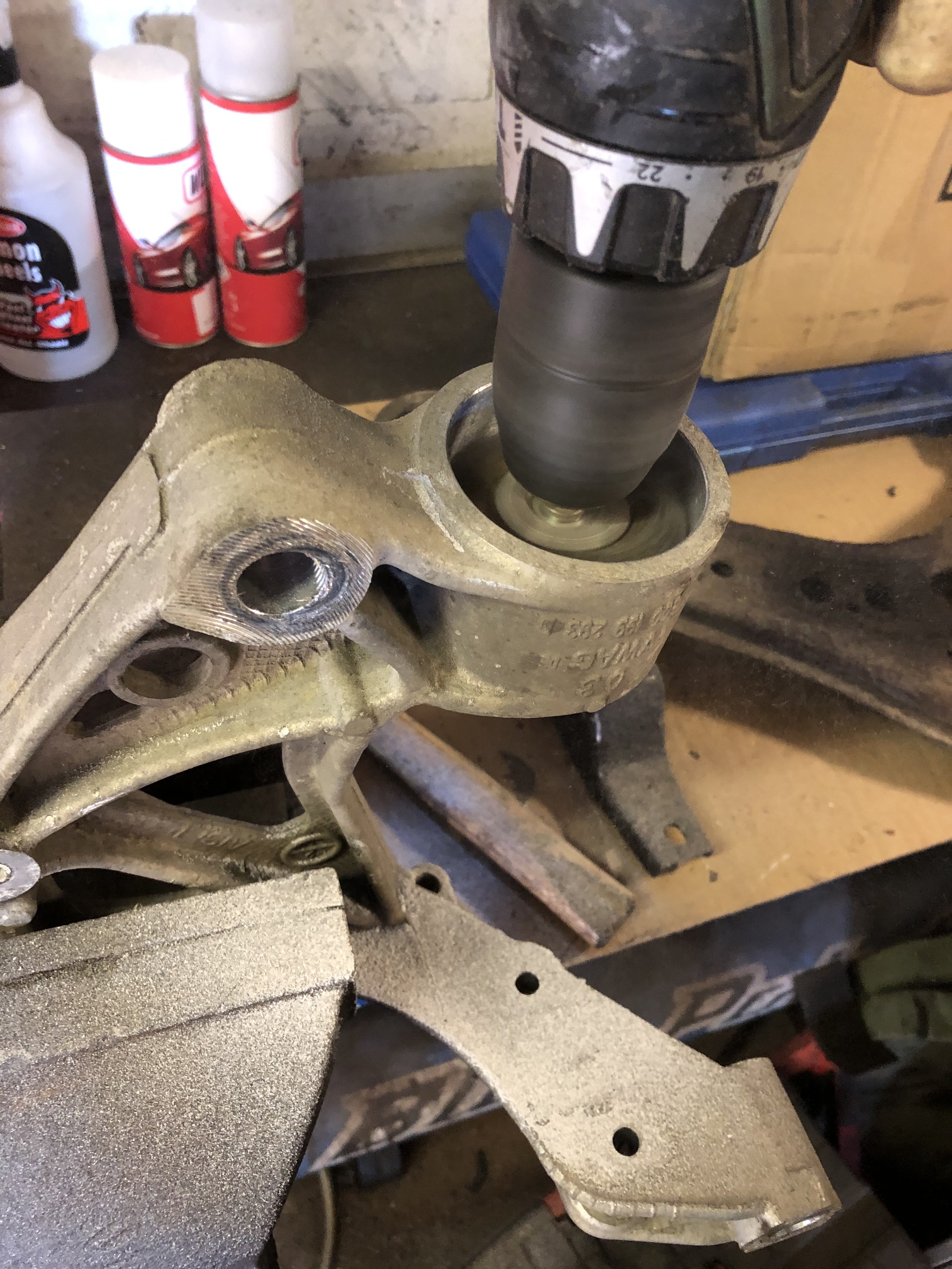

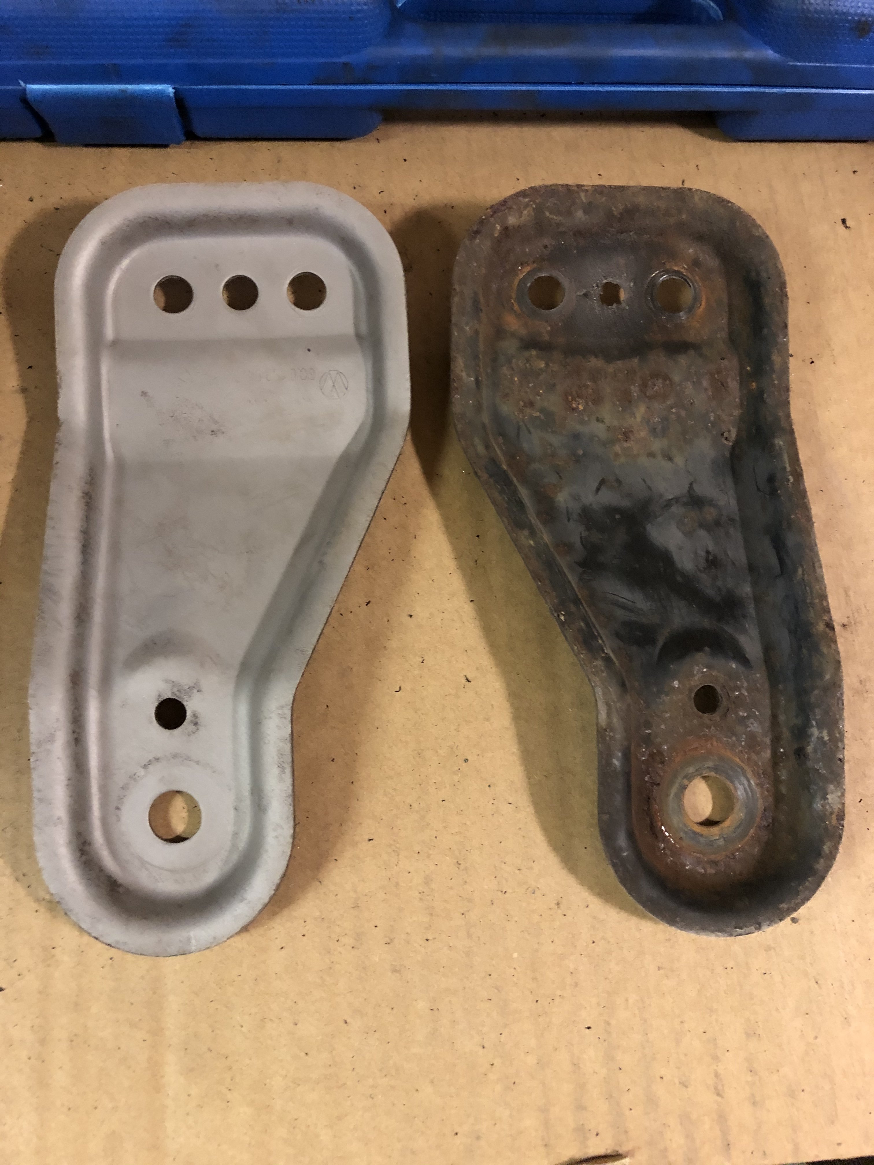

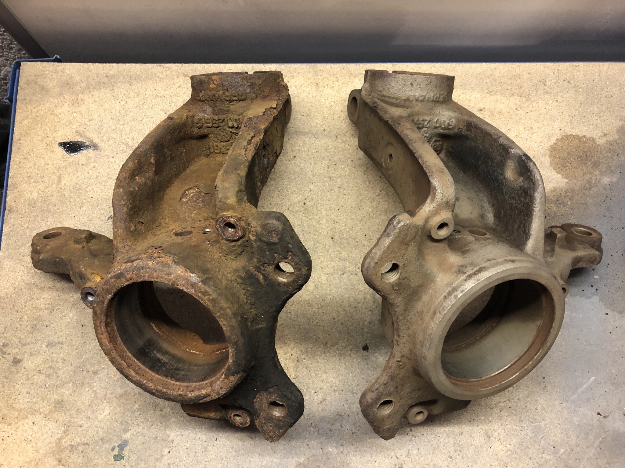

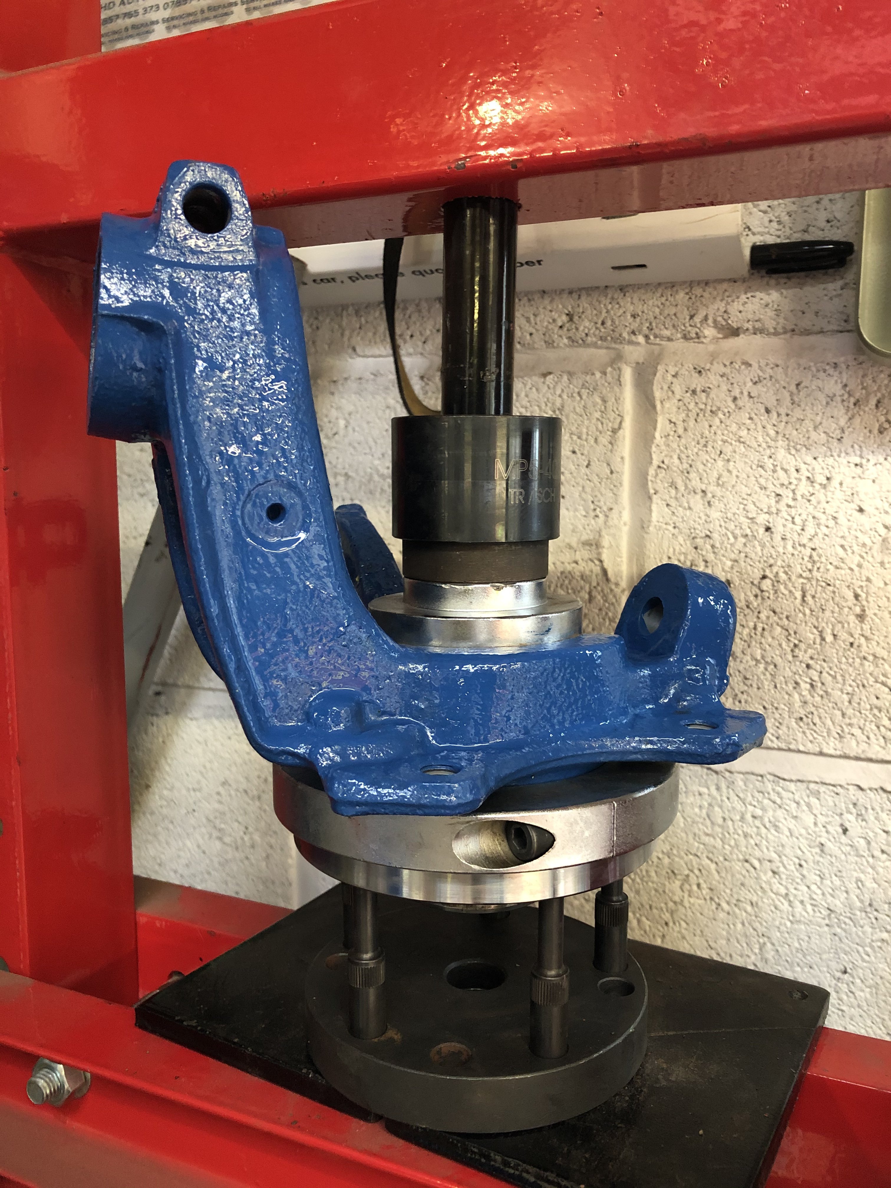

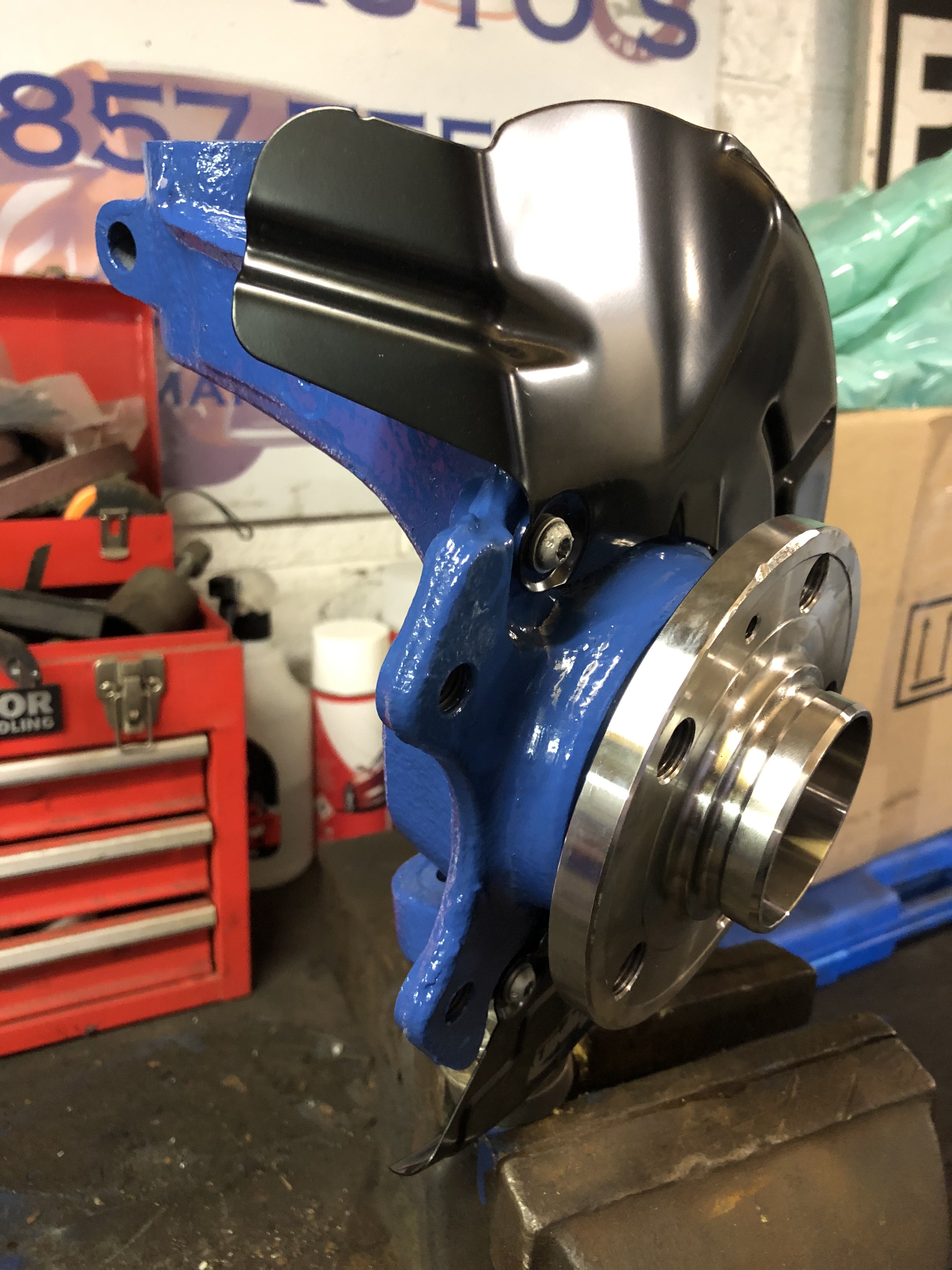

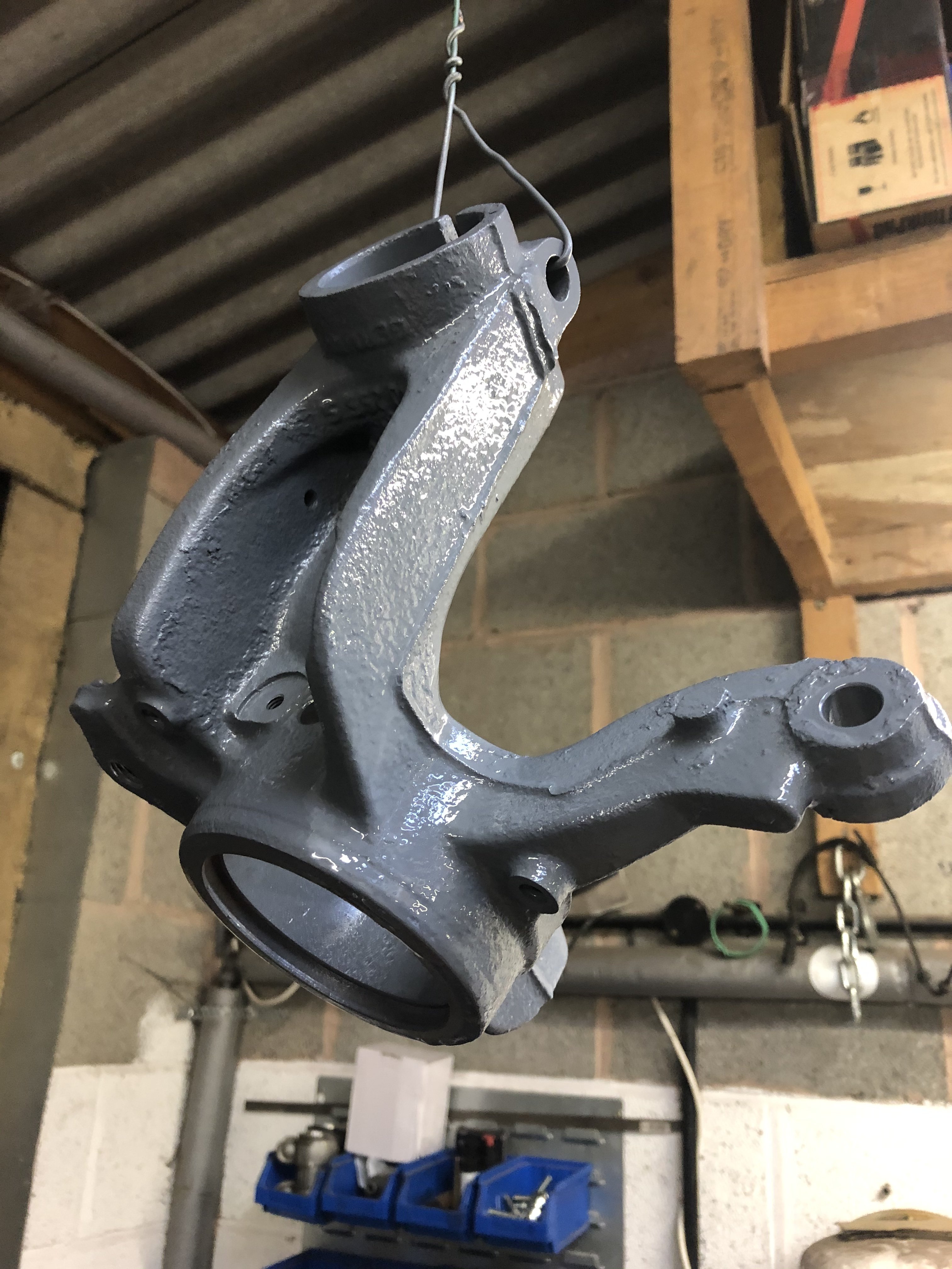

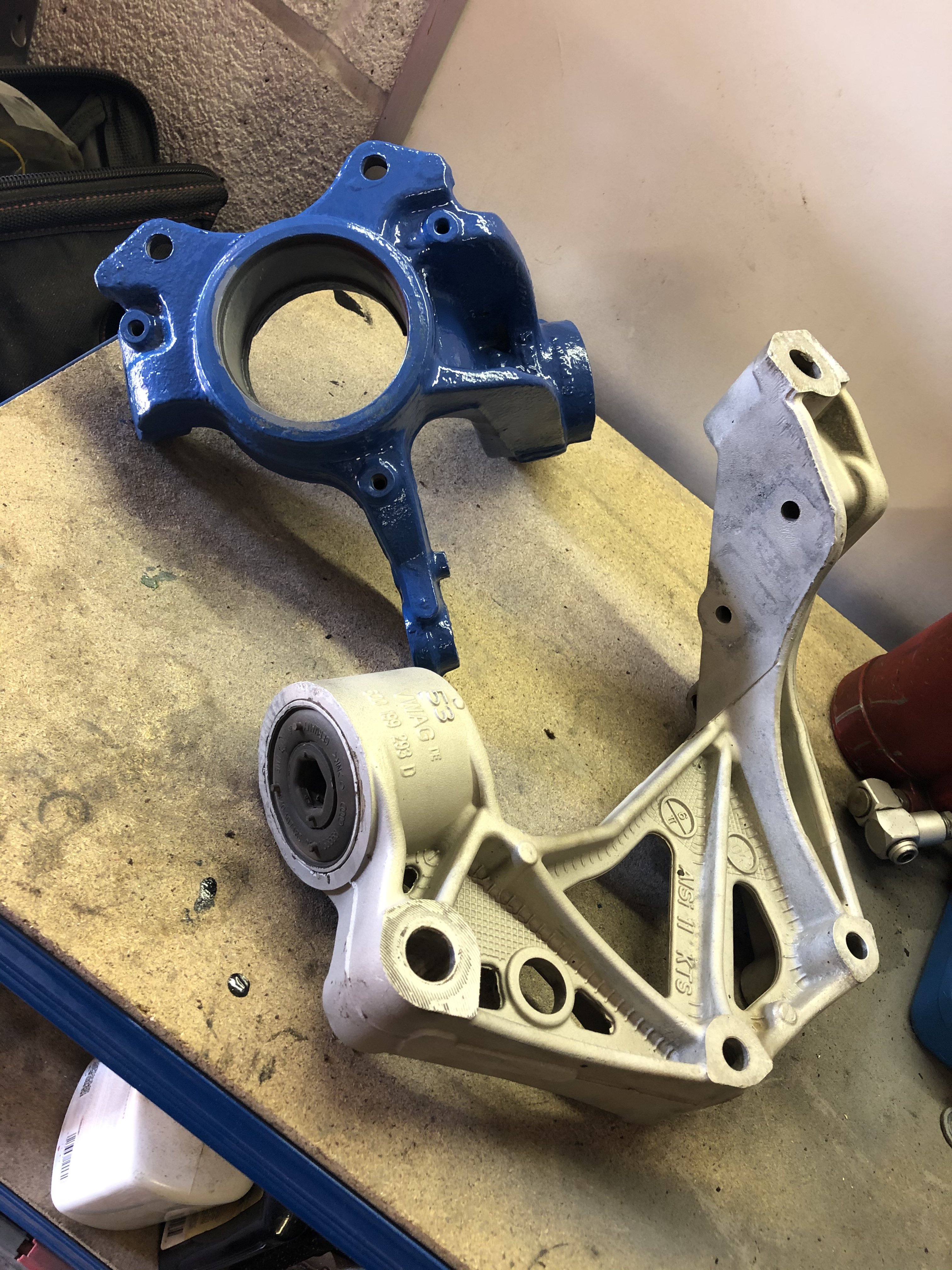

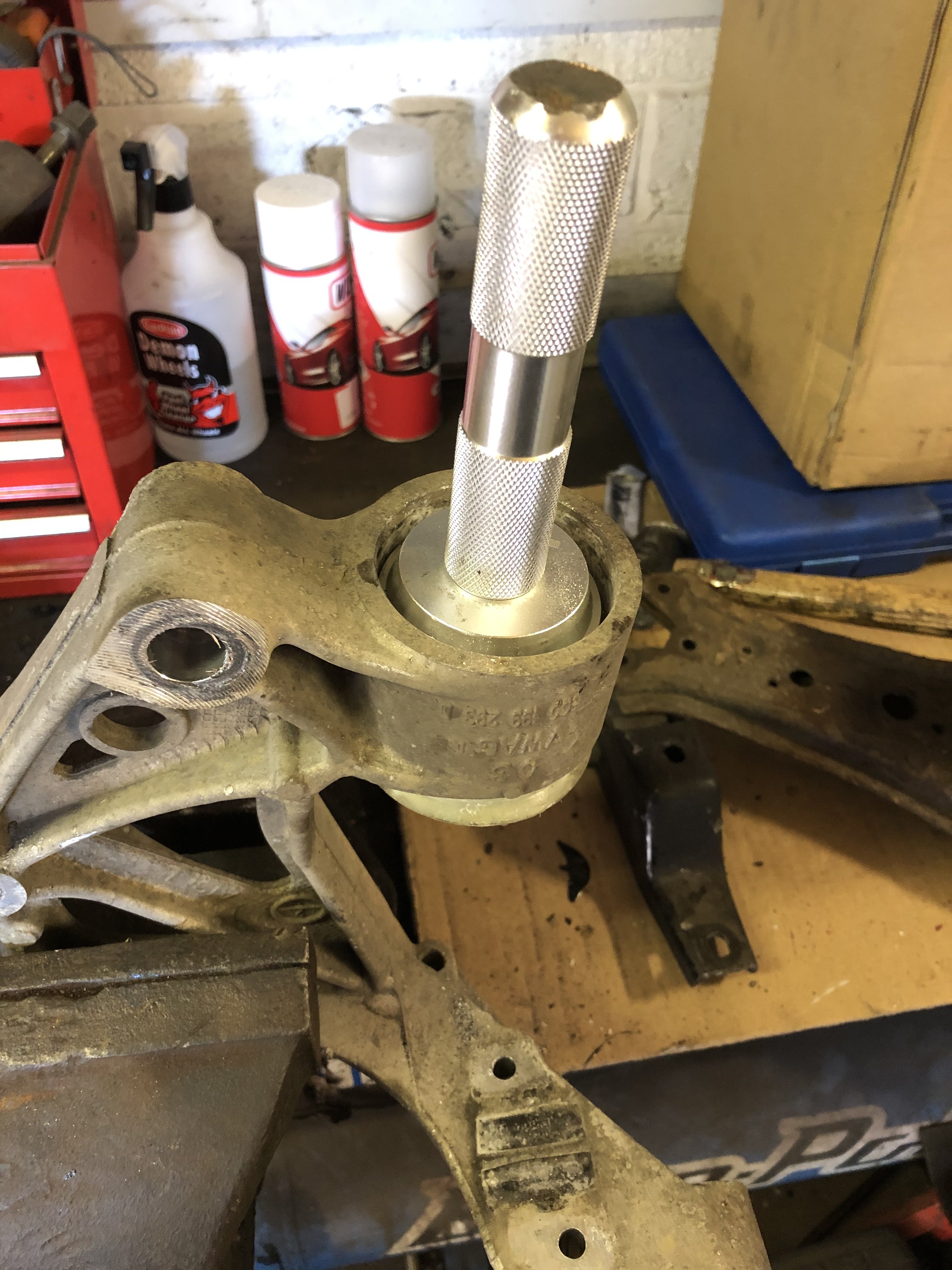

Also got myself a sand blasting cabinet, so things are getting cleaned up ready for some new bearings and bushes :)
Ooh equipment envy over the blasting cabinet Ross☺️

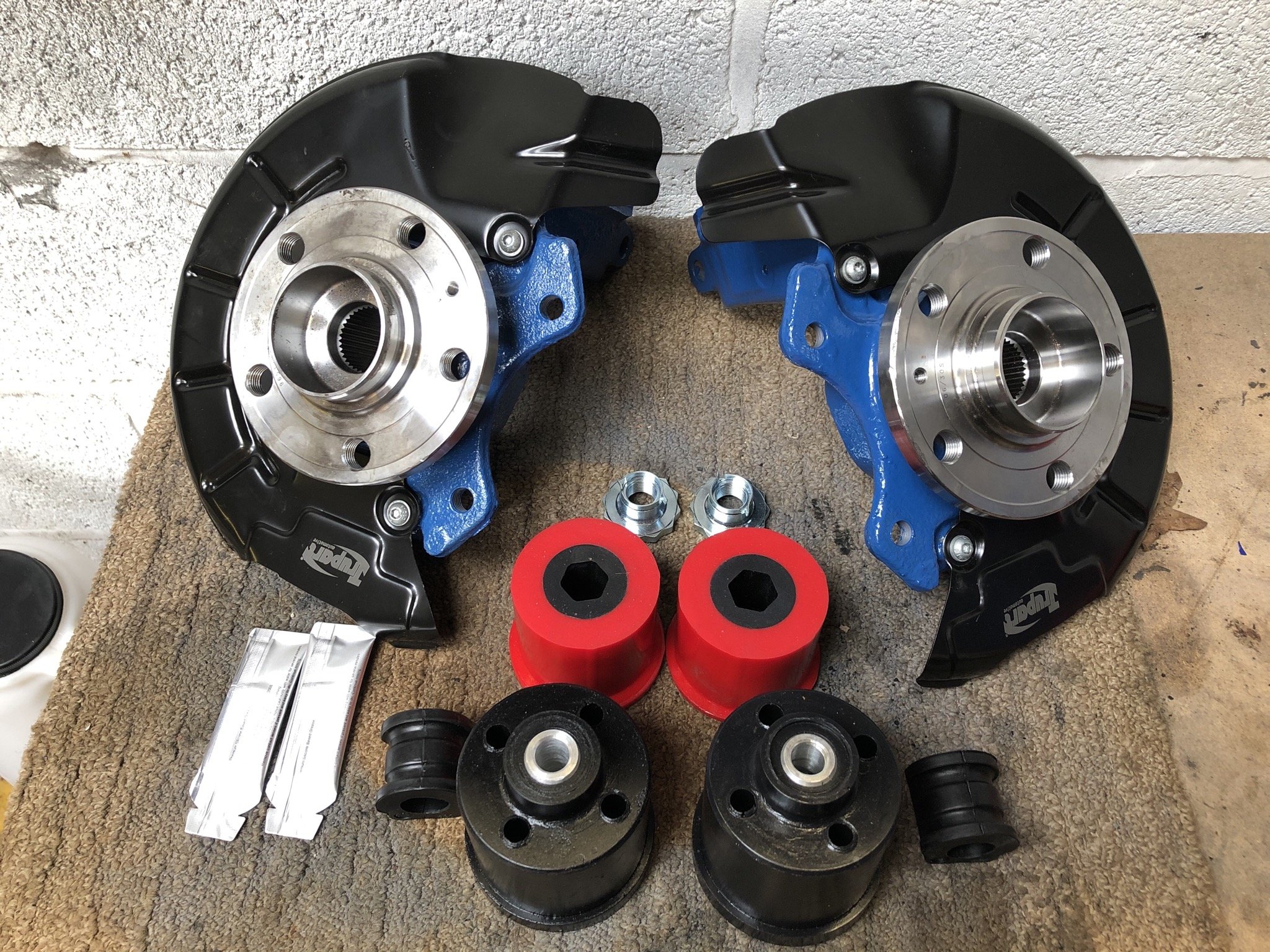

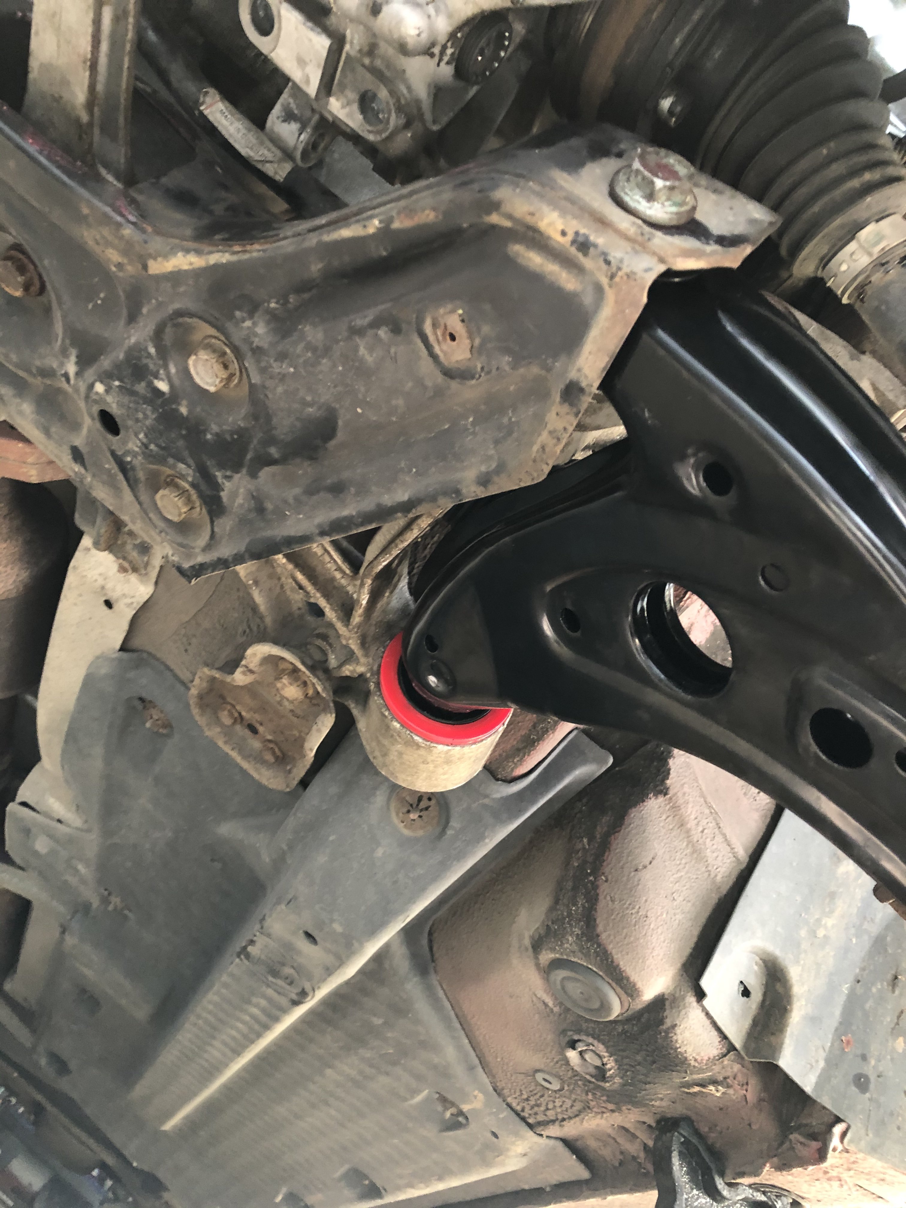

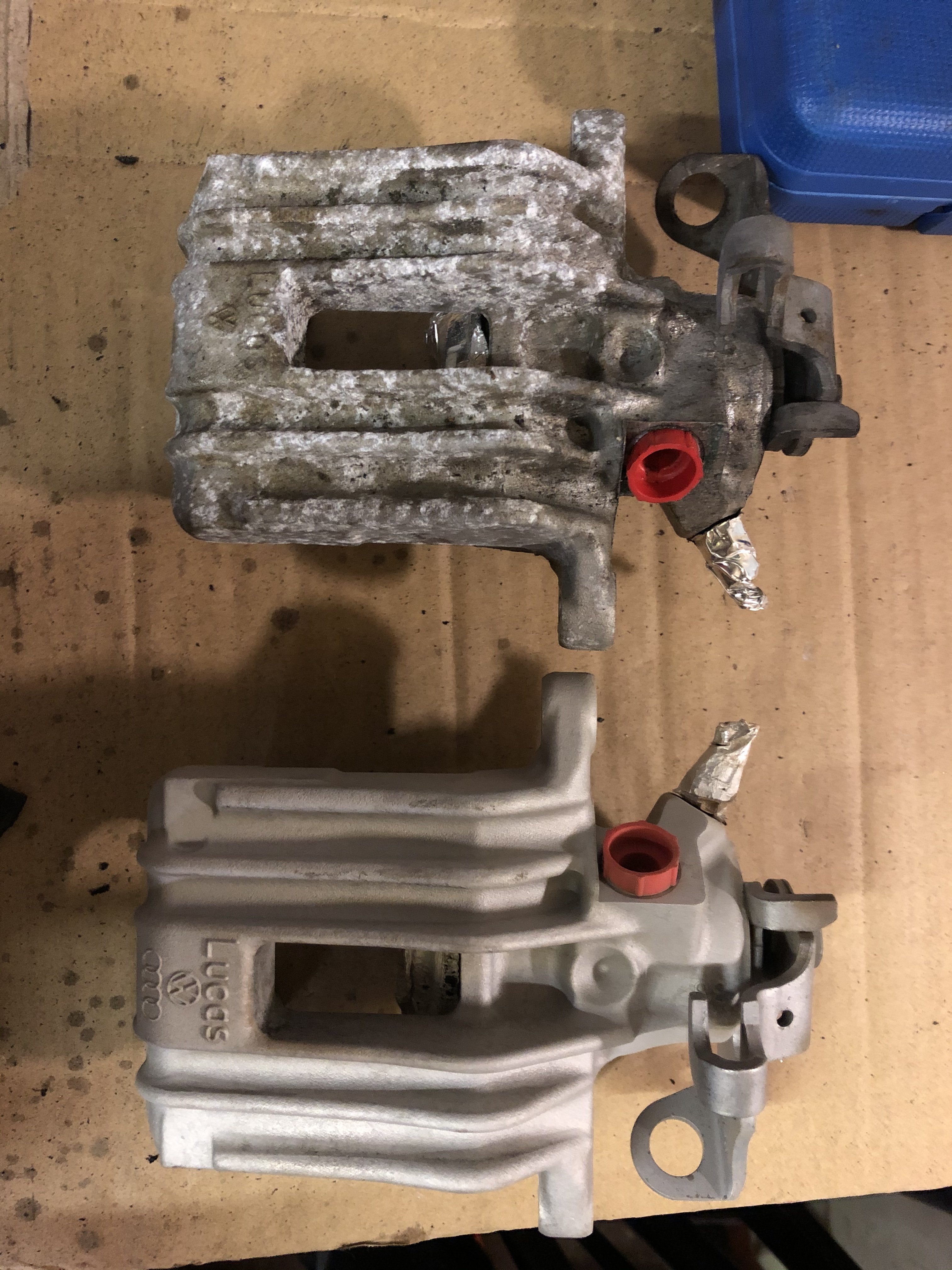

Few more pics from things being built up to put on etc.
Lovely lovely shiny bits! Lofty approves 👍🏻👍🏻
I aim to please :)

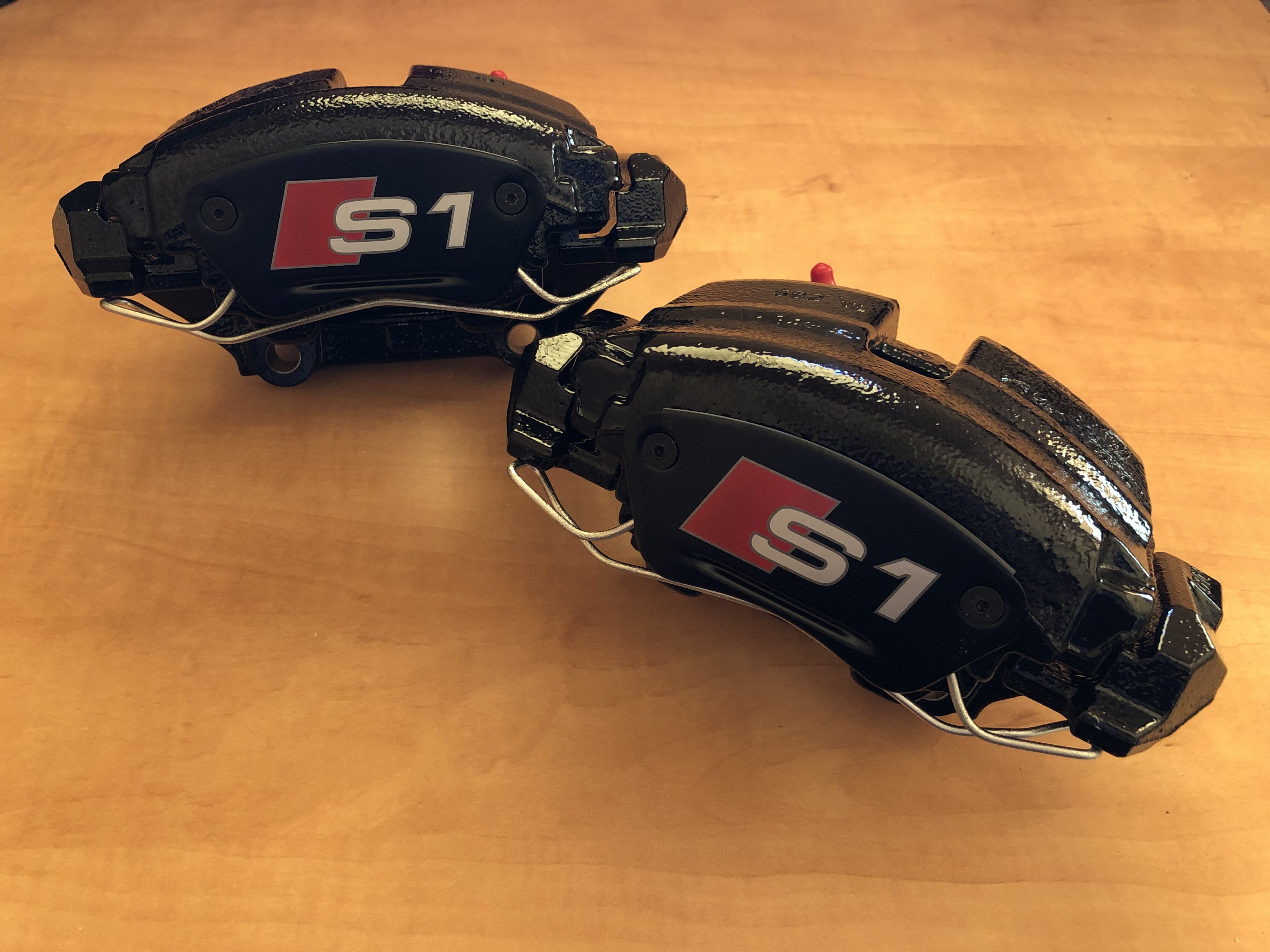

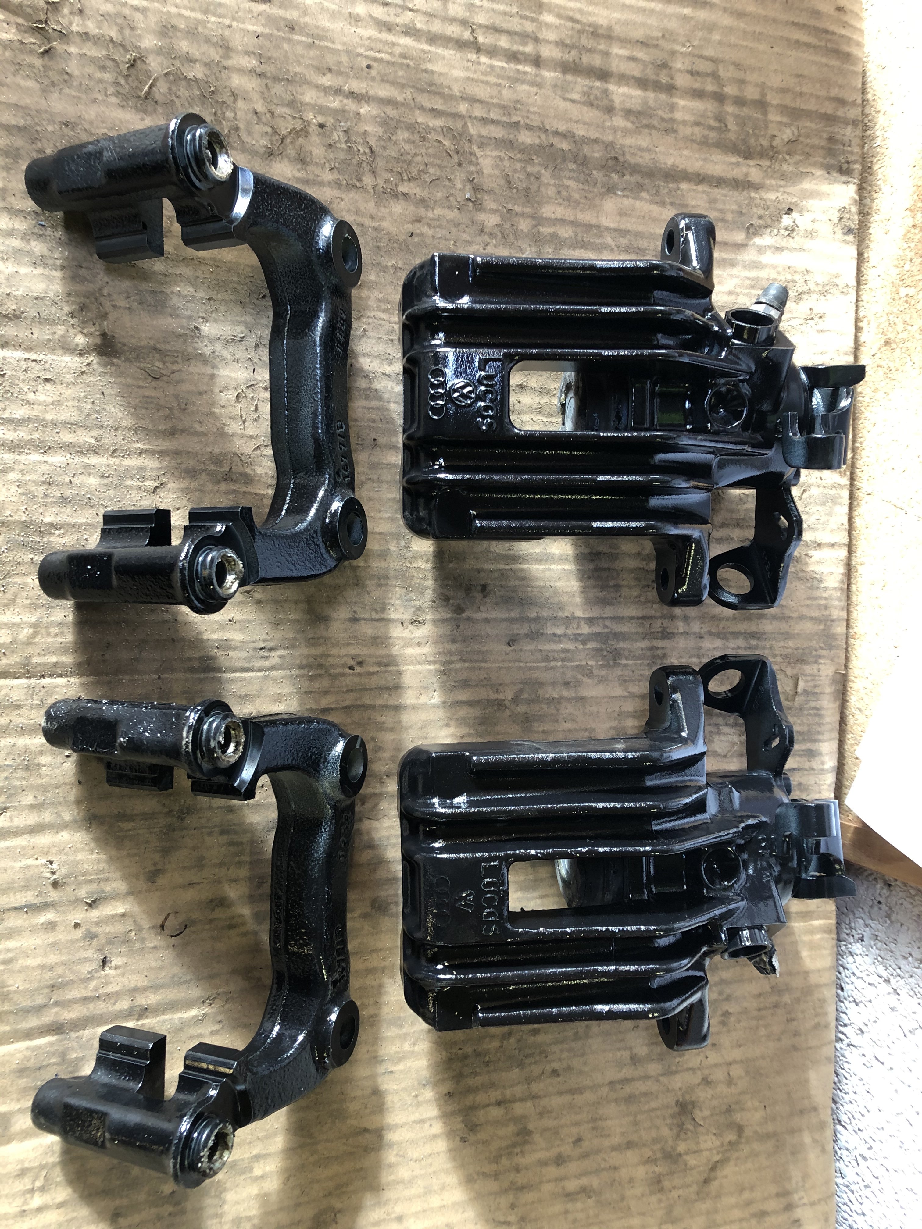

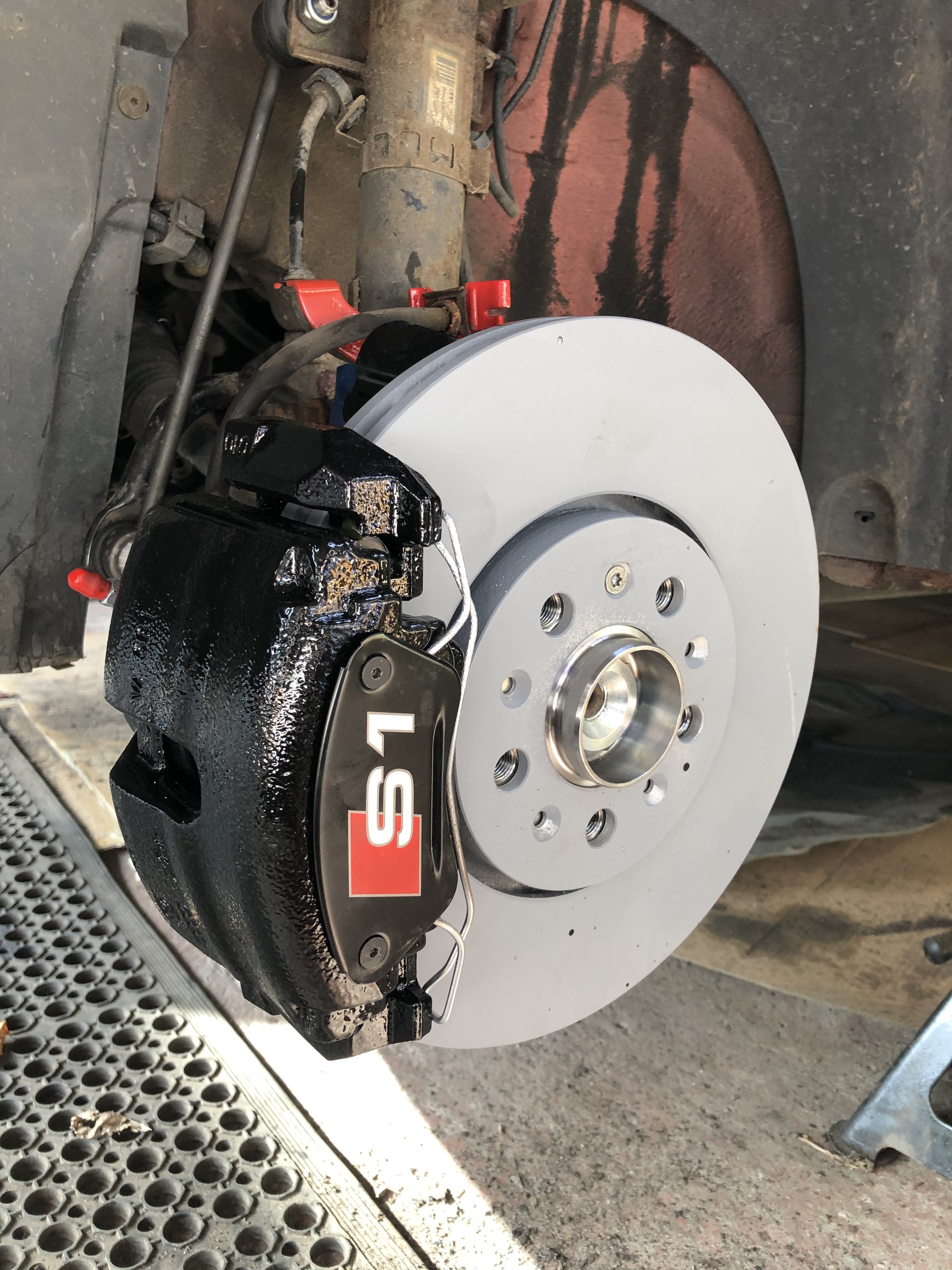

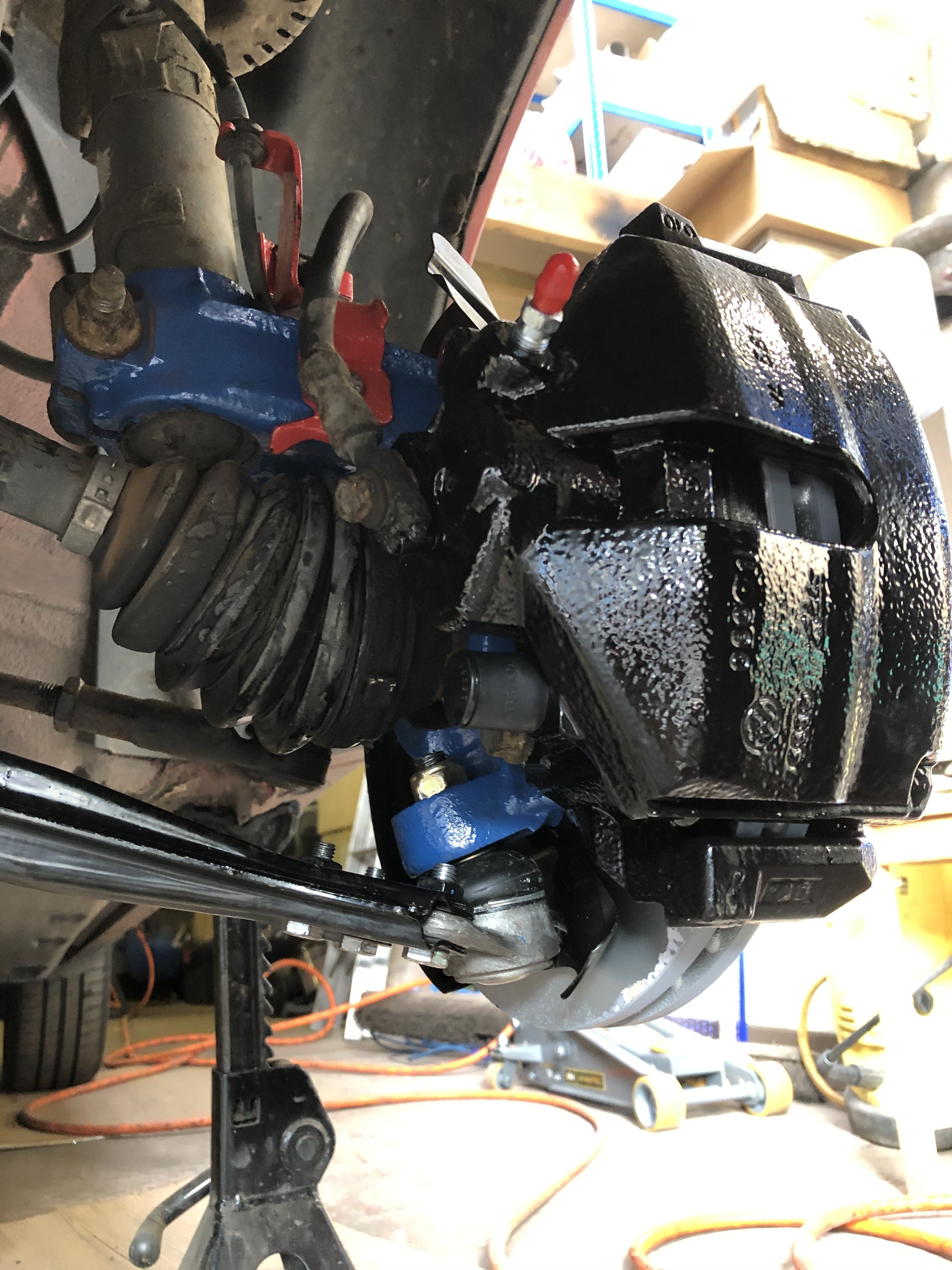

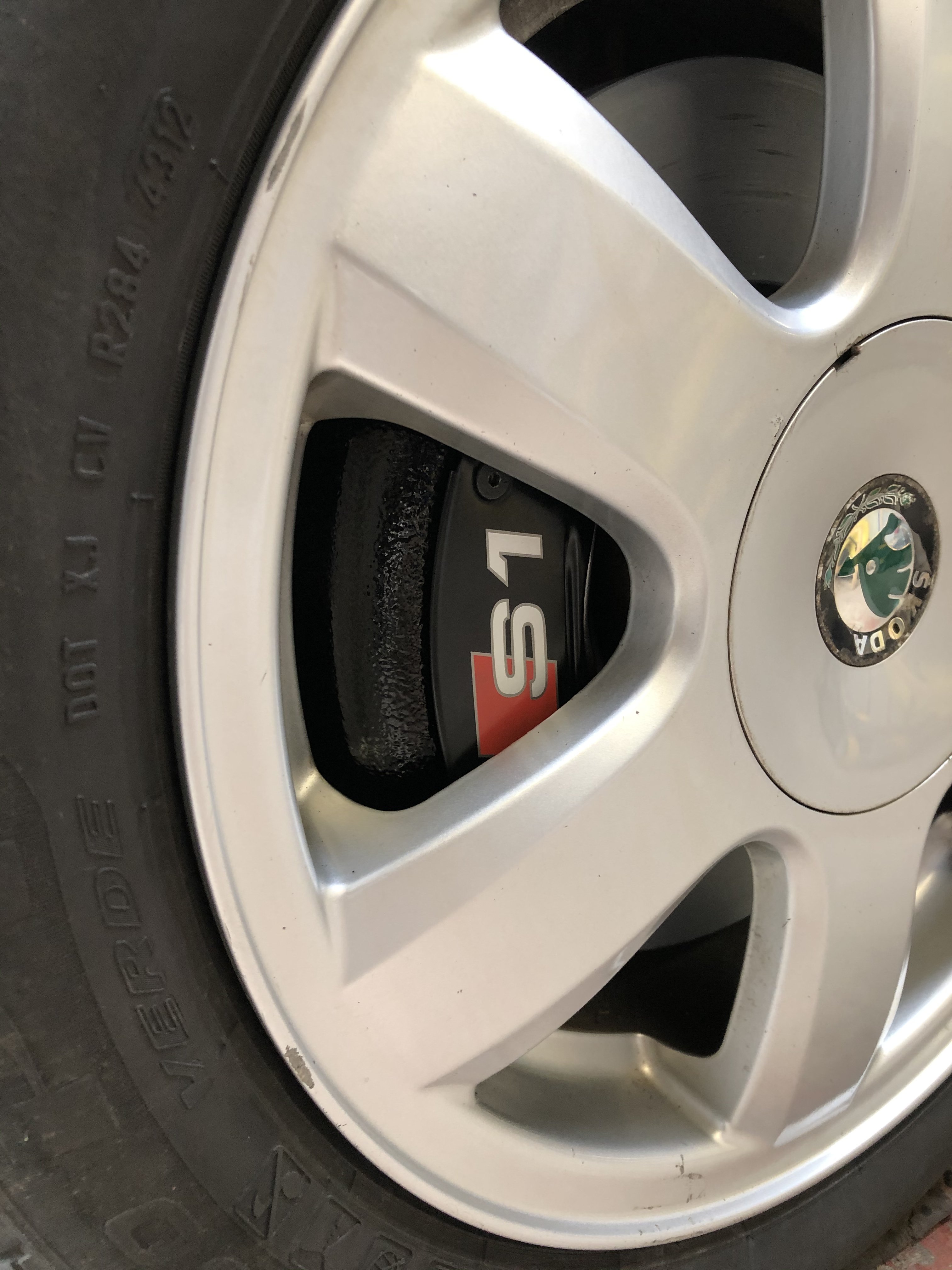

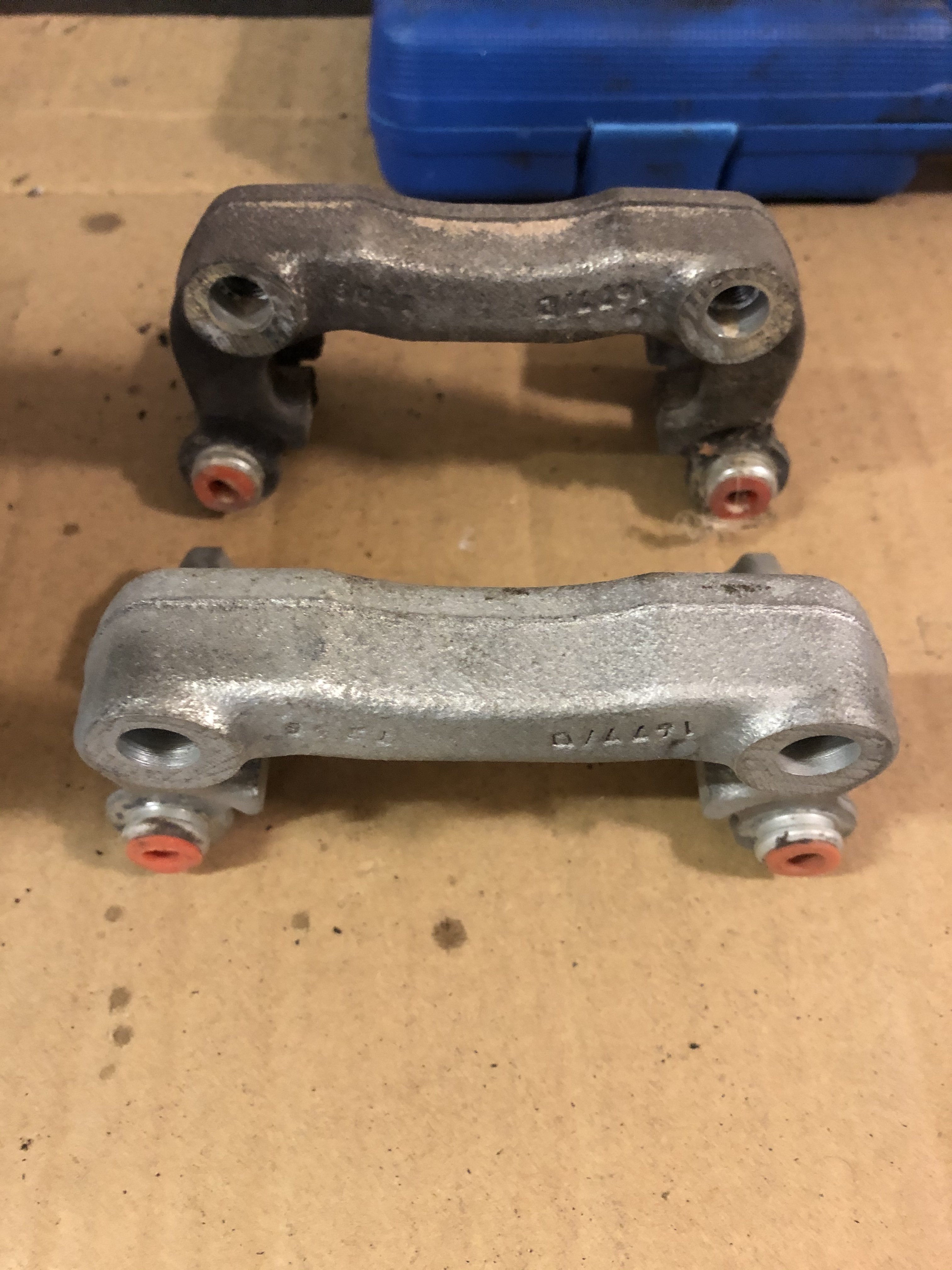

Subtle but obvious (if that makes any sense whatsoever 😂😂) mod with the new S1 calipers Ross, look right at home behind the lovely style of the OE 2.0 15”s
They kinda confuse as S1 brakes are 310mm which won’t fit behind 15” alloys.
So these are actually MK2 Fabia vRS calipers and carriers that use the same 288 mm discs. I just refurbed them in gloss black after drilling and tapping to fit the S1 plates :)
