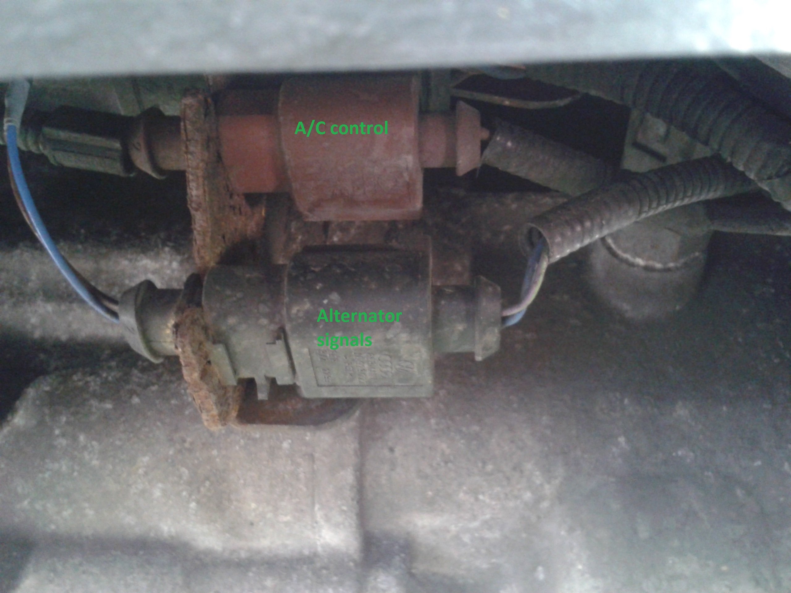

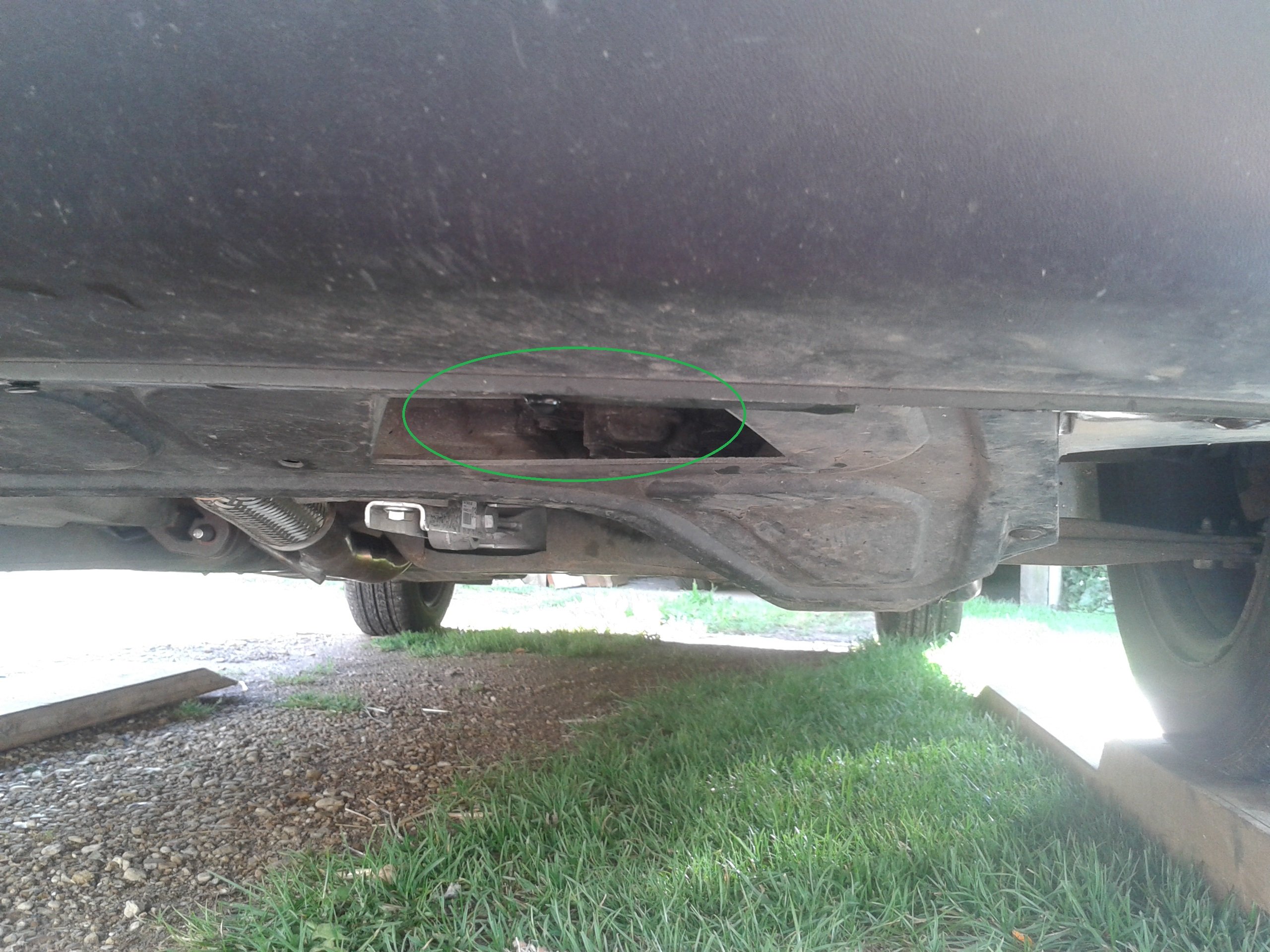

Does the vRS engine undertray have a slot in it near the front giving you a view of the bottom of the gearbox like the one in the first photo?
If so, you may be able to see the DFM wire at the point it usually breaks, along with another that tends to cause the battery light not to come on at ignition on; does yours?
If the slot is there, get a torch and have a peer up there. You might be able to see a two-wire connector like the one in the second photo. See if there's any sign of a wire breakage there.
I shall try and have a look tomorrow if it’s not chucking down.
As far as I can remember all the usual lights come on at iginition, yes I’m sure the car battery light comes on and goes off again as it always has. Honestly can’t say I’ve really paid that much attention. I had a recent photo of all the lights but of course now I want it I can’t find it

OK, from the battery light function being normal we can conclude that the blue wire from alternator to Onboard Supply Control Unit in the cabin is intact. The other wire in my pictue of 'Alternator signals" is the DFM wire, and it actually changes colour at that connector on its way to the engine ECU. Brown/red towards alternator, purple/green towards ECU.
If you can get a look in there; examine this wire for breakage near the connector pair shown.

My money's on a broken load sensing wire to the alternator - the blue one. Especially as it only came on after being on a rough bit of road, engine movement can be enough to finally break a tired corroded wire in the loom connector.
Before the garage does anything else get them to take the undertray off and examine the two wires in the connecting block in front of the starter - I think Wino put a picture up. Might save you a bob or two in wrong parts being fitted.
