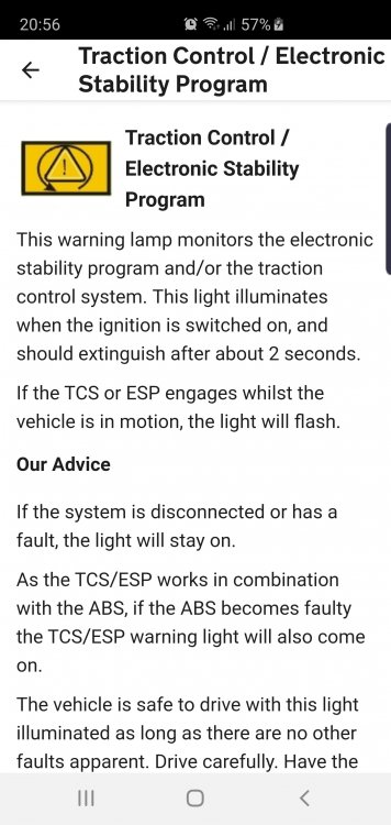

Traction control system

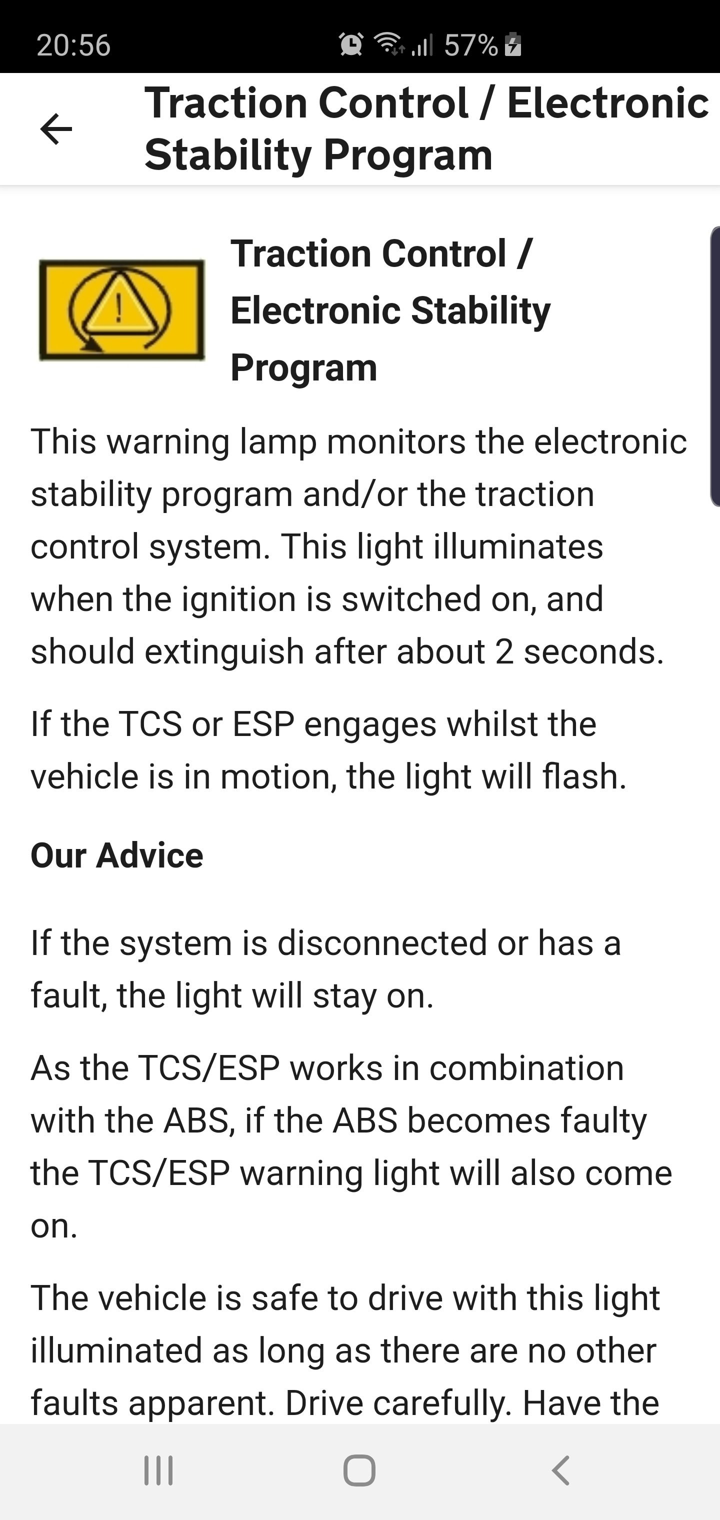

I’ve had Traction control come on before after I’ve done a wheel spin isn’t that the little car with the 2 squiggly lines out the back & disappears after 2 seconds? This light stayed on and came on again after I had switched the engine off and turned it back on to take the photo. When I parked I did a couple of sharp stops and the brakes reacted fine.
2 minutes ago, Munfred said:
Excellent thank you so it’s a trip to the garage to get the ABS checked then.
Its stability control or anti skid problem. ESC fault is the description of that warning light.

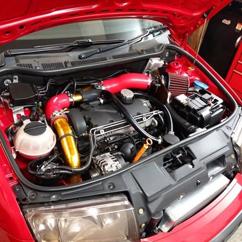

Is the engine ECU on the passenger side, I’ve attached an image is it the silver box or roughly where the silver box is in the top right hand corner is? I’m pretty sure that’s getting wet.
