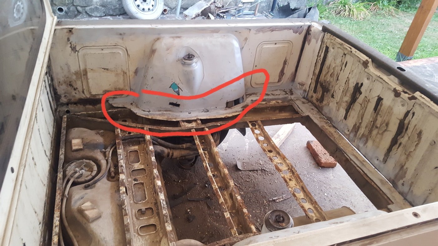

So the situation was this :Webp.net-resizeimage.thumb.jpg.f976c29290ed6c1eb7d4b2ae05935152.jpgmy pickup needed a new bed! I worked hard to clean the rust, cut away the old bed ,preparing new "puzzle"metal patch .
The question now is this : do you think it will be safe to drive for 3 km with the pickup like the picture below to reach the shop of a friend that will wheld new parts?Do I will be able to cut away also the remainig part of the old bed(in the red circle on pic)and than drive to the shop?
I know that maybe it's a "too late" question but prefer to try asking!

I would be more concerned about what the road police would say in case they stop you. Otherwise go slow in 2nd.

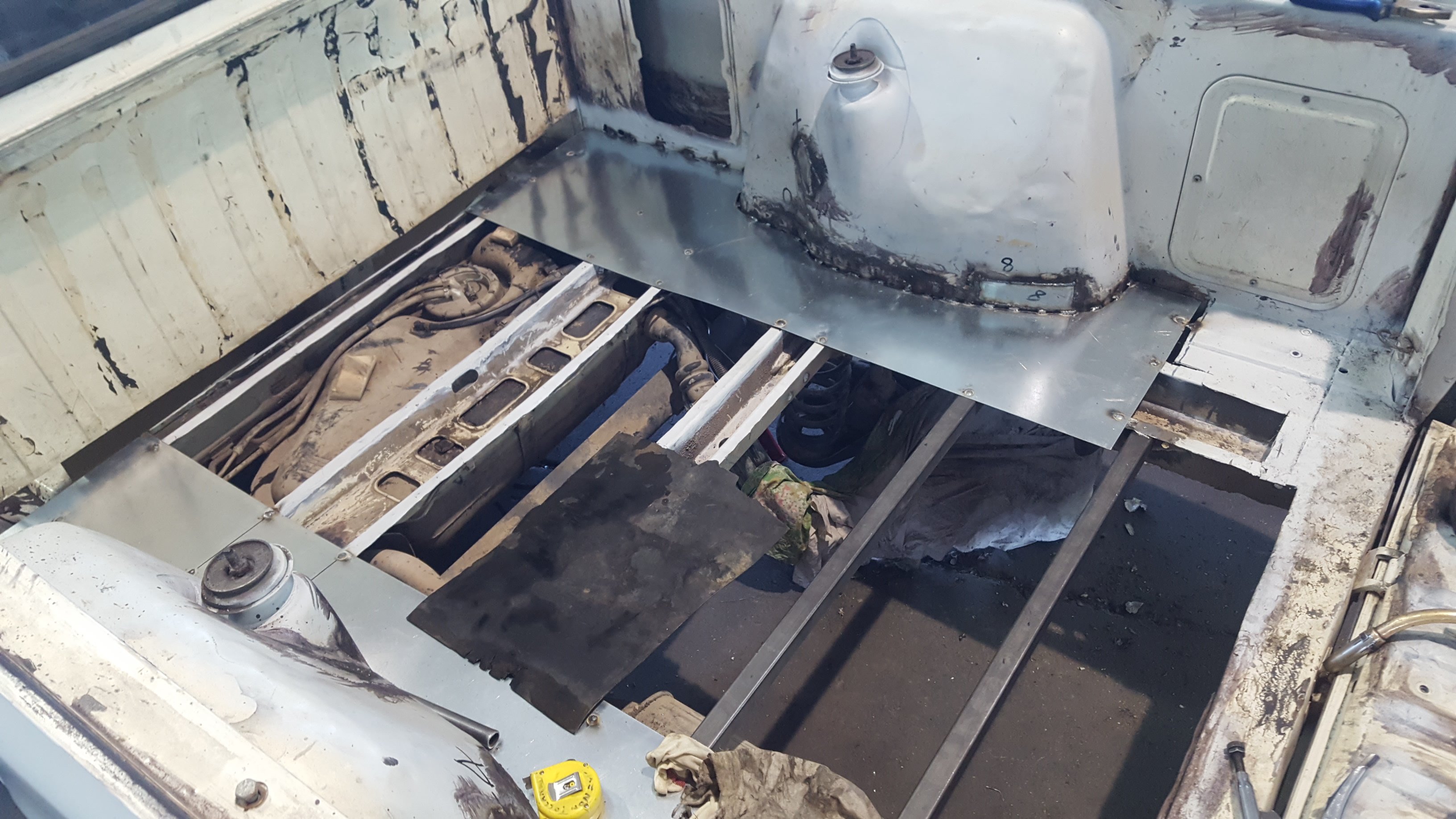

My plan are to weld an iron sheet on the perimeter of the bed and "screw" an alloy sheet on the center . I will not carry so much on felly and this ,  i hope,  made the pickup a bit lighter!
Unfortunatelly my welder friends will not have the time for whelding for the next 3 weeks😭😭😢, so i have the time to continue the restoration process of the "mechanical parts" .....
Edited by Zimo
How about a wooden bed? Strengthen the chassis, give it a good coating of rust converter, paint it then fit yourself protected wooden boards using classic tools.

Do you think would be enogh? I mean welding the "walls" of the bed to the chassis structure (as it was in origin) i would think is better. Are you saying that i have to use wood instead of the alloy sheet? More over the wood needs more attention than alloy even if is much beatifull.....

I think you have a very good plan.  Welding a steel surround will give more strength. Paint the rusted areas with red oxide primer for extra rust protection.  Seal the welds with plasticoat or auto body sealer. I would suggest using aluminum diamond plate for the bed floor. Strong and nice looking.   Cut an access hole the same size as the original one above the fuel gauge sender, and use the original cover.
Remember to be extra careful when welding around the fuel tank. Maybe cover it with wet rags or somesuch. Good Luck

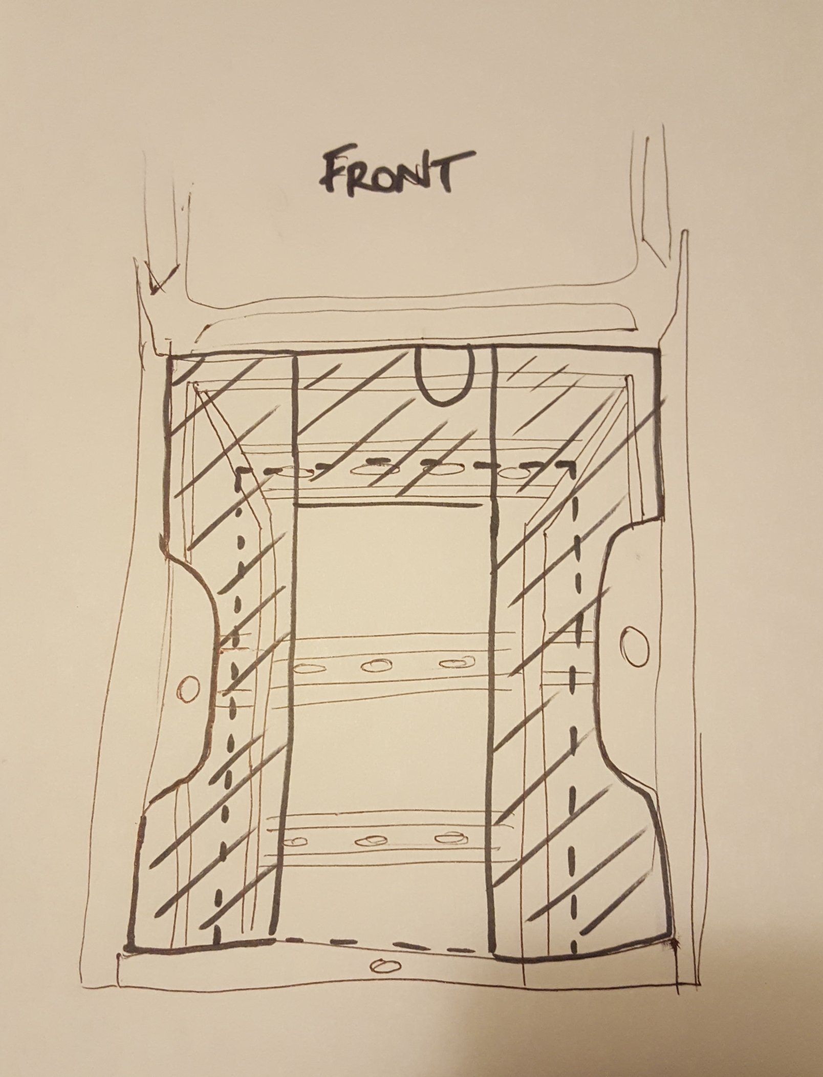

Sorry for my drawings below :
The pen lines are the chassis ,
The black lines are the steel patch ( to be wheld to side walls and chassis)
Tha dashed line is the diamond plate alloy to be "rivetted" to the steel .
Any other suggestions?!

My ideal procedure will be:
-shaping/cutting all the patches and sheet steell to be weld(done)
-drilling hole in the iron sheet in correspondence of the freme to be wire weld
- paint with anti rust paint (please let me know if you have suggestions apart the red oxide primer)
-weld everything in place
-paint/seal the welding point( please suggest paint , product etc )
- cut and rivetting the alloy sheet
What you think?

Apart from using red oxide you could use galvanising primer and then paint with any colour of your liking.
Pay special attention around the rivets and possibly use some type of butyl sealant where the aluminum meets the metal as otherwise it may rattle.
Don't forget to paint the upper parts of the bed a very good and heavy coat of bed liner.

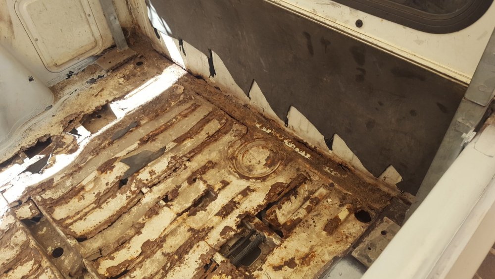

On the pickup structure/chassis i need to weld here and there some sort of spacers (a square pieces of the galvanized sheet , also to rivet the alluminium)because the steel sheet are at some hight and the alluminium sheet would be over . The question is:
How i can "handle" rust under sheet metal "handkerchief"?( dont know the exact word in english)
Because the sheet metal handkerchief are of galvanized iron but under , the point on the chassis need to be clean to be welded?
Dont know if you understand😅😁

Let me get this.
You are worried about rust formation ON THE CROSS BEAMS where the sheet metal is going to lay on the frame or
are you worried about rust forming ON THE SHEET METAL laying over the inaccessible areas obstructed by the frame.
In both cases though you have to options:
Weld the spacers (and paint them with anticorrosion paint) before dropping the sheet metal in place and the just grind all the required welding spots.
Or just use oil based rust protection sprays inside the frame every 6 months (as I live in Greece and our weather is similar you could do it every fall).
