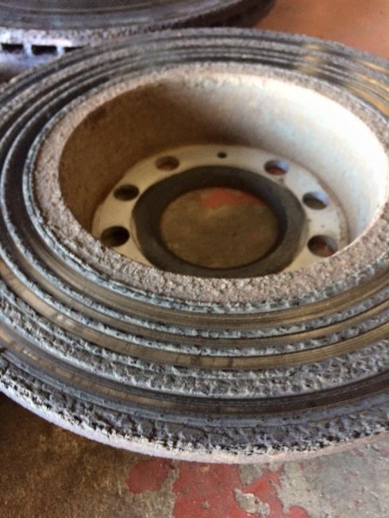

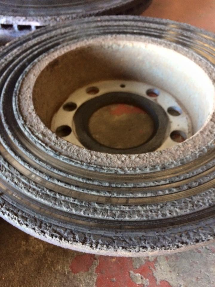

Look at the back of the discs. some can be in a terrible state while the front and the lip is just as you are seeing.
Also there could be a similar lip on the inside diameter of the effective working face of the disc (for want of a better way of describing it)
There could be.
Or there could be worse.
Amazing what some Techs or Fitters fail to see when doing Main Dealership Servicing or pre-sales checks.
Edited by Roottootemoot
Yep that's a beaut'. I work in a machine shop and the amount of folk that come in with discs that look like they came of the titanic to have then skimmed is unreal, thinking they'll get them done for a tenner. We always tell them that yes we will do it but the results will be completely at their own risk (as people often complain of vibration after they've been done. Usually the best way to do them is turn them on a "dolly" or spigot so that both faces of the disc can be skimmed in one setting to ensure total flatness inside face to outside face, it takes time to do it right (of course they can be done the wrong way in a few minutes but the results usually speak for themselves. Even a few micron of a run-out can cause vibration.
