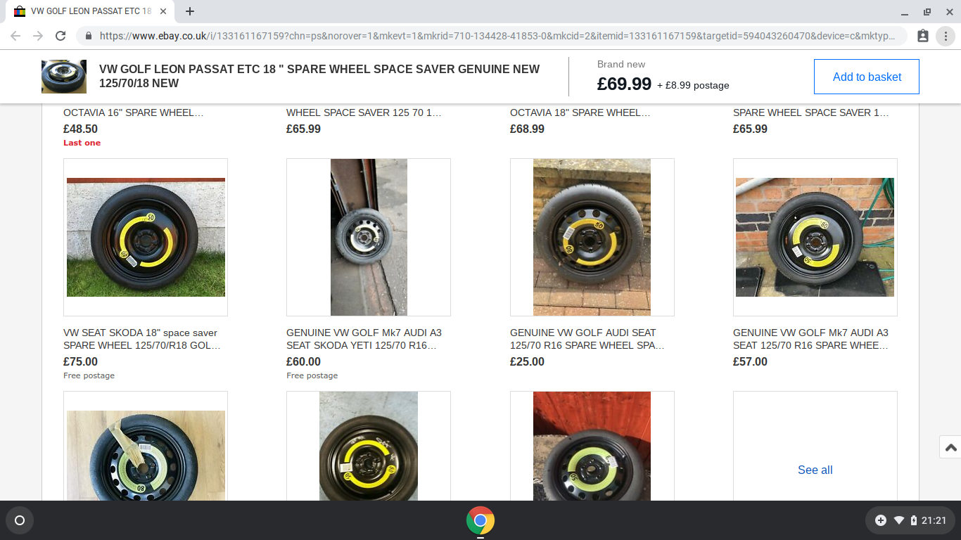

@Urrell

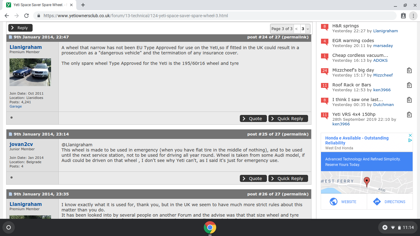

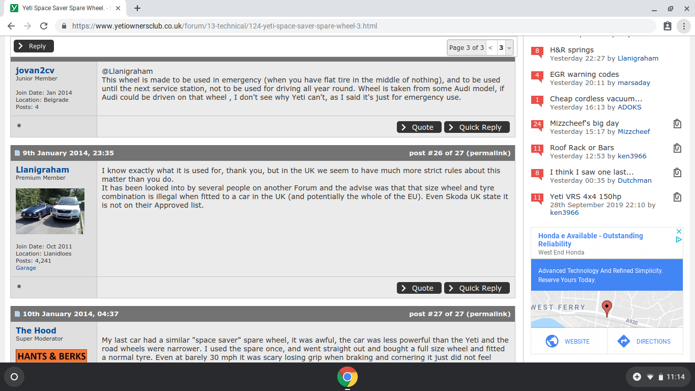

Why are Skinny Space Savers not legal on a Yeti?
Edited by Roottootemoot

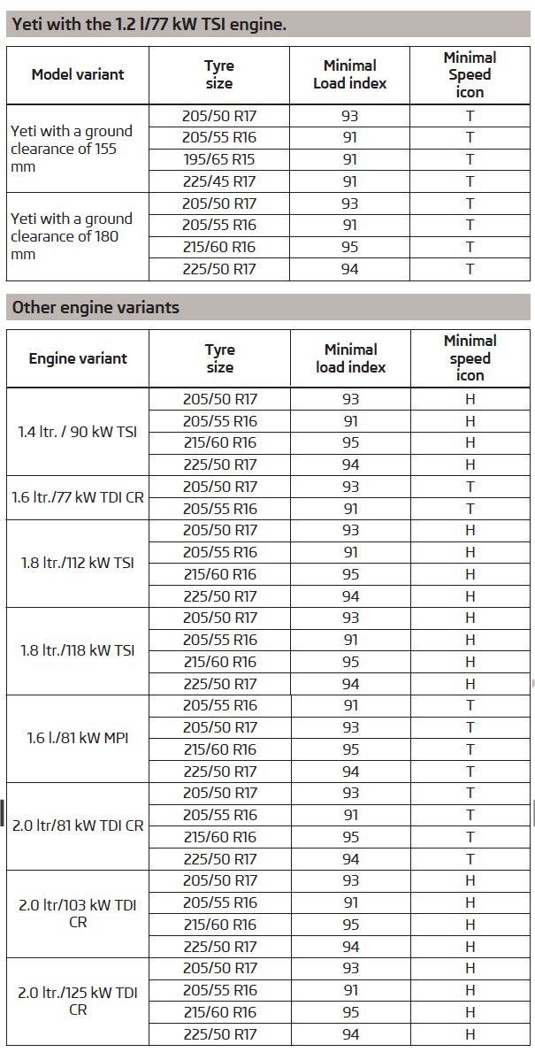

Because these are the only approved tyre sizes on the Yeti.

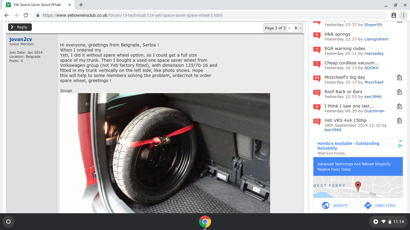

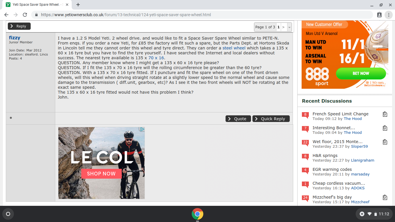

Indeed the 'Emergency Spare wheel' that is a Space Saver not a Steel saving space with odd tyre to the 3 on the car spare does not show.
A get you to a place of safety legally Space Saver Wheel.
VW Group Dealers Sell & Supply these wheels / tyres across the board for so many Models in the VW, Skoda, Audi & SEAT range.
Best check and see if these apear in their lists of Type Approved / Constuction & Use allowed wheel / tyre sizes or which have approval and which are excluded.
They are available from Official VW Group suppliers for Heavier Vehicles than a Yeti and Globally.
With the Yeti and Briskoda members the same old keeps getting posted and people tend to do their own thing and if needs must discuss the matter with a Traffic Officer or a DVSA Inspector if pulled at the roadside.

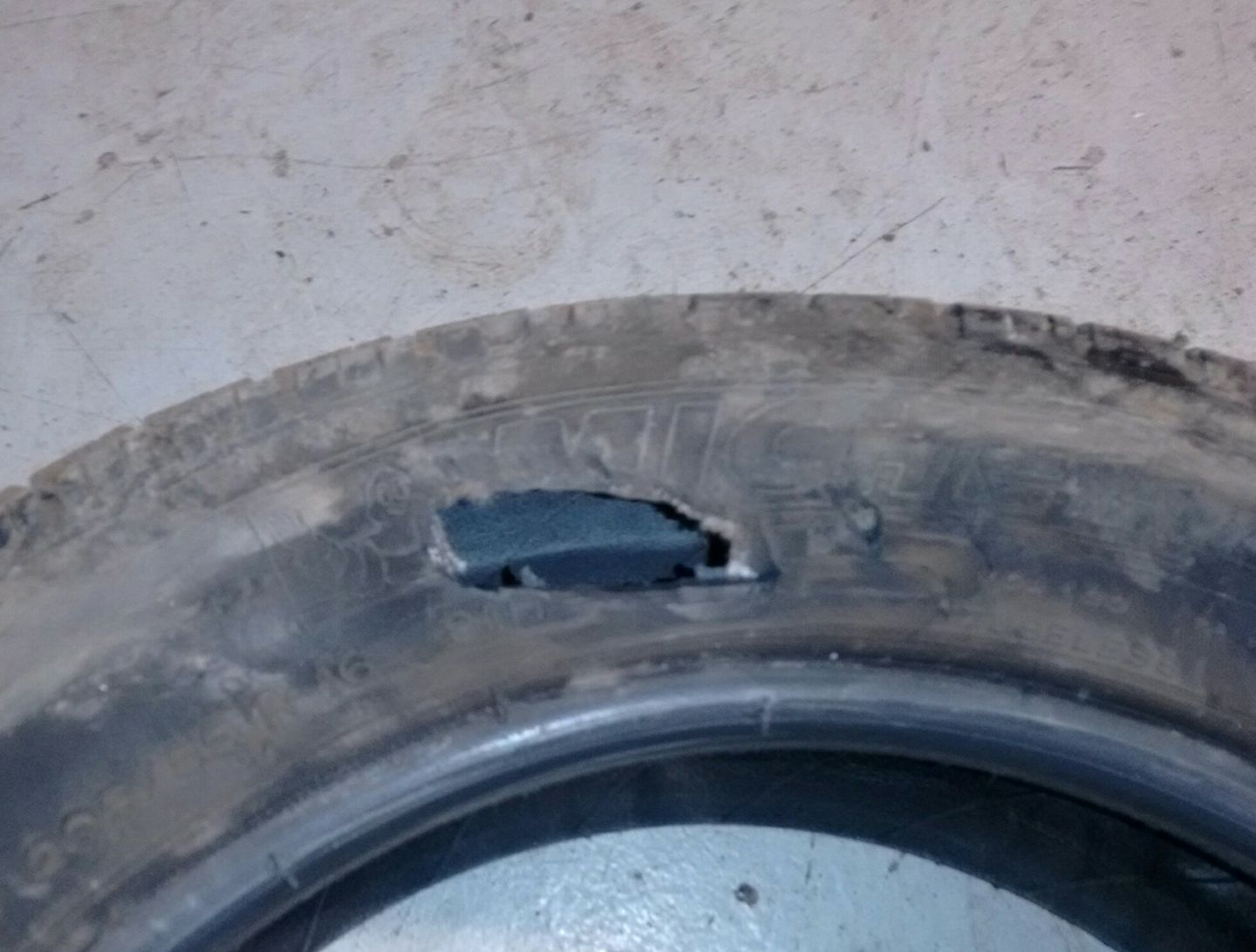

Gunk would not have helped in this blowout I had in the Yeti.
My point exactly.
