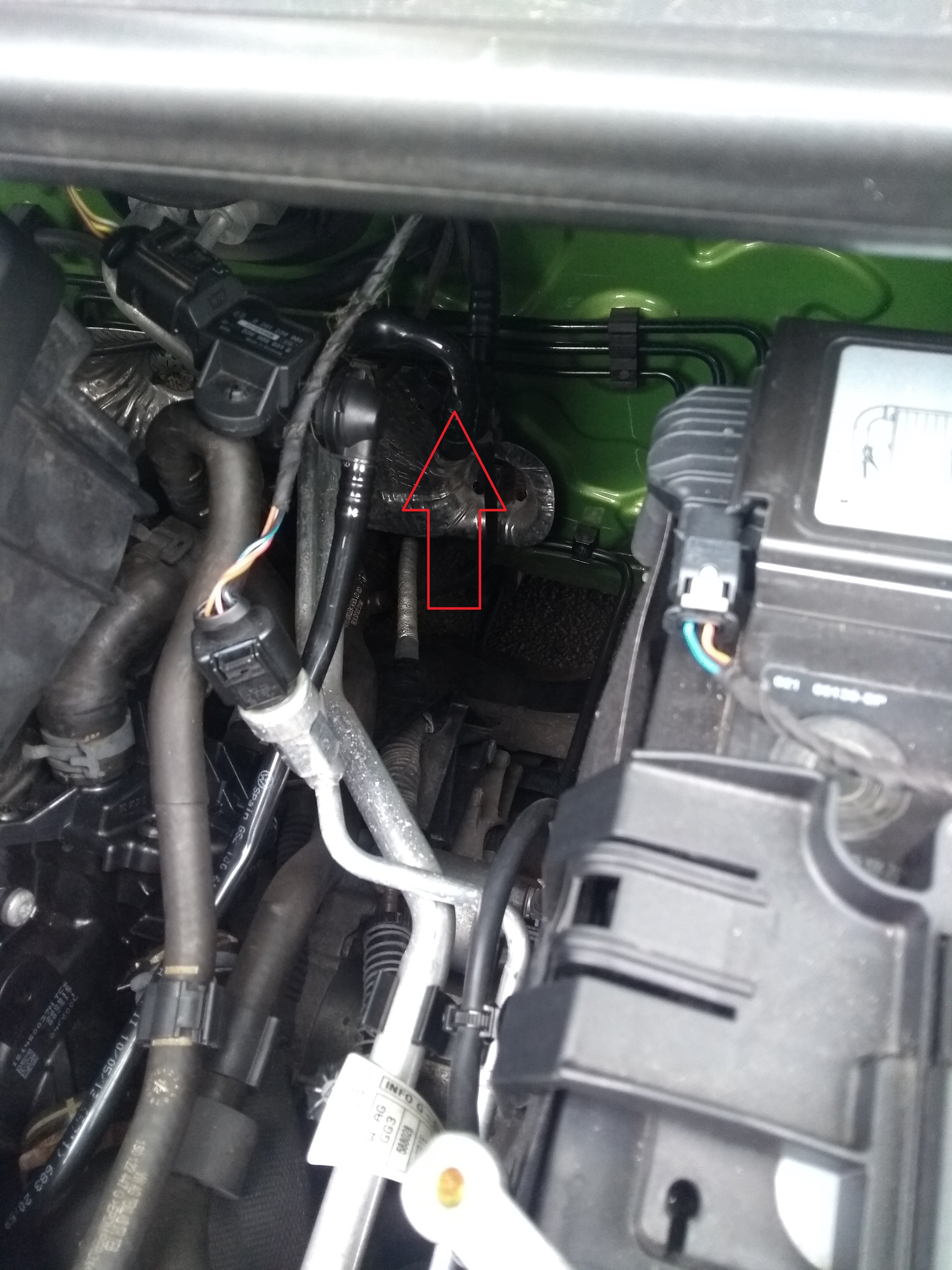

It's the connection to the right of the engine, near behind the air filter:

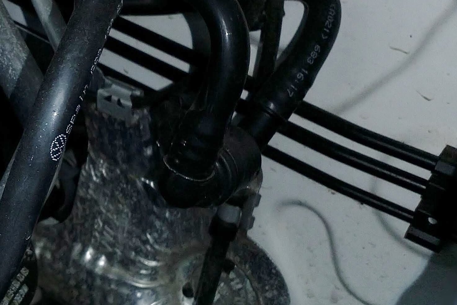

My connection looks like this - are the black clips meant to be together?

Never seen anything like that, but I'd say 'without doubt'.
That is definately wrong, I've just checked mine. Those flanges should be flush.
Yep, just needs to be pushed in a little further

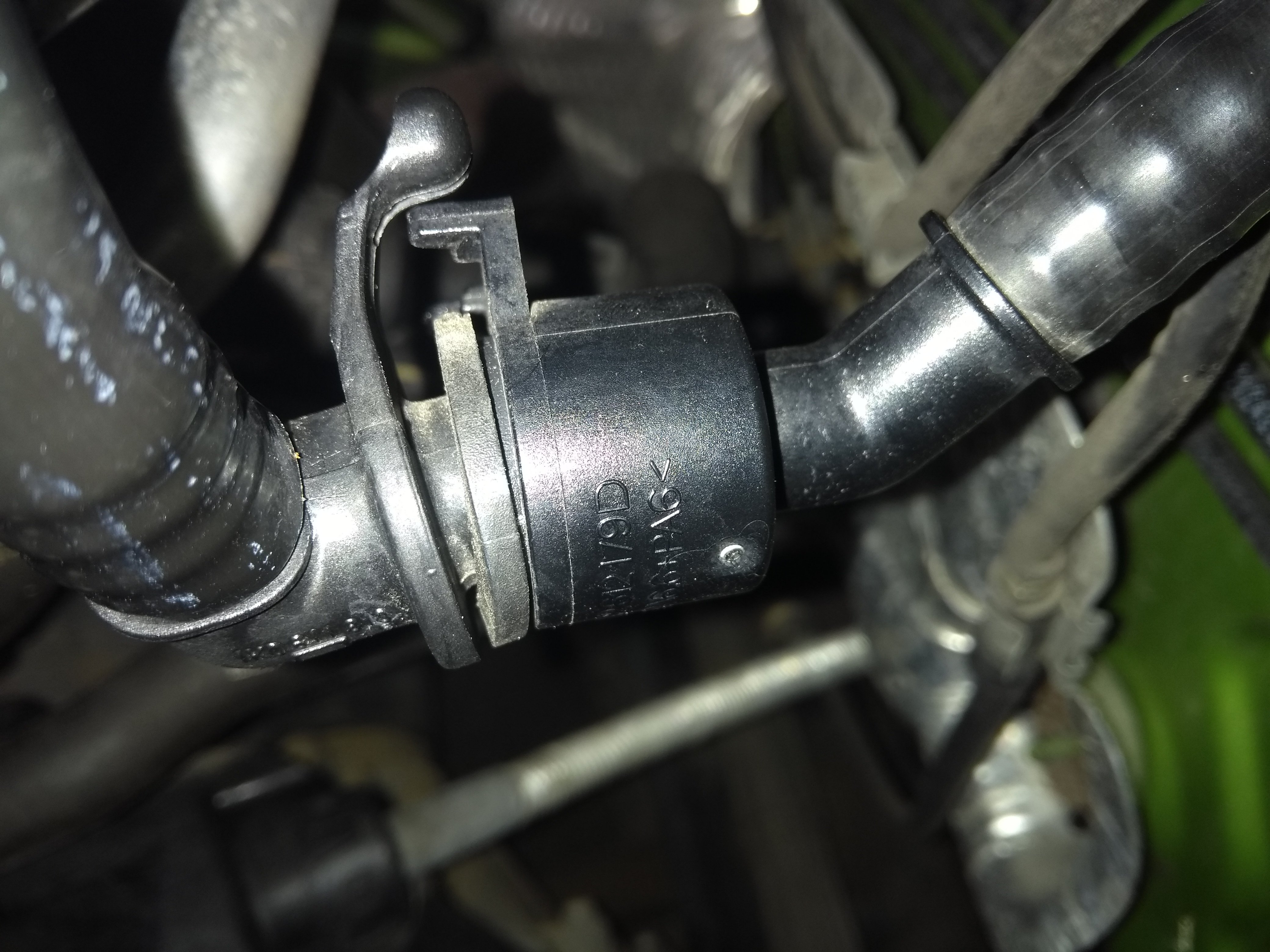

Thanks mate - I can't see from your photo but are the plastic clips clipped together?
Yes, you can see on the photo that the flanges are flush, it's chucking it down outside now and I couldn't get my phone at the right angle.
