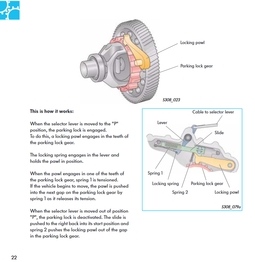

Found this. So again, I hope its just a cable issue on mine
Try putting it in Park and then pushing the lever forward further (not forcing it) see if it engages the Paw. If so sure sign the cable needs adjusting
I tried pushing forward and it did nothing. My guess from that diagram would be if the cable is overtightened then the slide will be lifted away from the locking pawl meaning it never comes into contact with the parking lock gears.
