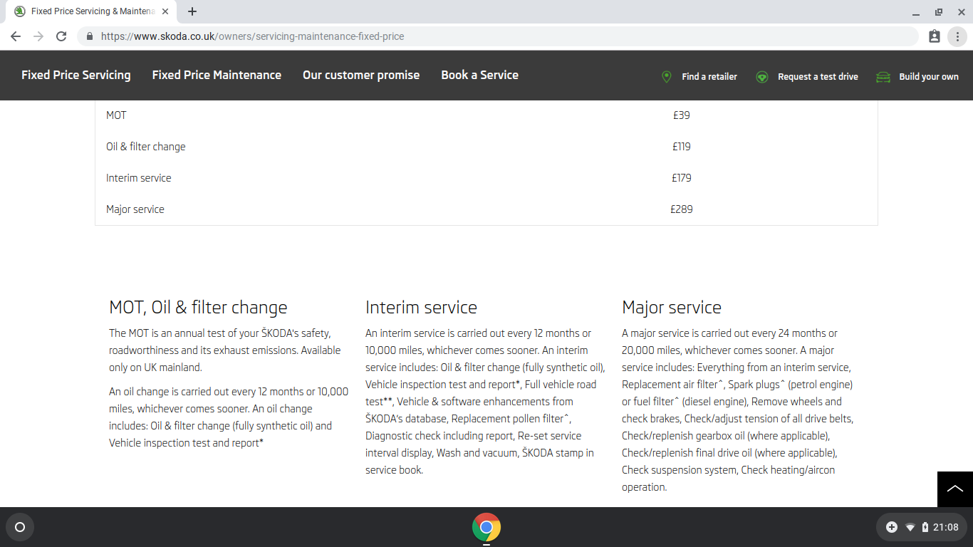

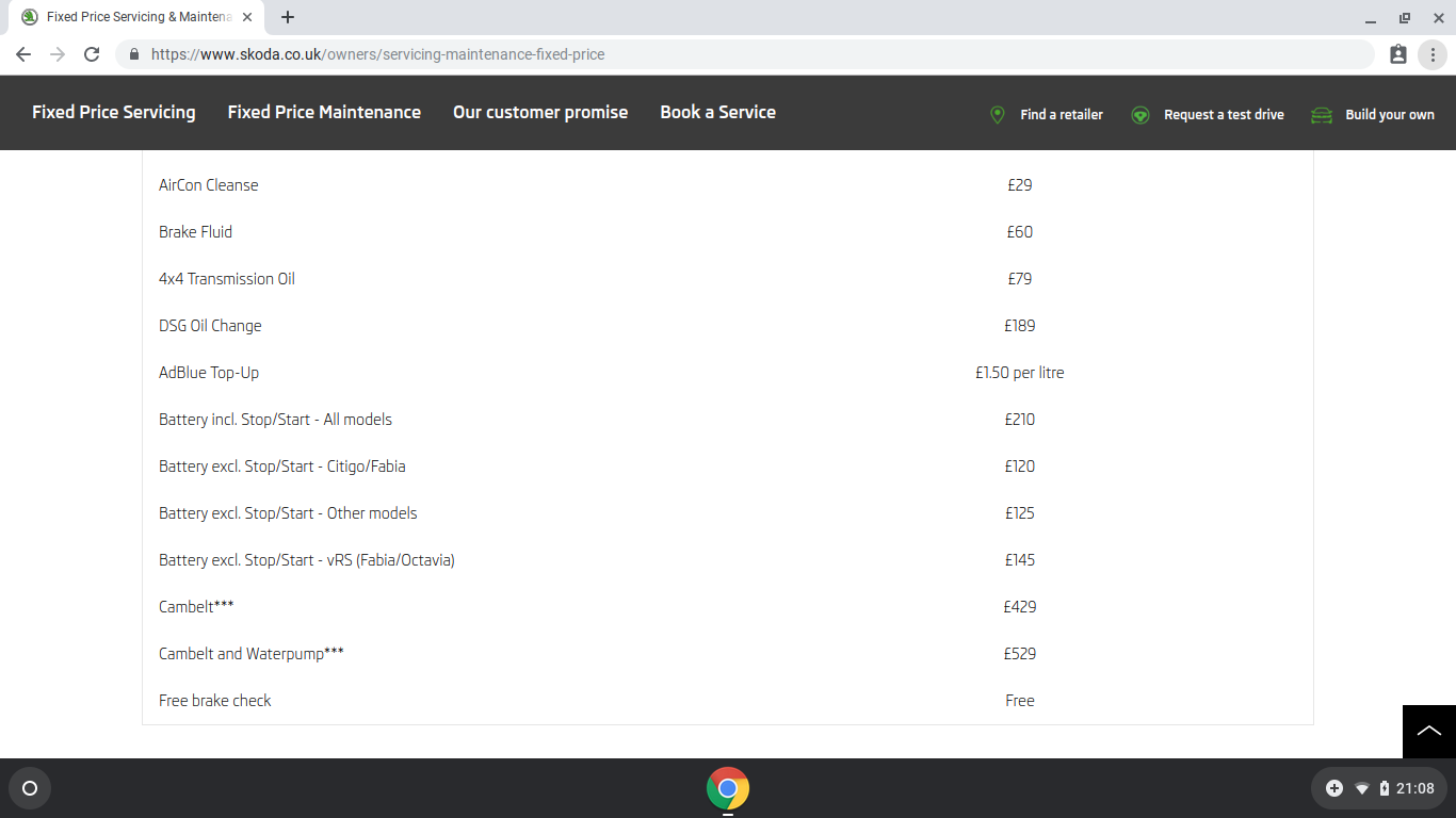

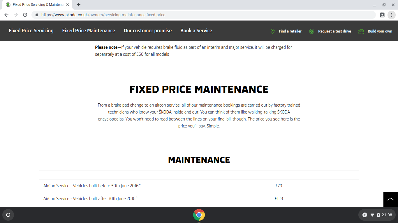

This is an idea of Servicig, and these are 3-10 year fixed prices that some dealerships do,
