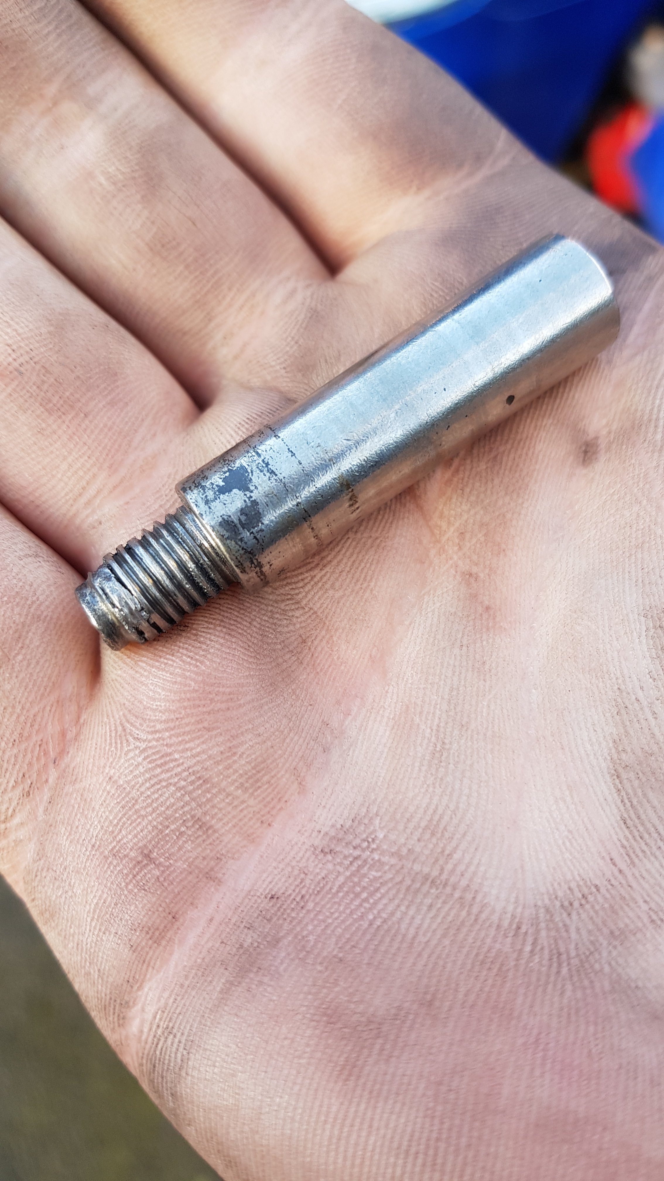

Looking at the bottom of the thread on that last photo looks to me like its been crossthreaded and rather mangled, that might be your problem. Having done mine yesterday I notcied theres quite a lot of room for movement on the entry angle into the thread, so easy to get it wrong if you're not careful.
Thanks for your input. Do you think it's dangerous to drive on or would you advise to not drive until new pins installed? 🙈

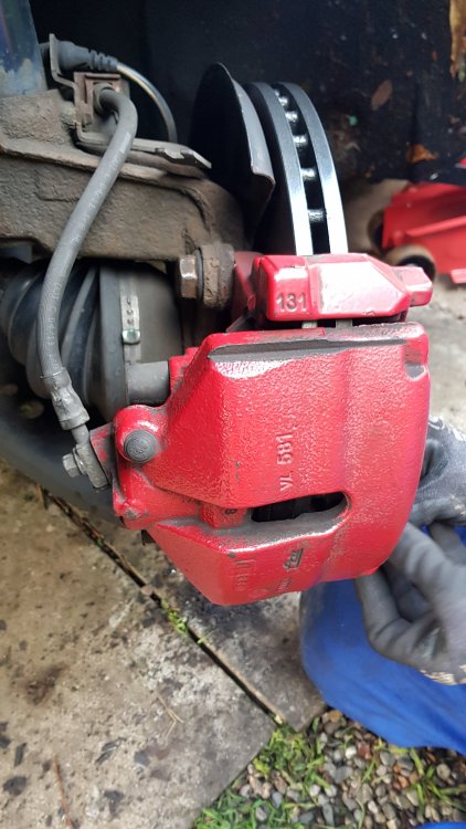

I sincerely hope the photograph at the top is not one you took with the caliper in place when the pin was "spinning"
If it is then it looks to me that you have not engaged the caliper in the carrier before fitting first the upper fixing bolt and then the lower, its spinning because its hanging in fresh air and only held on by the lower bolt.
I believe that the shiny unpainted part at the top should be located behind the carrier bracket.
Do not drive it if its only held on with one bolt.
The above is from memory so if i have it wrong then I apologise.
Editted, maybe my memory is at fault and the pads are not fitted in the photo.

Its common for the threads to pull out of the hub carrier. It looks like some of the threads are attached to the threads on your guide pin. I would inspect the threads and replace hub carrier or repair if necessary.

As mentioned above is the first picture of the caliper fastened in place?
If it is then it looks like it is not fitted correctly.

Nope. It is very easy to think the thread is in if you don't push the caliper home fully but you know that same as I do.

I can see how the thread on the pin gets damaged as shown in the photo by someone lacking the tactile sense of feeling that its not engaged in a thread but graunching on the side of something, what I have never understood is how the threads can become stripped in the carriers, they are a large thread and its a small allen key size.
People must be using a hex bit in a socket with a large ratchet and really doing a gorilla job trying to fit a damaged thread after they work out the caliper needs pushing into position.
Its due to corrosion, very common on this style of caliper fixing. Happened to me, on removal of the pin it took all the threads out, didn't even get to the assembly. Never had threads come out of a caliper bracket before but the threads in the hubs are chocolate.

Try running a tap into the mangled hole.
