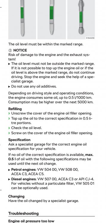

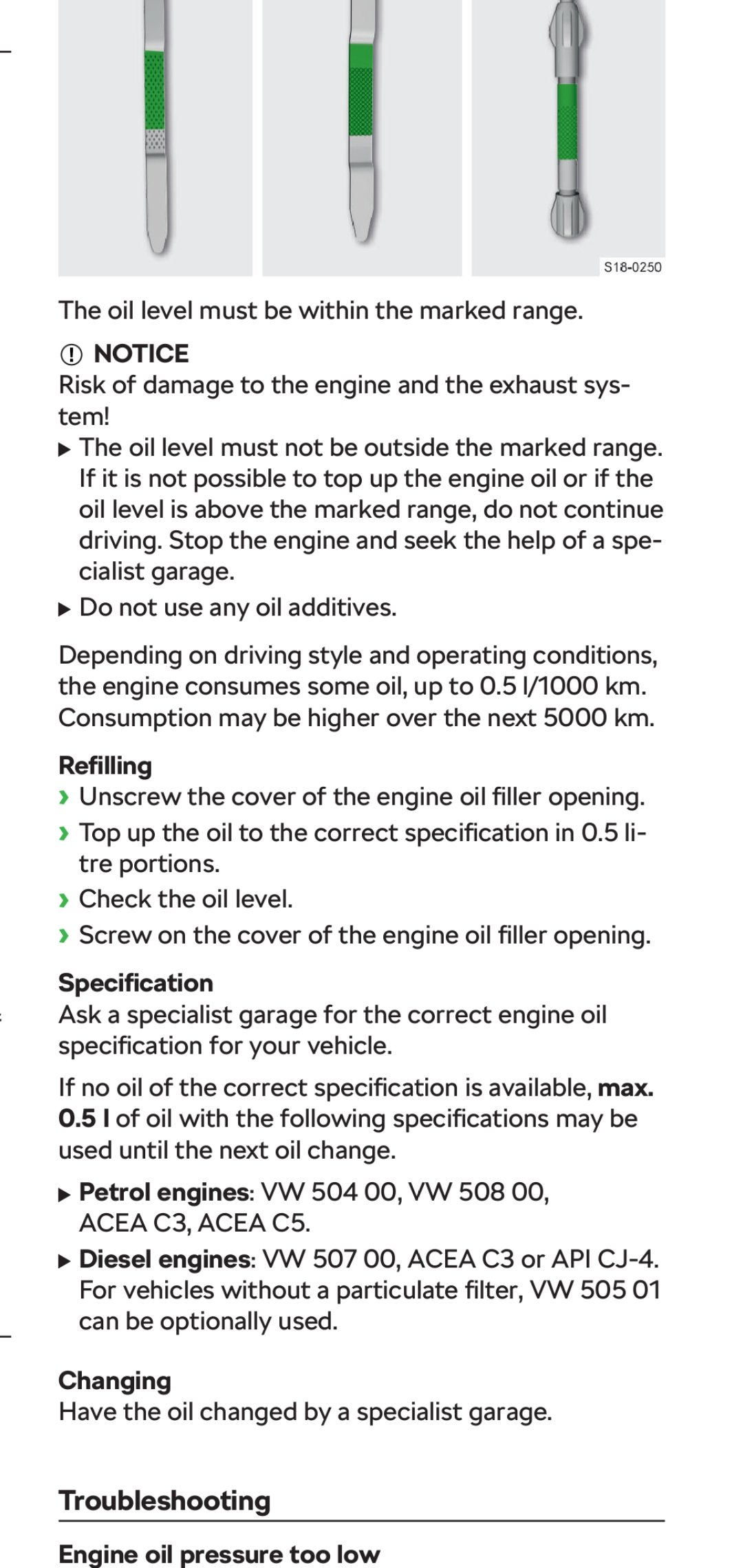

Just went checked my MY20 kodiaq 2.0tsi 190 and there is nothing regarding the use of green dyed Castrol engine oil anywhere I can see (oil cap does have Castrol recommended on it right enough, likely marketing agreement with skoda) .
This is what the owners manual says
Thought the tsi's had 508 00 in them from the factory? Handbook makes it sound like an alternative for topping up only.
