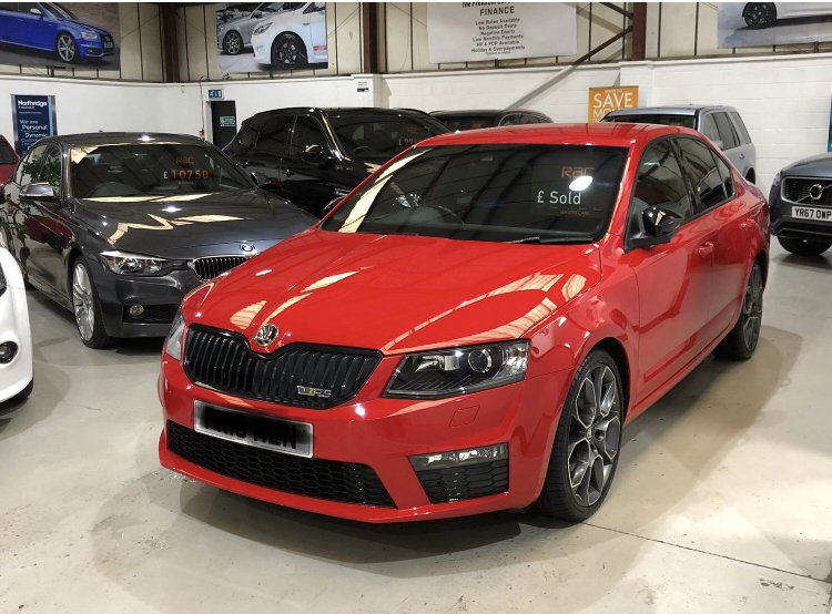

Just to add to this. Hopefully will be picking this up tomorrow.
2016 TDI 4x4 DSG
Very nice.
I would have loved a red one (my Mk1 was red) so you have done well
I do like the red ones, you don't see many of them.
