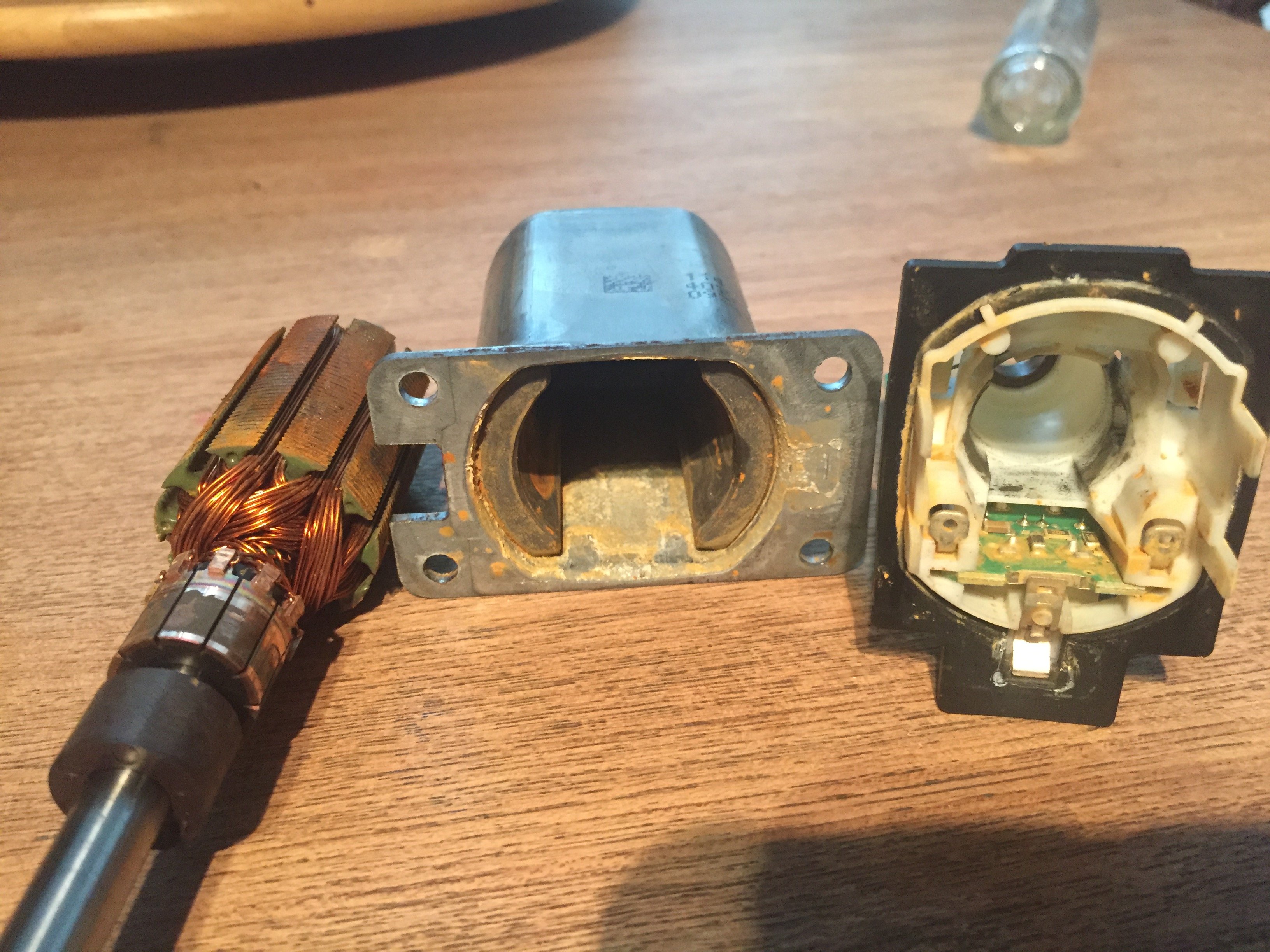

I ripped in to drivers side door and find that the window motor ( and control unit built in) is full of water !
The loom connector is on top and has no waterproof seals in it , so any water that finds its way past an open window runs straight in and screws up these electrics... first indication was  speedo cluster warning lights all failed to light , and car immobiliser activated ..
all windows stopped opening ...
Can get all other windows to work by unplugging  drivers motor...waiting for replacement now...car still not starting.. all fuses  are OK ..battery Fully charged ... VCDS Scan shows lack of power in instruments and CCU ...Chicken and egg situation ...ongoing..
I suggest get your door cards off and waterproof these connectors before you get water in and screw up your electrics..

Thanks for the heads up regarding the door electrics and water ingress, I had to fix my dads Renault Megane (sorry if mentioning another car make offends anyone!) which had a similar problem.

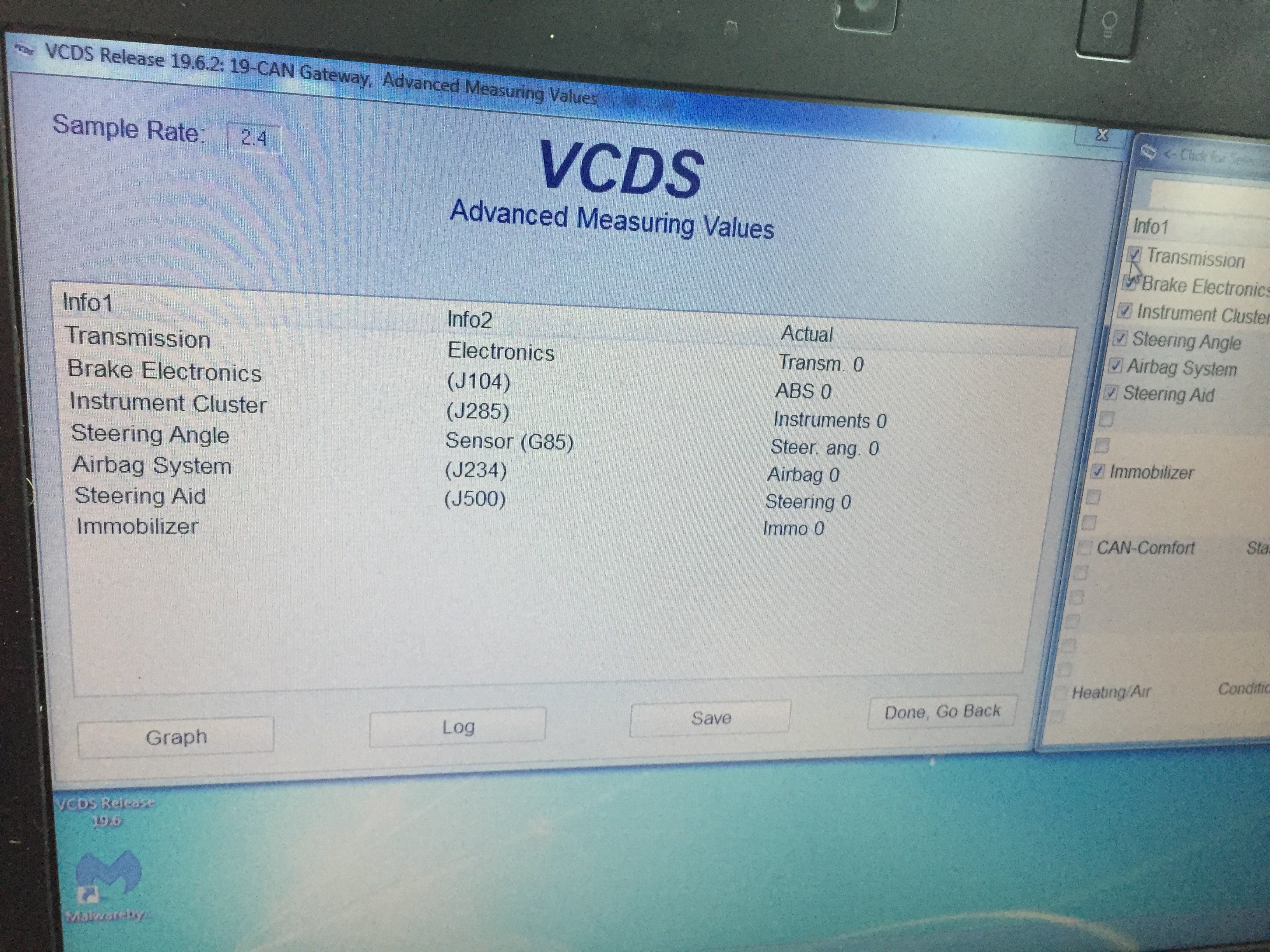

There is a canbus (CCU)unit in my car ...black box size of ECU located hidden behind fuse box ... pull out fabric trim below steering wheel ..there are 3 fuses hidden there and relays ...this is my next line of investigations as VCDS advanced measuring units came up with zeros on many systems:-
                               info2                         Actual
Engine                   electronics              0
Transmision           (Automatic)           0
Brake Electronics    J104                       0
Instrument Cluster  J285                      0
Steering angle          G85                       0
Airbag system           j234                      0
Steering aid               j500                      0
Immobilizer              Immo                    0
I am open to suggestions , gut re-action is pull my CCU unit out. and look for physical damage...burnt or blown components or burnt smell.. or replace that unit..im hoping part numbers are same for DSG car as for manual gearbox ...

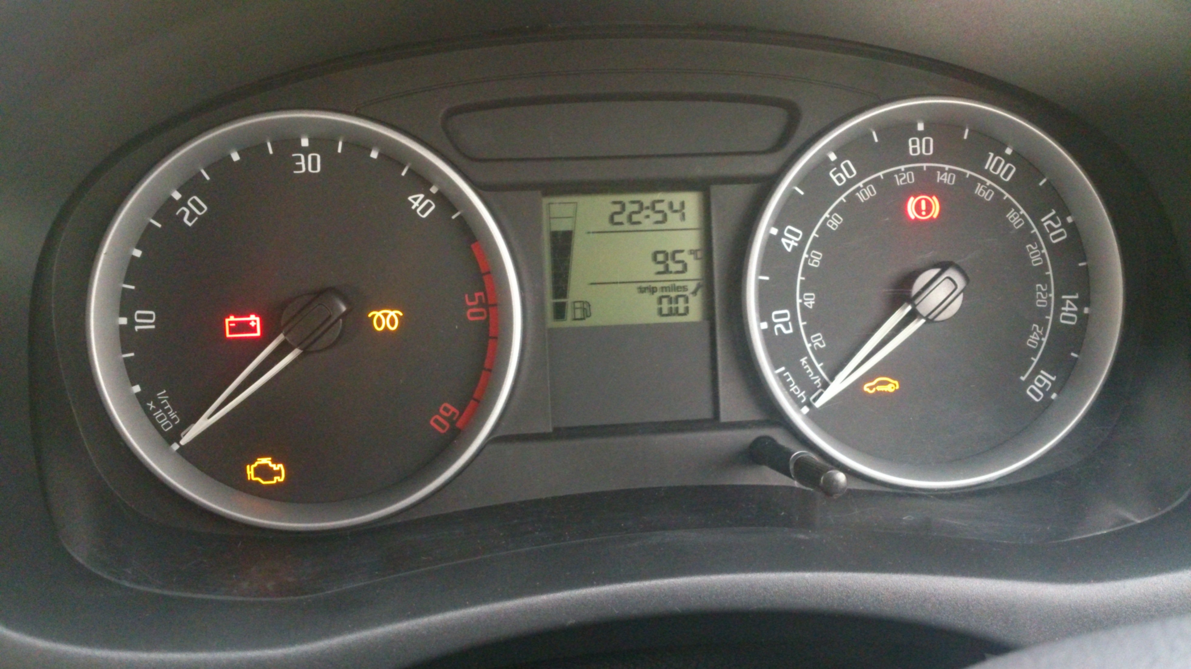

Got in the driving seat, key in ignition and as expected, engine turned over but immediately cut out.
Have included a pic of instrument cluster which shows lights on.
That’s what my current, original dash looks like. They start with immobiliser active but cut out after a second or two. Do you have any way of looking at what codes it’s throwing up with the ignition on? Does the coil light time out as normal or is it flashing?

The coil light does flash but I think that its lit because the immobiliser has activated (same as the other lights) and its impeding its ability to work.

My new door motor arrived , I’ve bought new window switch too as a precaution.... got two spare keys on way , and found a dash with exact part numbers and model numbers for a decent price ..lot less than dash repairs ..may even code it up as a spare for the car if original sparks back to life..( like a spare imobiliser)

Just wish Skoda had invested in waterproof window motor closure for Fabia / Roomster that is fitted to Octavia as standard!
