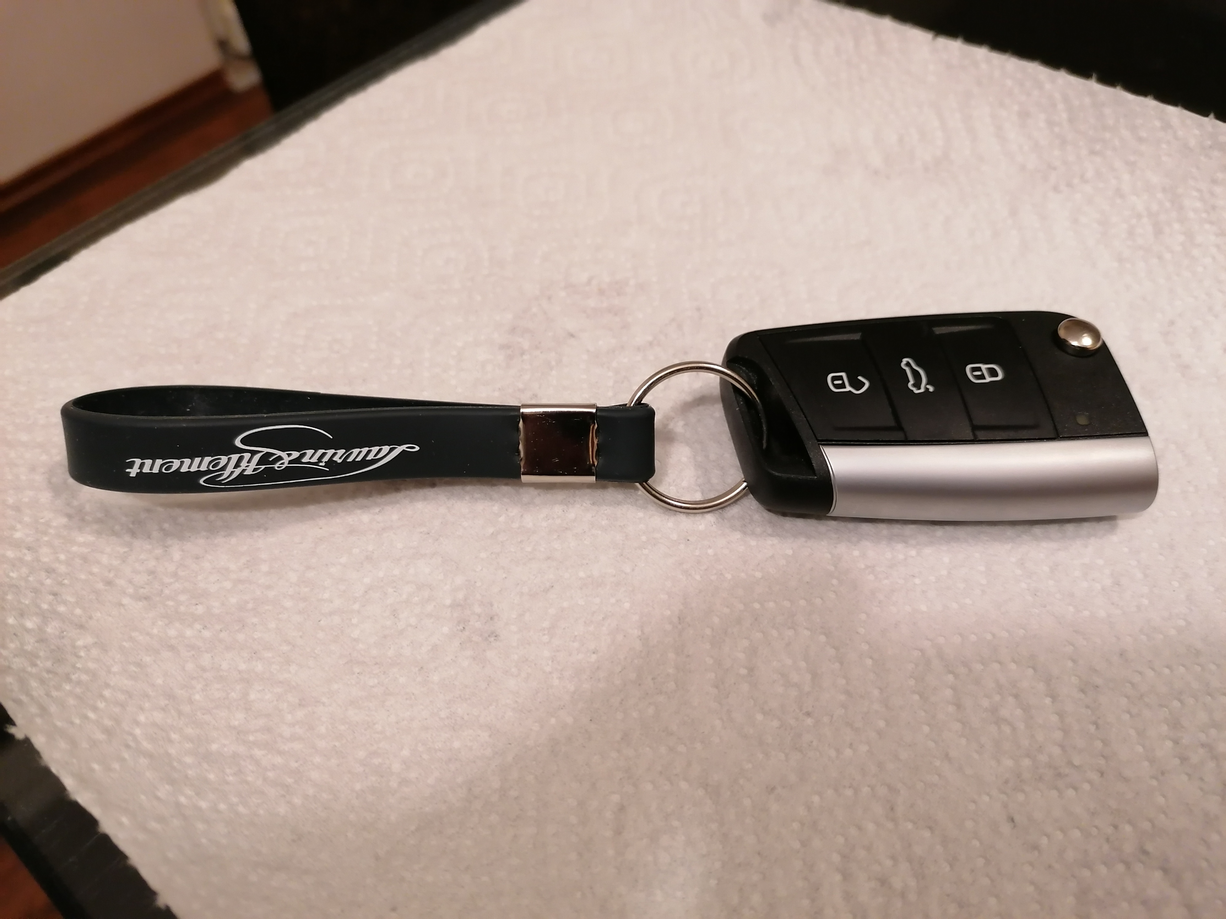

Mine OEM was Panasonic but Duracell that I installed also can't last a year, so in future the most used key fob will go on 6month replacement schedule.
Last I did also in combination with some design upgrade from aliexpress:
