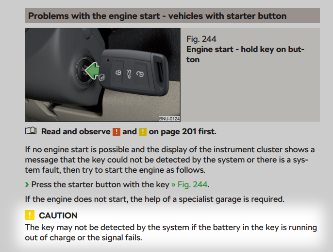

I think the manual is ambiguous on that. As I see it, the suggested expedient is only meant to fix a system fault. A dead keyfob battery is another matter, although the error message is the same. Hence the Caution.
I too have heard of cases when the suggested procedure didn't work, while a new keyfob battery did.

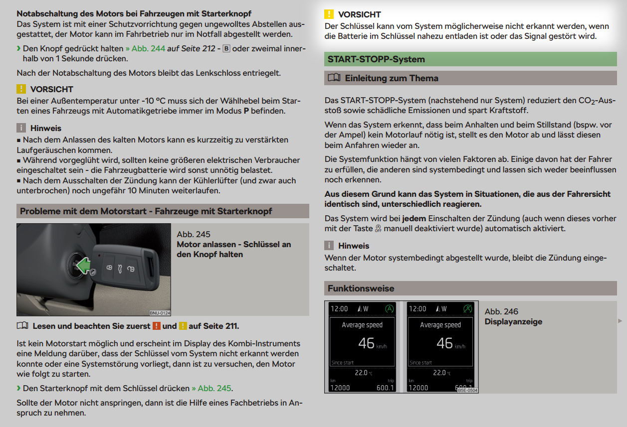

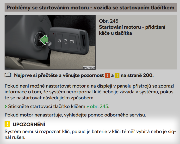

Perhaps we should have paid more attention to the spotlit words below...
It would seem that the suggested expedient is based on marginal conditions (hence "try" resp. "pokuste se", "ist zu versuchen"   :) ) which would explain the different results reported.
Edited by agedbriar
