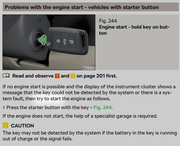

As I said above, her Kessy Golf failed at 18 months and 2700 miles (yes!) from new.   We started using the spare fob but unbelievably that failed the next day as well.  There is a way of getting into the car and starting it with a failed fob, worth knowing....

My karoq key transponder was ok up to this morning but today it just died and I couldn’t start the car in any mentioned way, no response and just a message to say no key detected, fitted a new battery (CR 2025) now back in service 👌 there was no warning at all, i will be keeping a spare battery in the car from now on so I don’t get caught out in the future. This has been my first problem with the car from new.

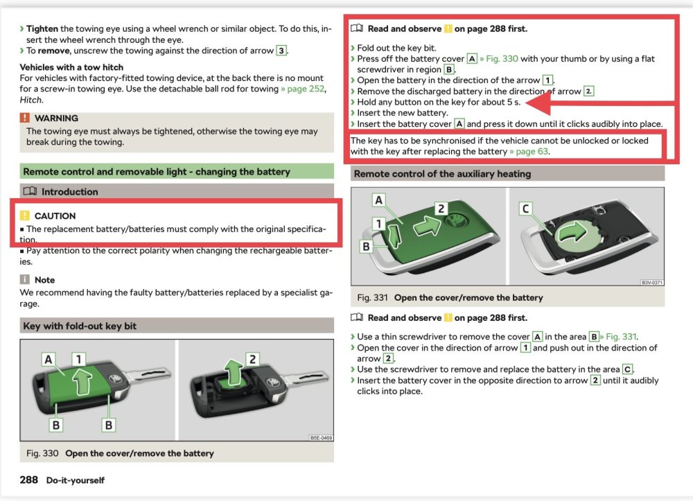

My Aug 2019 Karoq gave me the key battery low warning last week for the first time. Replaced the fob battery going by the book procedure with a new Kodak CR2025 dated 01/2028 and showing 3.3V off load. Didn't work. Tried again, numerous times and eventually it worked. When happy it was ok I did the spare key (actually I use them alternately) with another battery from the same pack. Didn't work; rinse and repeat; no joy. Went to supermarket, got some Energizer brand CR2025s and finally got the spare key to work ok. Next day: main key wouldn't work again. Replaced the new Kodak battery with another new Energizer and it worked. Why the hell are these fobs so fussy? And I wonder if at least some of the fob problems reported above could have been solved with a change of battery?

might be a specific routine when the battery is changed?
