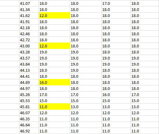

Using VCDS-lite, I found one ABS fault code:
00283 - ABS Wheel Speed Sensor Front Left (G47) 35-00
I also took a drive while recording the speeds of the wheels:
FL showed 1.0 km/h consistently, while the other 3 worked fine.

This made me record wheel speeds, and I found that the LEFT FRONT seems to act a bit strange from time to time – could this be a ’dead spot’?
I have attached some pics/data to illustrate – the FL wheel seems to dip in speed for short amounts of time (which I know it didn’t in real life).
I would love any tips, ideas, suggestions on how to proceed. How can I test this? Test other things? Can I inspect the sensor ring on the car? Clean it? Test wires/connections - how?
I’m somewhat limited in gear but I have VCDS-lite, multimeter and basic tools. I could just take it to the mechanic, but I fear, he’ll just start replacing stuff – ABS modules and stuff. Therefore, I am keen on investigating and narrowing down possible causes/solutions.
