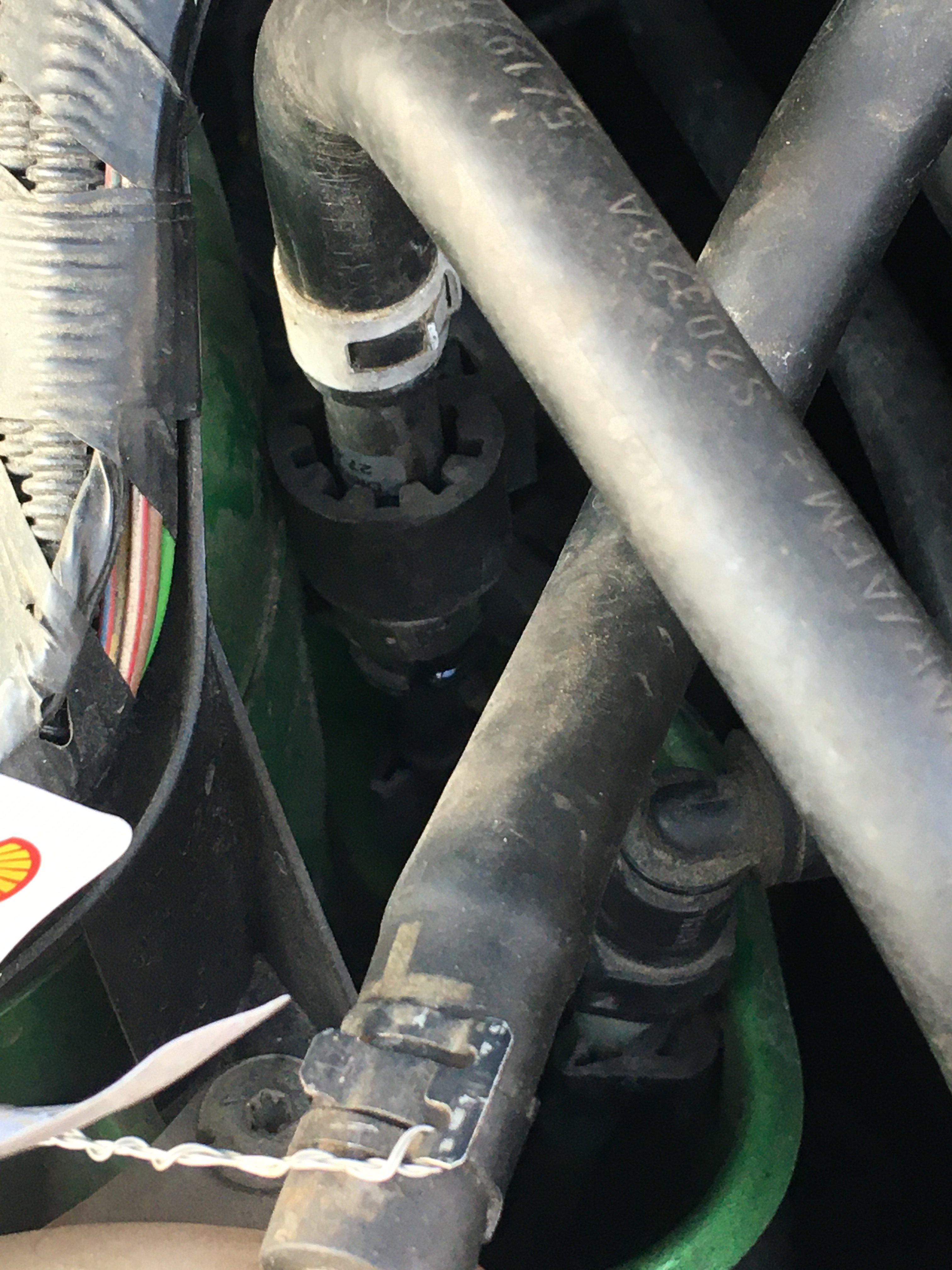

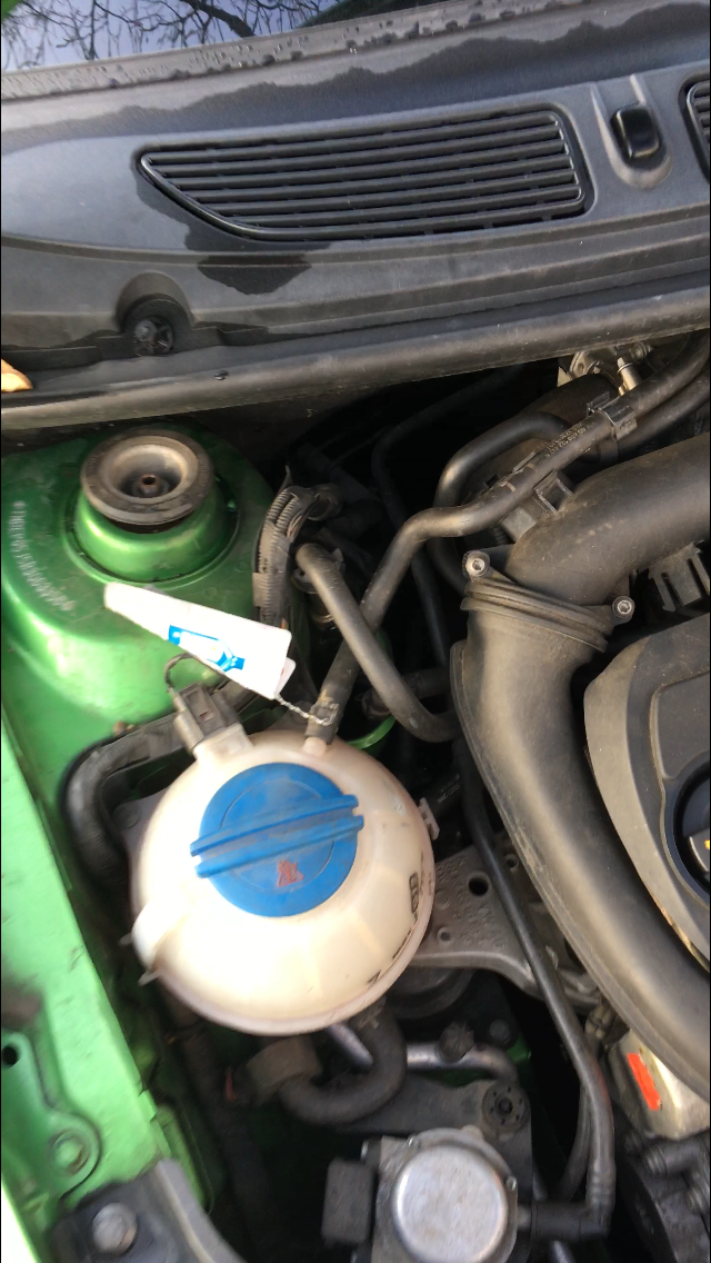

Hello, i used to have the same sound.
Check the fuel  and canister pipes, when enters into the chassis, at the driver's side for you. (My car is LHD)
I solved it putting some foam arround the pipes. Or tell someone to catch it will the sound is present.
Exact same sound ? But the thing is, it's coming from pasangers side.
I finally fixed it. Thank you all for help :)
@Deadly_Spirit
Could you share what you did to fix it and what 'it' was.
It was this thing, the rubber ring was not in  place, where is should be.
Yes, just this pipes, but on my car, the noise was deep inside the pipes housing.
Probably badly explained by me.
