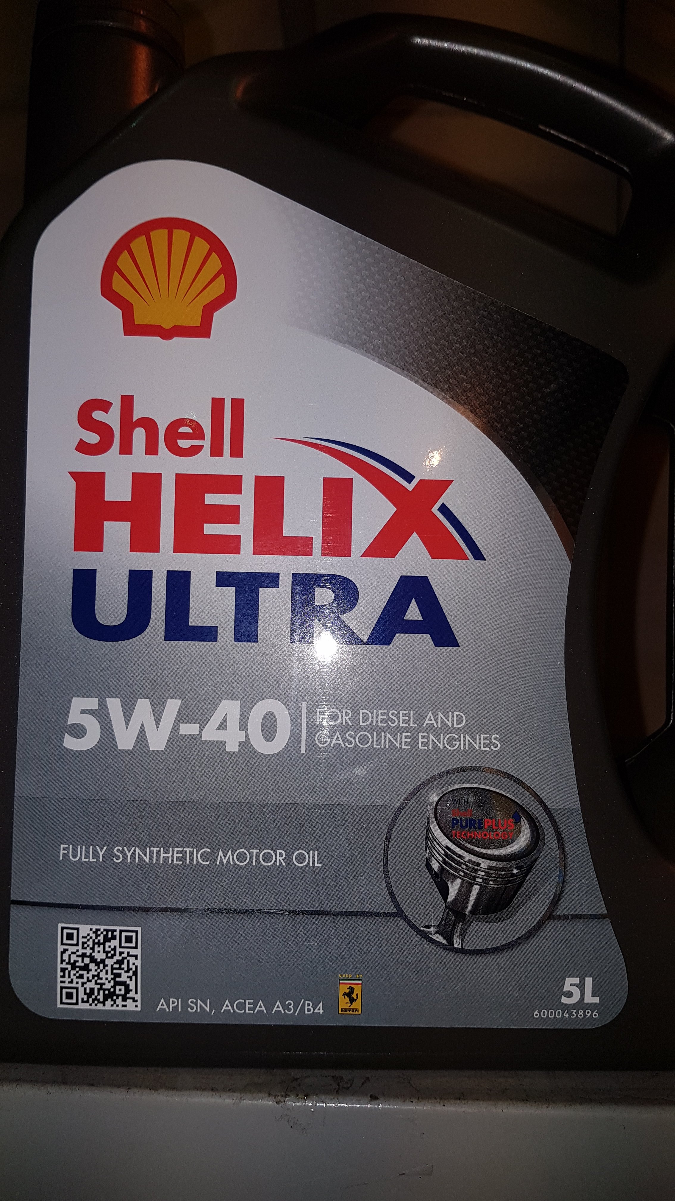

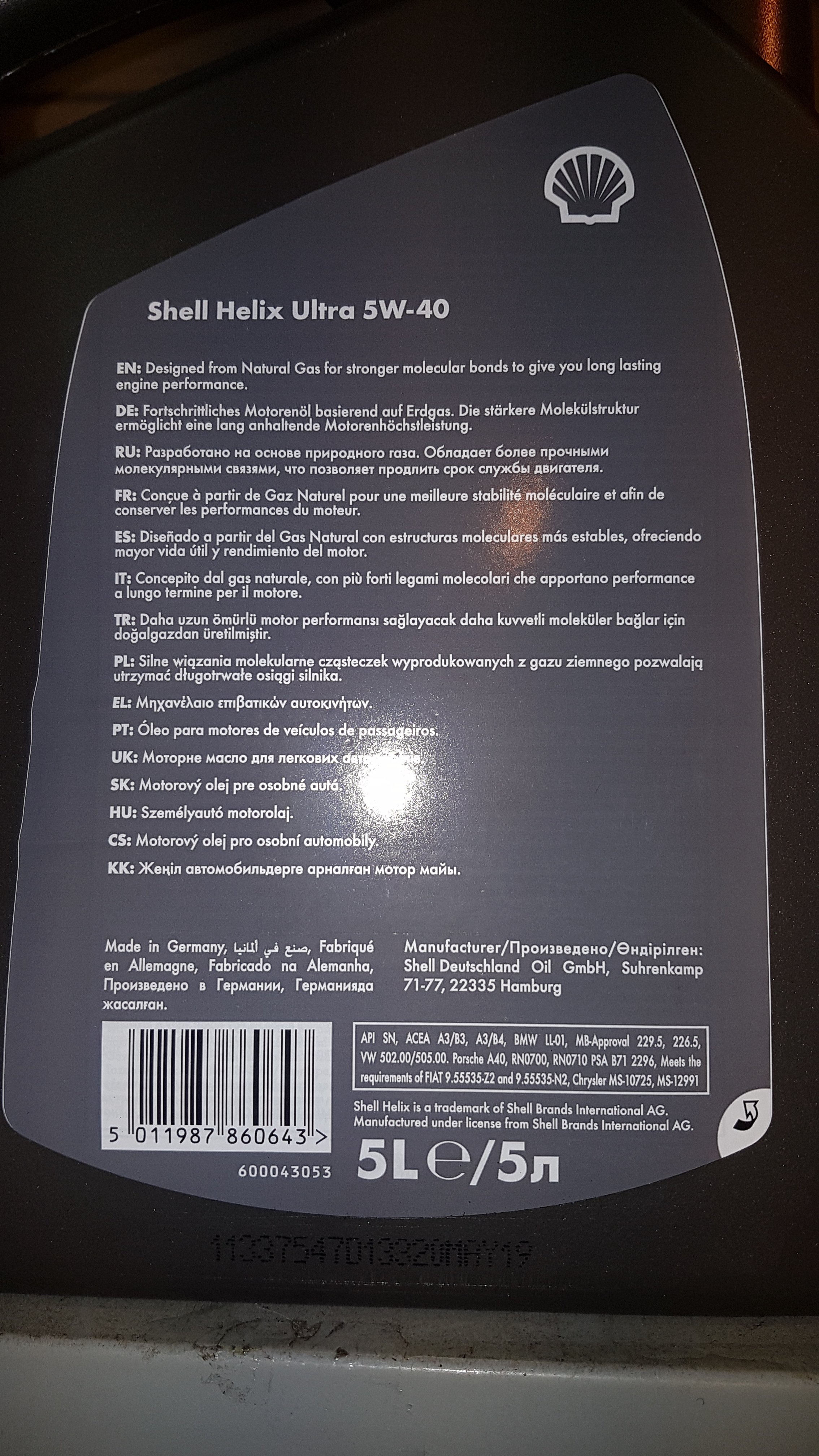

While I think of it.....a while back you advised me on the correct oil type saying it had to conform to VW 502 standard. I checked the Shell Helix I bought and it does comply.
Thanks for the heads up and advice !

Gerard2071 looking at your photos i see your using 5w_40 I was Halfords recently getting oil for my 11 plate fabia vrs the guy recommend mobile 5w_30 excuse the ignorance will it make any difference haven't put it in yet don't know what oil is already in just a top up until a service oil sitting at half way in the hatch when cold
Hi Madvlad65,
Roottootemoot has previously stated to me that the oil needs to conform to VW502 standards. I think I remember he said 5w30 also, but maybe you should check direct with him.
Failing that, I'm sure a Google search will find the correct oil grade, or some suppliers offer suggested oils based on your car details/reg.
I would check the correct grade yourself, although I bought mine following a reg check on Euro Car Parts so ended up 5w40.
Good luck....
