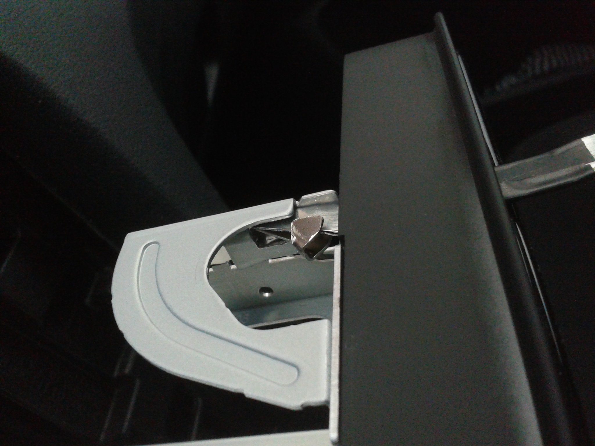

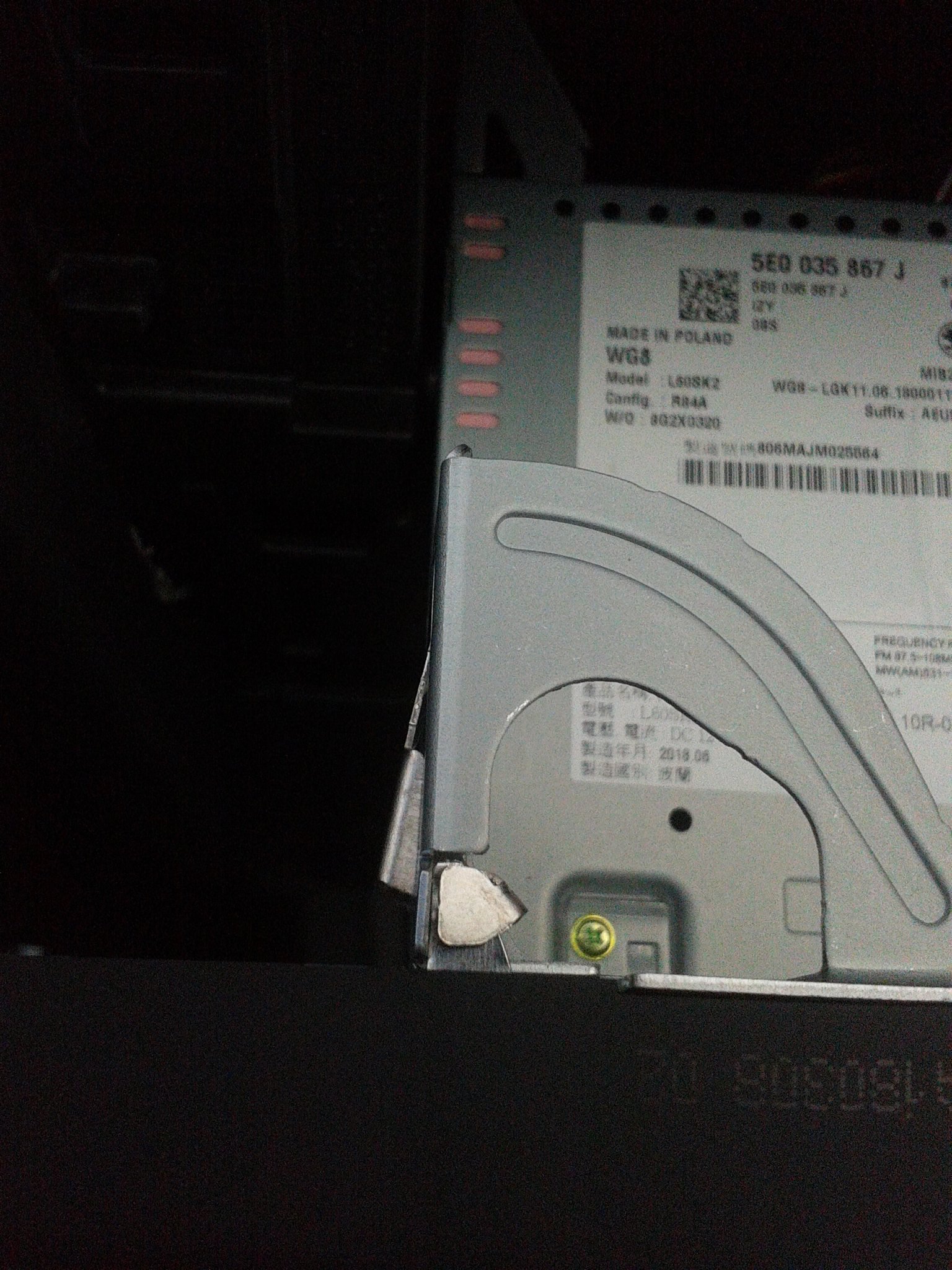

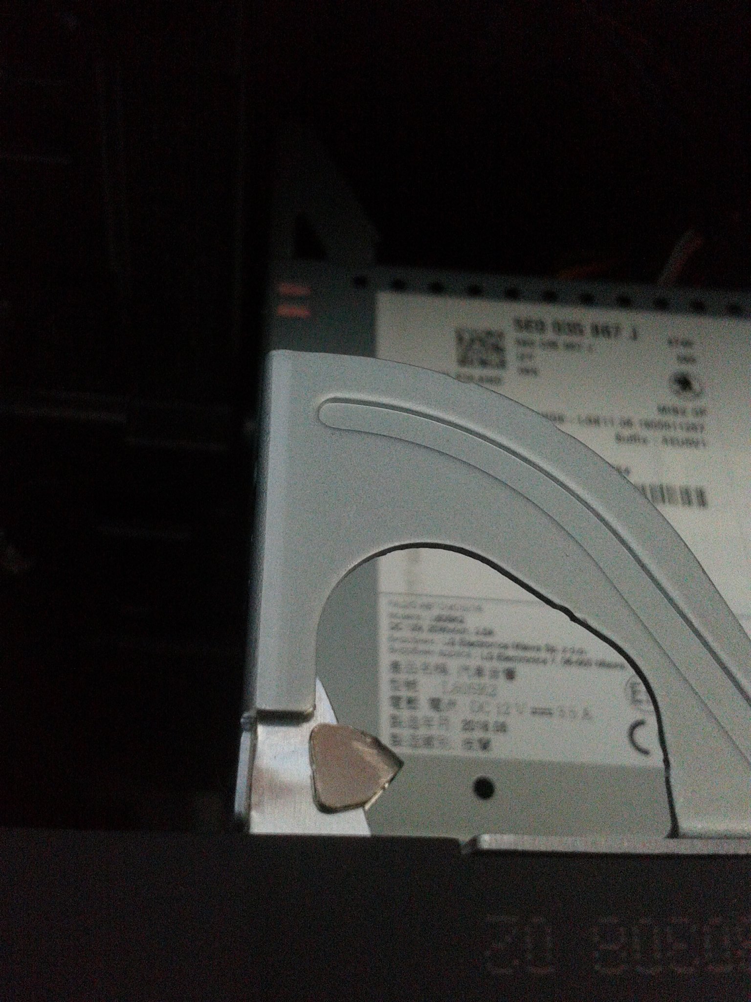

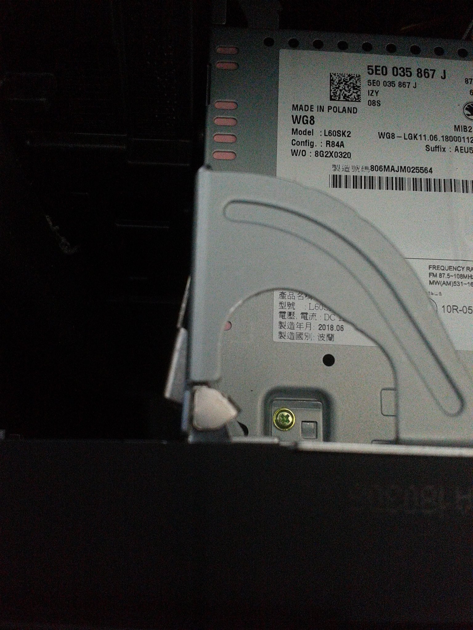

I had mine out and took pics.  Hope they might be helpful....
 you can see the little clips that have to be pushed toward the outside for the unit to unhook and slide out.  easy once you get the idea.
You may need to reach around the back to free the harness to give you more wriggle room (mine only came out a short distance) - drop the glovebox for access.
Watch your hands though, there's some sharp edges back there. 🤕
