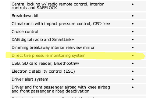

That's what I was expecting  - and indeed what I have now -  on my 2013MY 1.4TSi Estate SE -  But reading the spec from the build tool on the Skoda websiste for a new Octavia estate  I see  "Direct Tire Monitoring System"   which seems to imply the opposite.
"Indirect" = uses ABS sensors and wheel diameter/vibration spectral response etc
"Direct" = sensors?
Are those answering referring to their own vehicles or specifically the 2019 verison

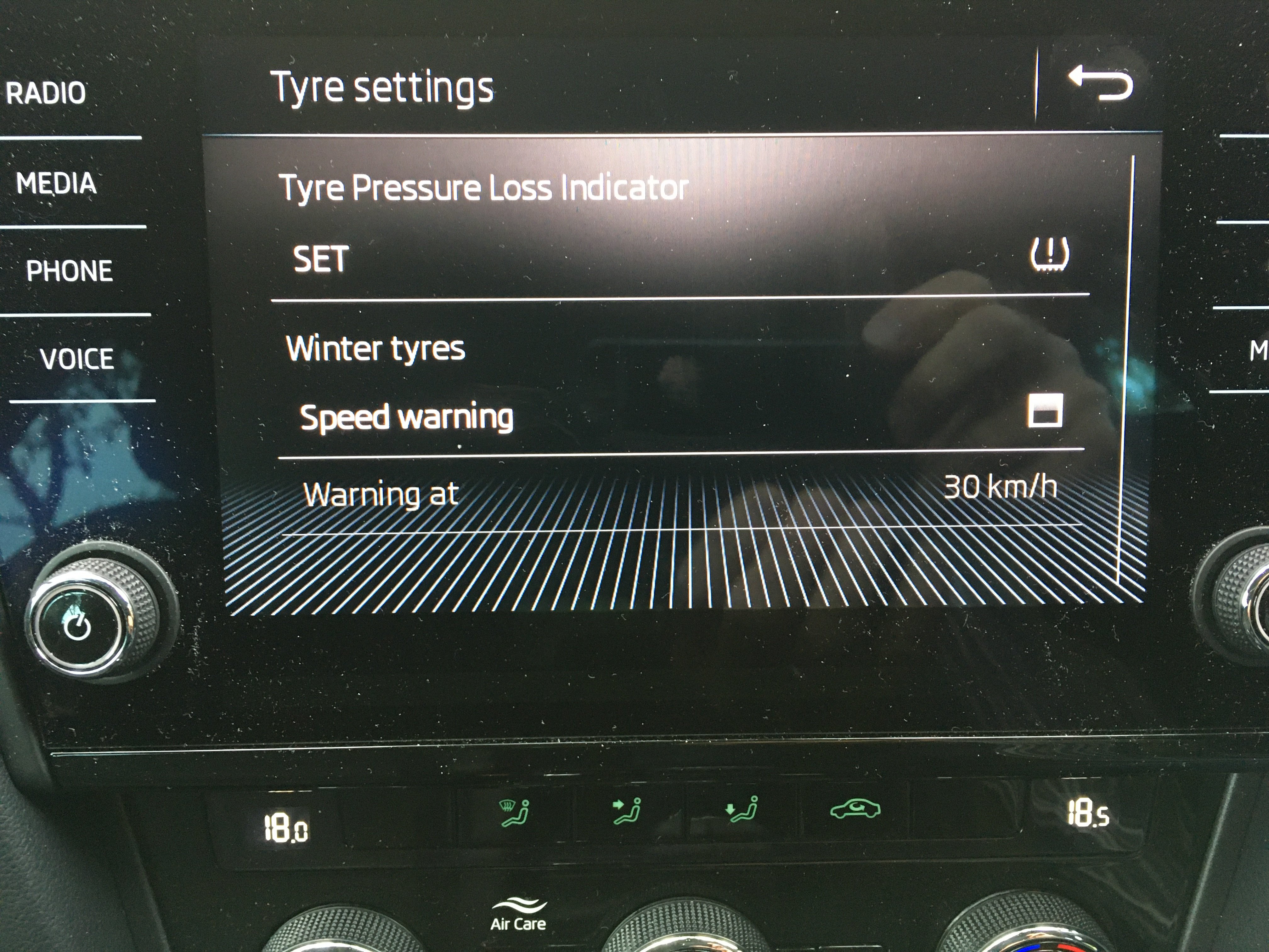

@Llwyngwernog you seem to drive the very car I hope to buy, does it have a "set pressures?"  in the settings
NESskod:
The Octavia (including the FL) has the TPMS using the ABS sensors as everyone says, so no sensor in each wheel. I have the 2020 modelyear and yes, it has the ”set pressures” in the infotainment display.
Hi can confirm it has SET PRESSURES in the infotainment display.

Thanks all - I have no idea why the spec says "direct TPMS" but it is clearly not!
