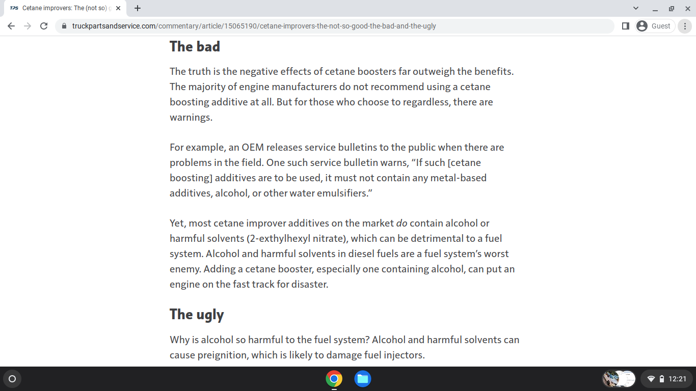

Take Care with Cetane Boosters / Improvers.
'Just say no!'.

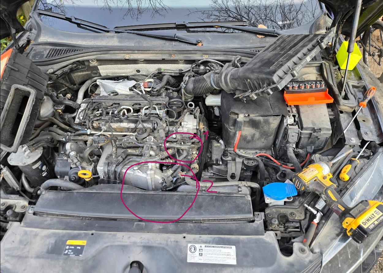

I had to remove alot of stuff. The part is around nr1 in the drawing, and i had to remove alot of stuff around nr2. I did remove almost everything.
But then i stripped a bolt/screw on  the last part (just a hose or smth) and i had to put everything back again. I will try again once the weather gets a bit warmer.. Hittin ur knuckles in -10 is not funny :D
You got the same problem?
