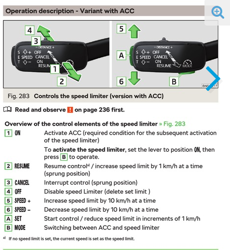

Do you have the Speed Limiter button on the stalk (B) in the image below from the manual ?
It is different in my manual to that. Mine says to use a steering wheel front assist button rather than the button B.
