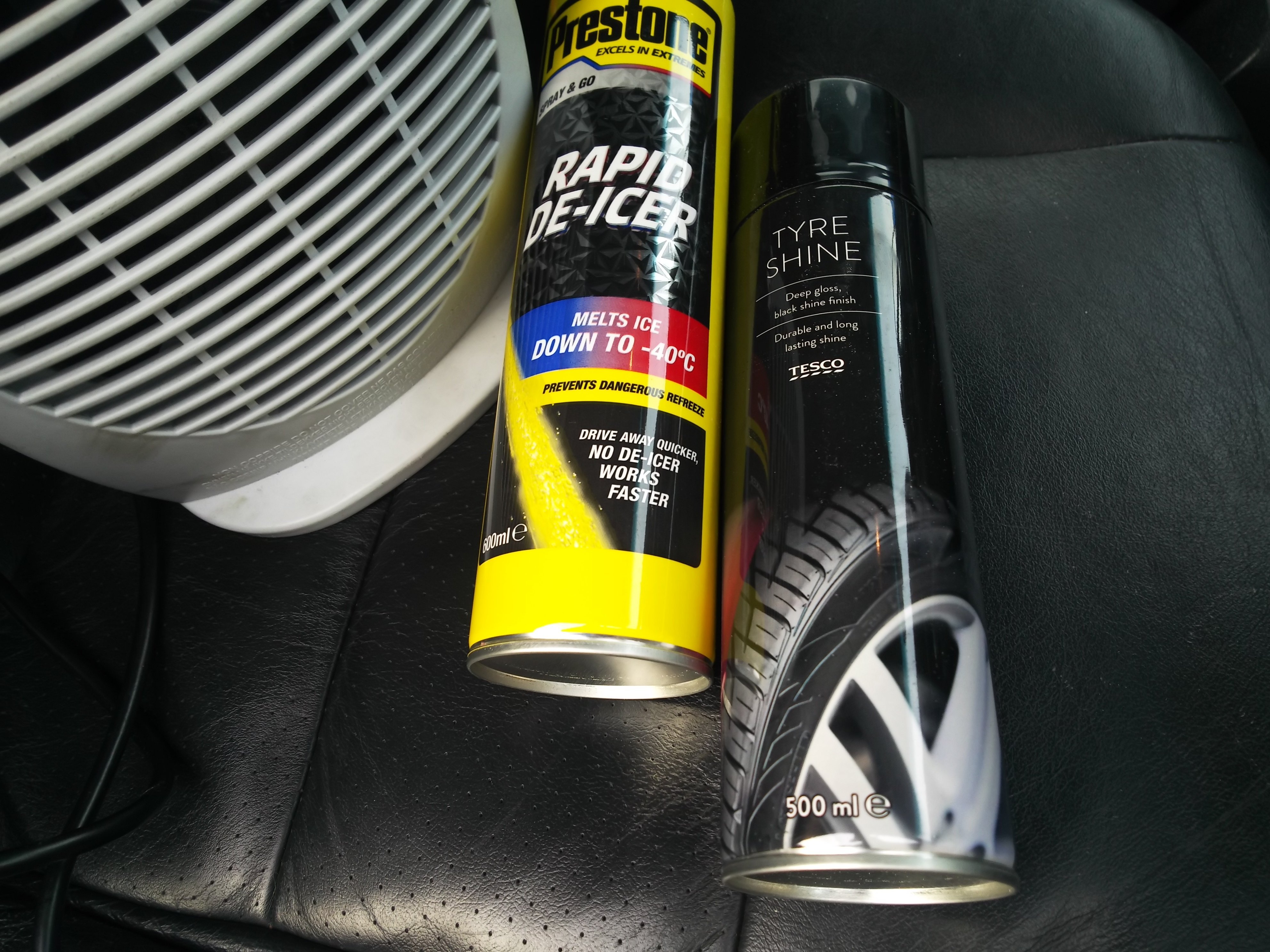

If it is just de-misting and not defrosting and ice stopping the side windows going down have you tried opening the windows and put the front screen fan speed to full?
De-humidifiers in car, no wet mats etc etc.
Fog-X in the inside glass, and then very well cleaned.

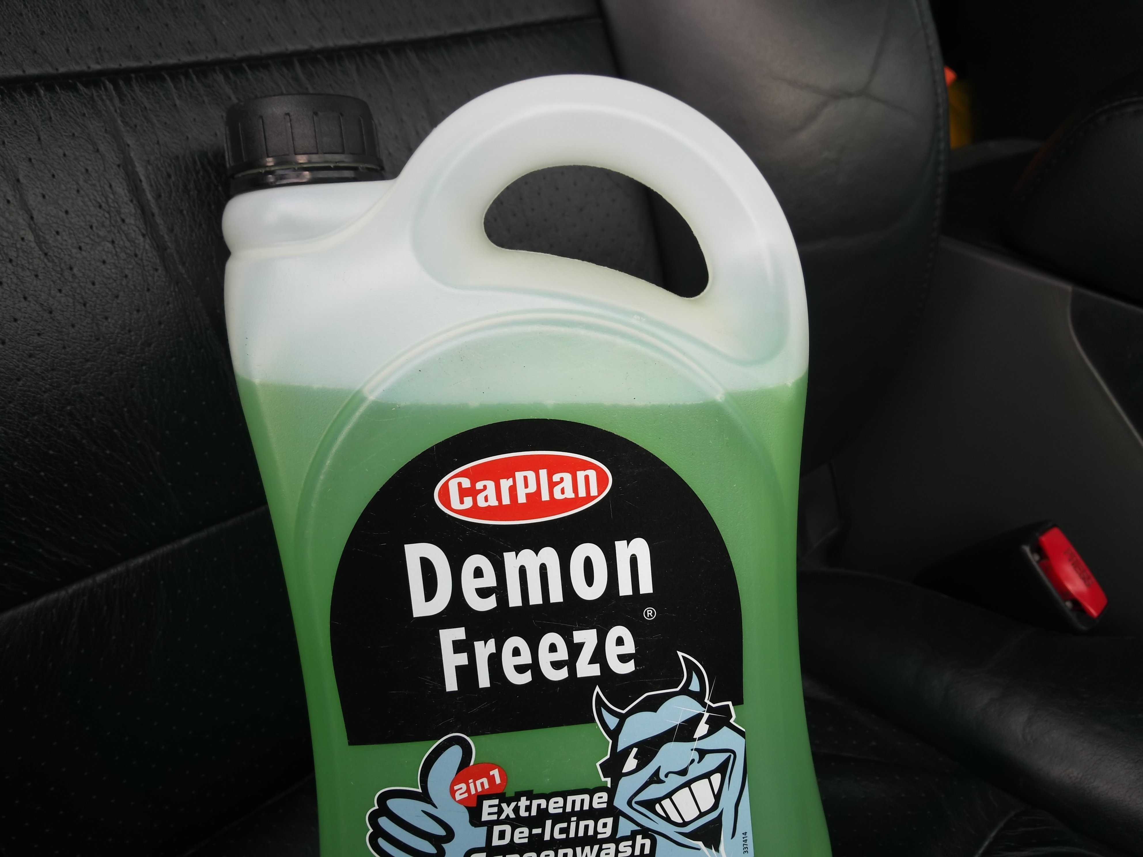

That is brilliant were it really is not that cold and there is just ice on the windows but the air temp is on the up.
@ -6 and lower its not that much cope.
Cold can be when there is no water coming out the cold tap.
