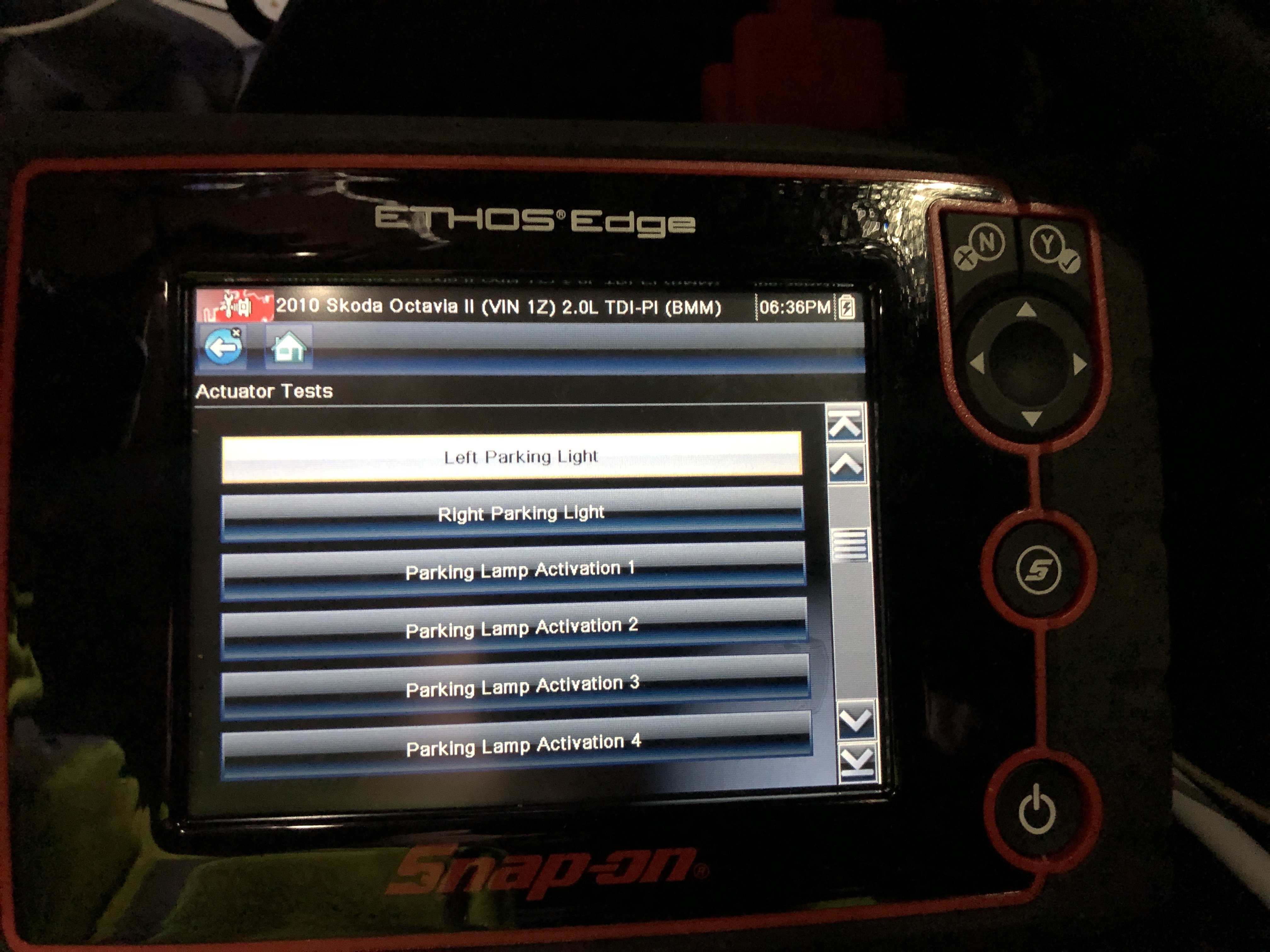

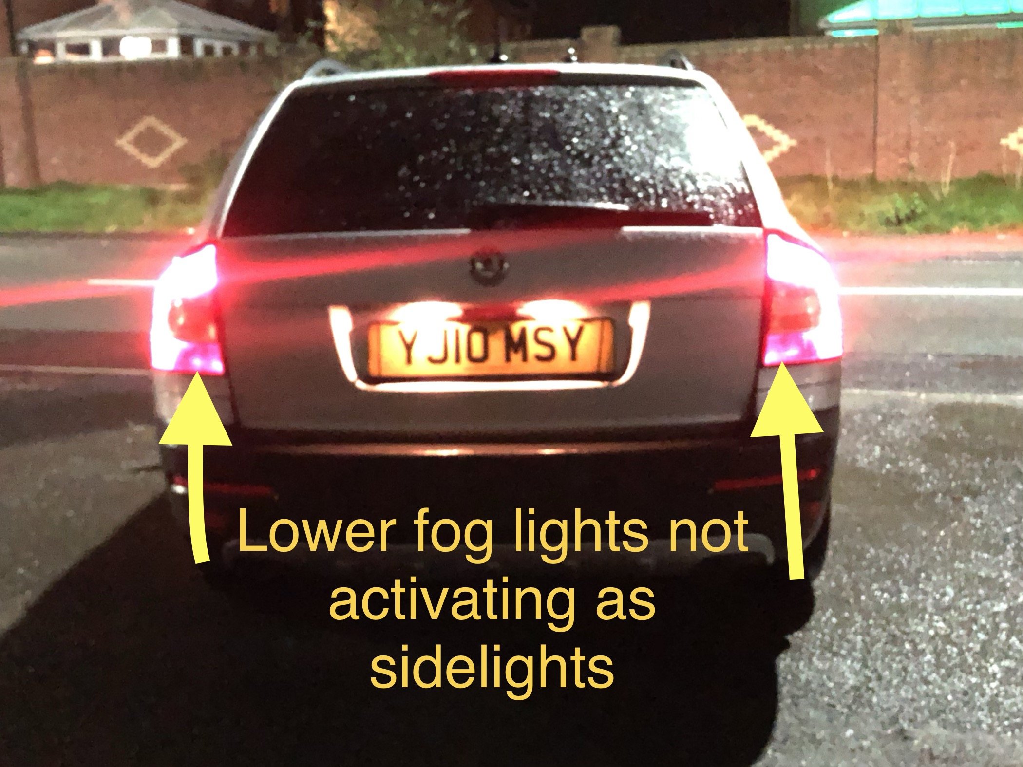

Ā I’ve had a disaster... using my snap on Ethos Edge diagnostic machine on very latest software I’ve killed part of my rear side lights.
Ā While under the Central Electronics section I performed parking light activation tests numbered 1too 9
ā€œparking lamp activation 1ā€
ā€œparking lamp activation 2ā€ etc etc etc and since doing this the rear lower side lights don’t work and also only driver side reverse light works, it’s NOT the bulbs as I’ve tested them and it DOESNT show as bulb failure on the dash... I can’t find how to change them back to full rear side lights. Below is a photo of how they are now. Does anyone no what I need to do?? My diagnostic machine as brilliant (butĀ obviously not as good as VAG)Ā and I even managed to activate my front fog lights as cornering lights months ago. I can even code keys using my machine.Ā
Ā I had an idea... I copied the settings from a vehicle on the yard another Octavia 2 scout 2013 And the same thing has happened to that. It will let me input codes for adaption channels but I don’t no what code or channel to input to sort this problem. Any help or advice is greatly greatly appreciated.Ā

Think I may of somehow changed country settings... anybody no how to change it back?? I can input long code in the centralĀ electronics but not sure what the code for over here would be (UK) Ā
There aren't any county settings in the BCM (Body Control Module) which is responsible for controlling the lighting. The only thing I can think of is that either byte 18 in the BCMĀ coding has been messed with or the underlying lighting configuration in the BCM EEPROM has been changed.

Ok so I did the hard re set but no joy... wondering if it’s a setting I changed as I’ve noticed when I open the boot with engine NOT on and only sidelights on as soon as boot opens the rest go off as soon as I close it they come back on, got a video hereĀ
