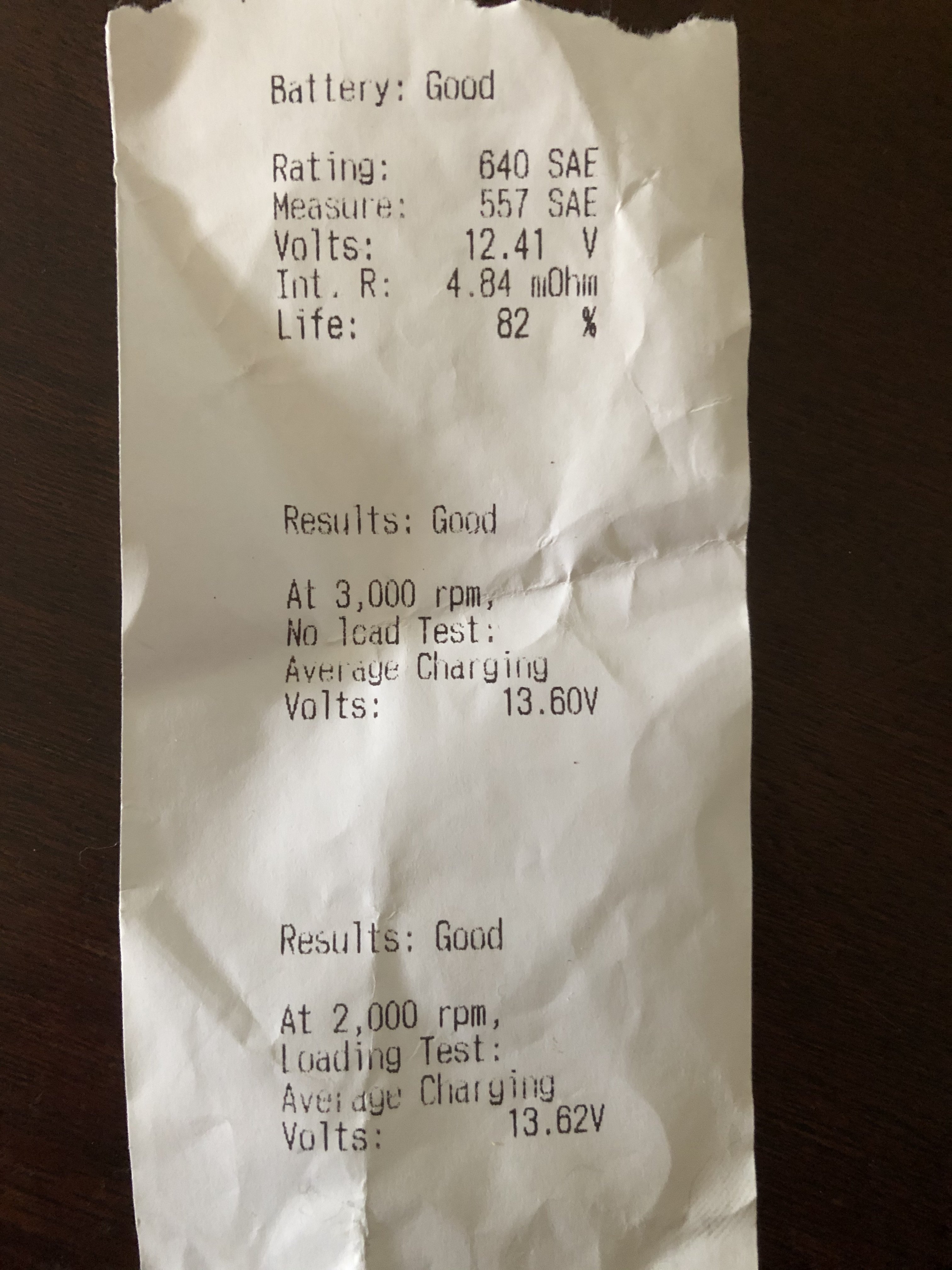

Just to round this off the battery and alternator were tested this morning and found to be in good order.
Not sure about the Life: 82% is that expired or left do you think?
R-
Edited by RogerBest
  • Sponsor
I would interpret that as "life left".
