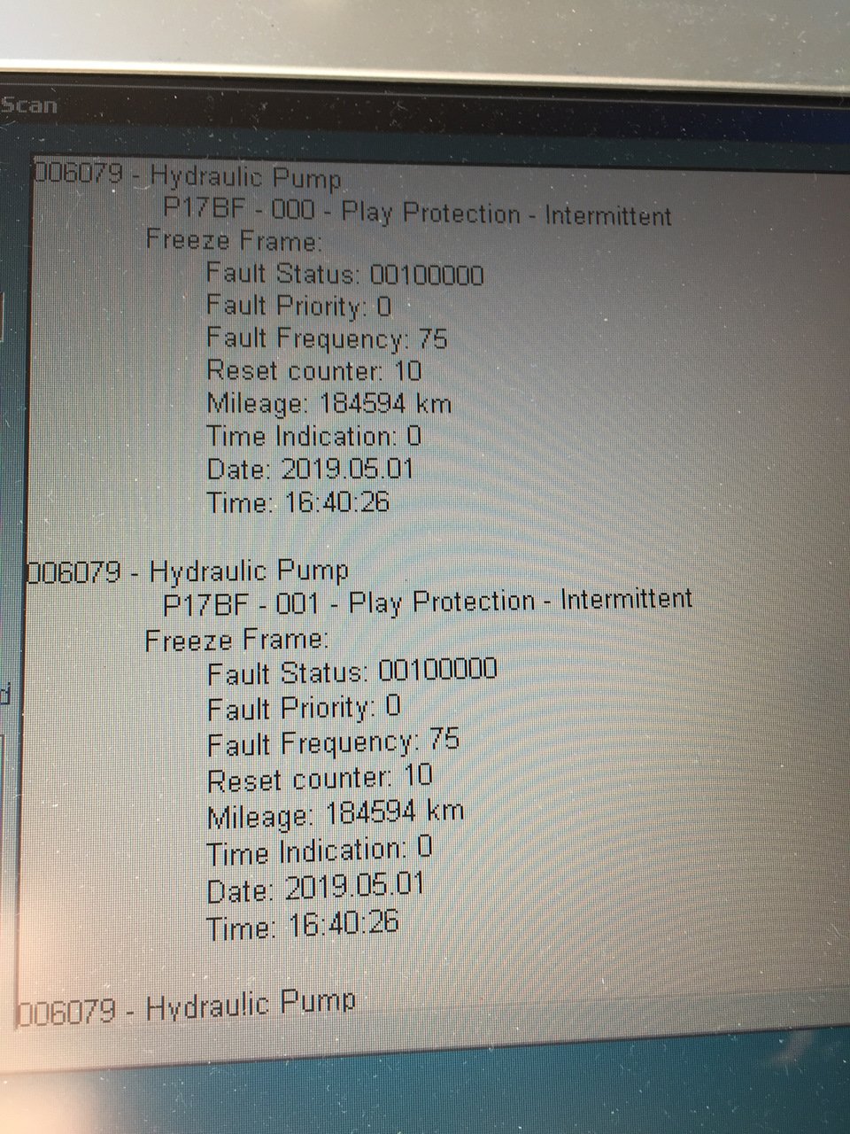

  • Hi this was me.    The symptoms: Gear indicator on my wife's Fabia vRS would start flashing after exactly 10 minutes it would still drive but I read it's time was coming...   The c

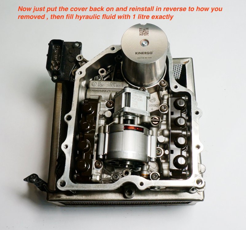

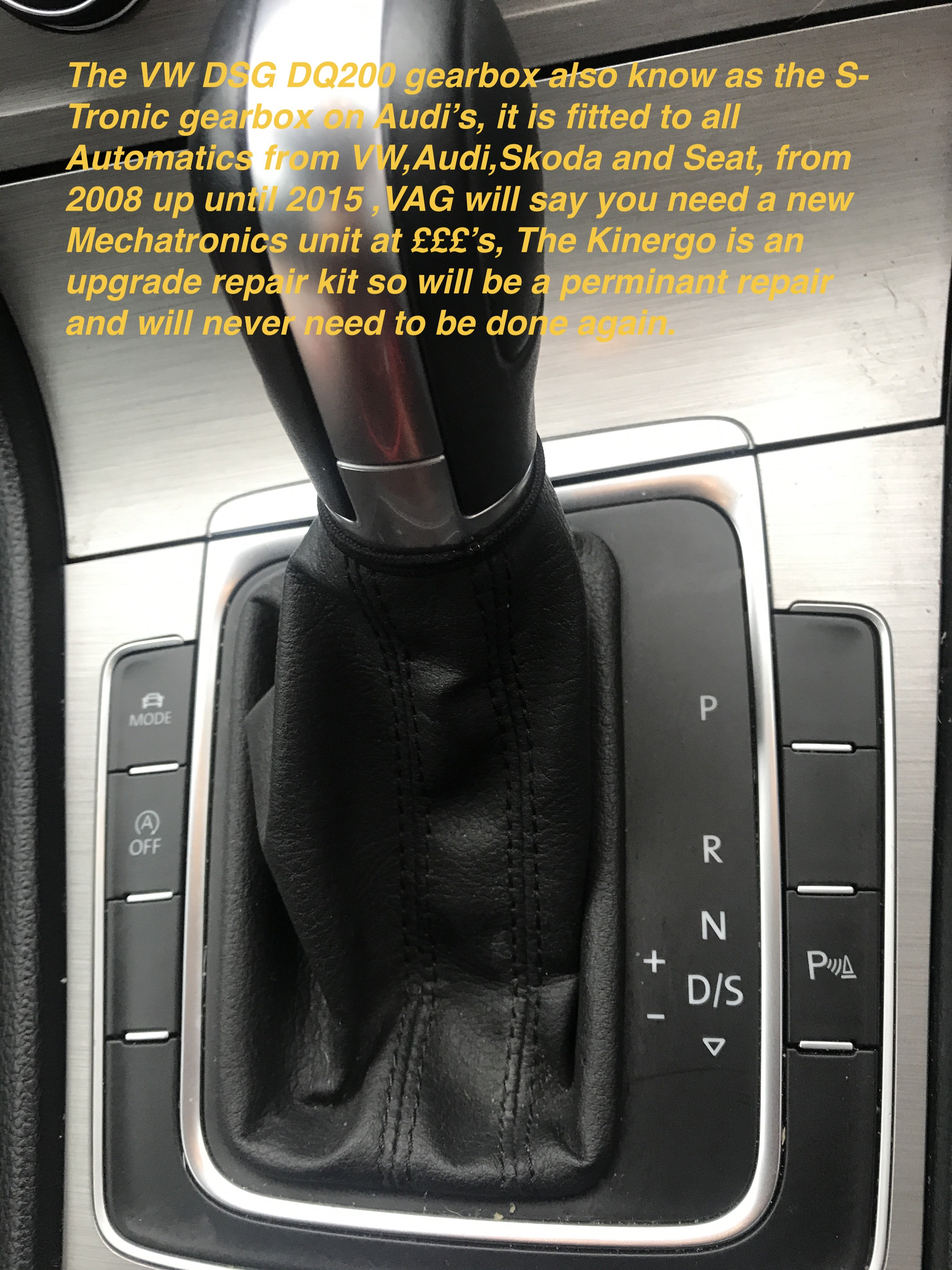

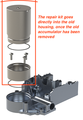

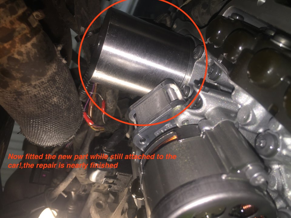

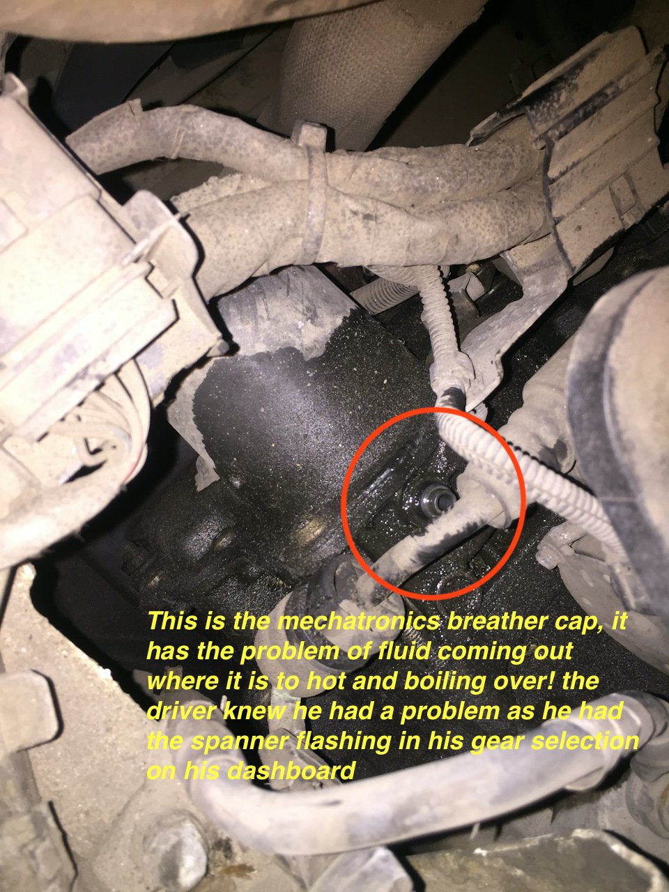

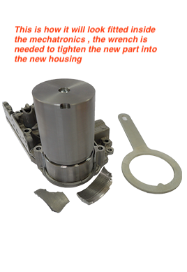

Hi Guys I have a unit that you can do in matter of around 2 hours that permenatly repairs this fault that will happen in EVERY DQ200 Mechatronics gearbox!!
If you have the error code P189C and or P17BF ,, as the same codes in your video ,, you will lose drive , some times the car will still drive in certain gears, there will also sometimes be a spanner flashing in the gear selected on dashboard display,  well I have now fixed numerous cars,   I have the repair kits available here in the UK and sell then for £230 or to members here £200 , It is possible to repair your car while the mechatronics is still attached to your car so is very easy to do,
although some people are scared or dubious of this I offer to do the complete job for £500 dependant on where about in the uk you are !   I have full fitting instructions
Please see my pictures,

These gearboxes are certainly faulty up to 2015!  I can say that as I have just repaired a mk7 golf DSG with this gearbox,   As far as main stealers go, when people tae the car back to them with faulty mechatronics unit they will not even consider to repair it, they will only say that is needs a complete new mechatronics!  VW wanted to charge a guy £2800 for this and luckily he found me!   I repaired his car for £500 and the part I use is a permanent repair better then it ever was ,, and the beauty is that even though the housing was cracked , this part has its own housing that fits straight inside the existing mechatronics,
The newer the cars the less quality in parts I am finding these days,,  nothing seems to last like it used to

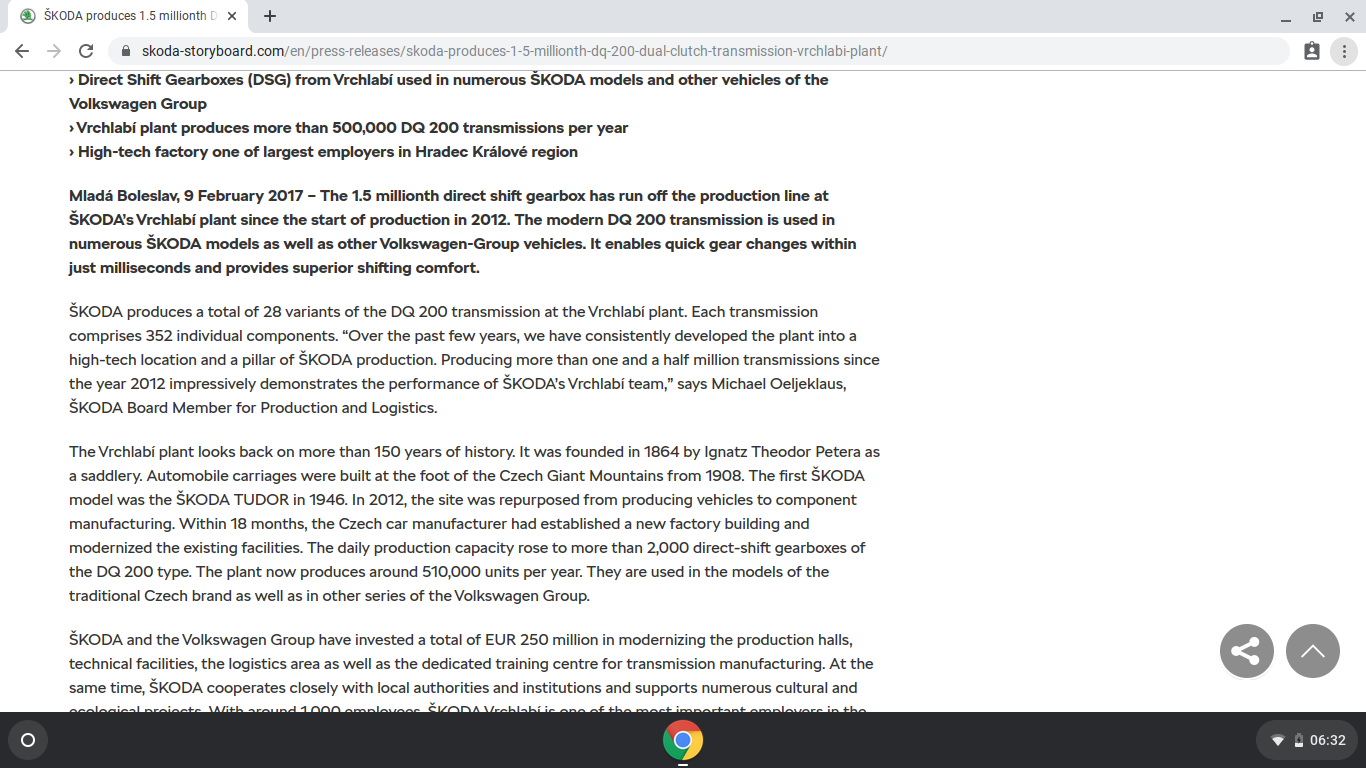

Skoda are producing DQ200's for more than 28 applications.  They were for use with 75, 86, 95, 105,110, 115, 122,130, 148,150,160, 180 & 192 ps engines.

The repair I do to them is the hydraulic pump as the alloy housing cracks with hot and cold pressure and needs to be attended to. It stops the pressure and in turn the function cannot physically push the gear clutches to get the car into gear.

That Kinergo repair kit looks like a much cheaper and easier fix than that shown in the OP's video.  :)
I wonder when the housing with the reinforcing ribs (shown in the OP's vid) started getting fitted in the factory?

Alesypalsy has invested significant time in designing and producing a good engineering solution, he probably subs out the manufacture, why should anyone care if he makes them or has them made by a specialist?
With an inherent weakness like that in the casting I think its reasonable to say that it will affect all vehicles fitted with that part at some time unless they are never driven, the numbers of failures may be low at present, they may remain low but if you were the victim of one you would be applauding Alesypalsy for saving you from spending thousands with VAG and not criticising him.

Thank you for the kind words!  very pleasant of you ,
I will let you know that the design is not mine though , I came across this repair kit after purchasing a mk6 golf and 30 mins down the road finding out it had the common fault!
So after being unable and unwilling to afford to be able to comprehend paying ££££'s for a repair I searched out high and low and found these kits that are actually made in Russia , and these fellows certainly know how to deal with these cars that for sure,
I have done the repair on quite a few cars since! and I also have sold quite a few units to people who have been most satisfied and very very happy with the instructions I gave them to fit themselves, I can supply a link to my ebay sale if allowed?
So I really am only trying to help people out here in being able to offer a cheap fix,  I wish I had come across a thread like this when I had the problem ,  and I have since found that it is a massively common problem affecting a lot more cars then you would believe which leads me to honestly believe it will affect ever one of these gearboxes. I have had a lot of these cars now and already know to expect the fix to have either been done or will need to be done in the future.
