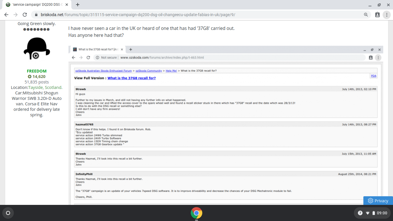

http://briskoda.net/forums/topic/315115-service-campaign-dq200-dsg-oil-changeecu-update-fabias-in-uk
http://briskoda.net/forums/topic/444027-201718-dq200-dsg-34f7-service-campaign-any-further-issues

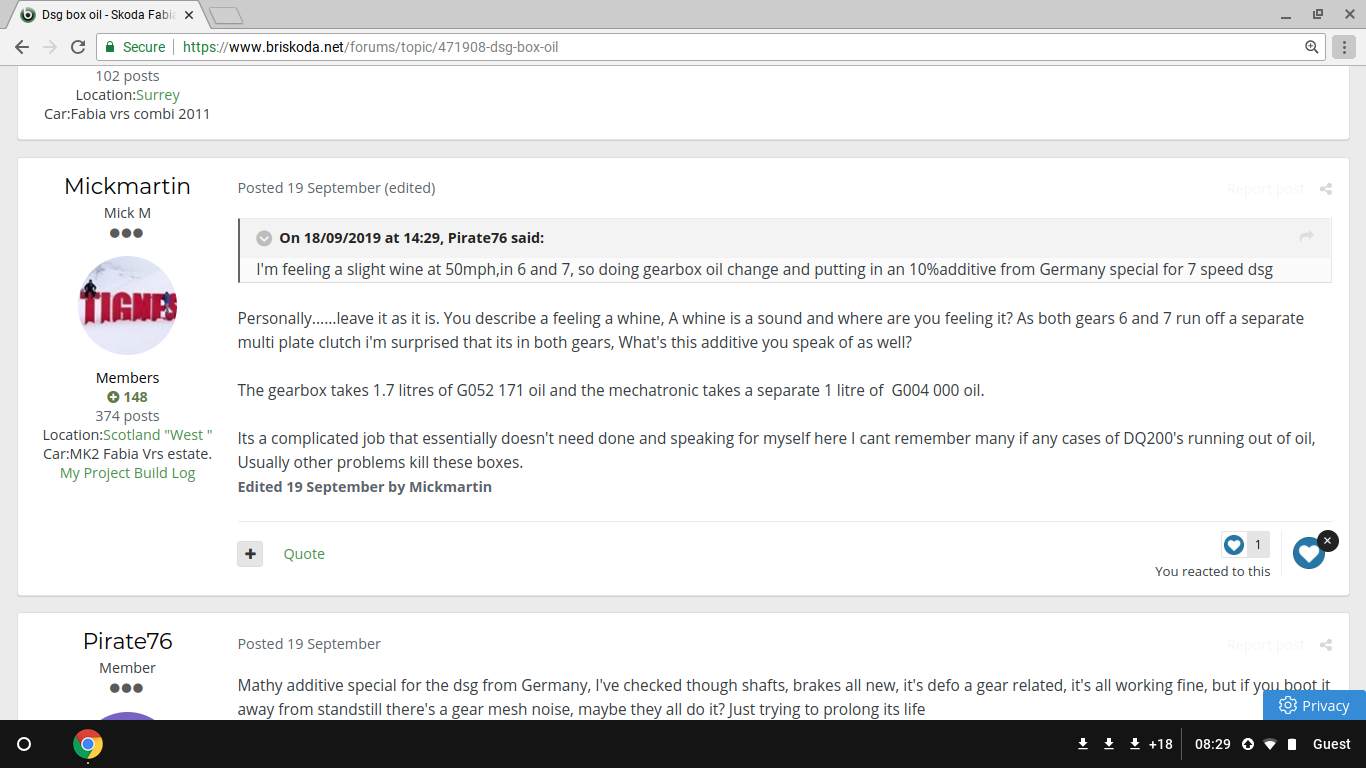

http://briskoda.net/forums/topic/471908-dsg-box-oil
2 different oils for a DQ200, in the box and for the MCU.

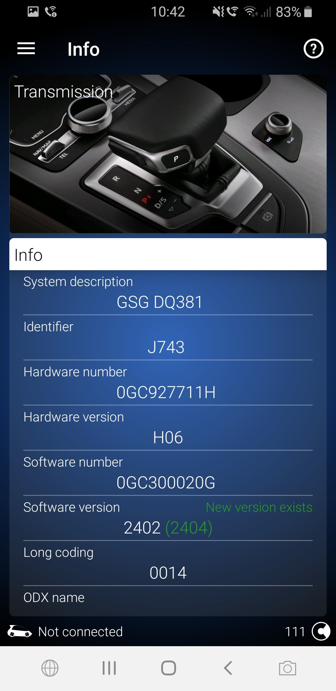

During a scan of MY 19 RS OBD11 showed me that the software on my car is old and that there's a new version of it available.
I don't know what the new software revision does, what the benefits of it are. Still as my car's now in dock for multiple reasons I've given Garlands a complete list of the software updates that are available for my vehicle, hopefully they'll install the whole lot.
Edited by TheWanderer
