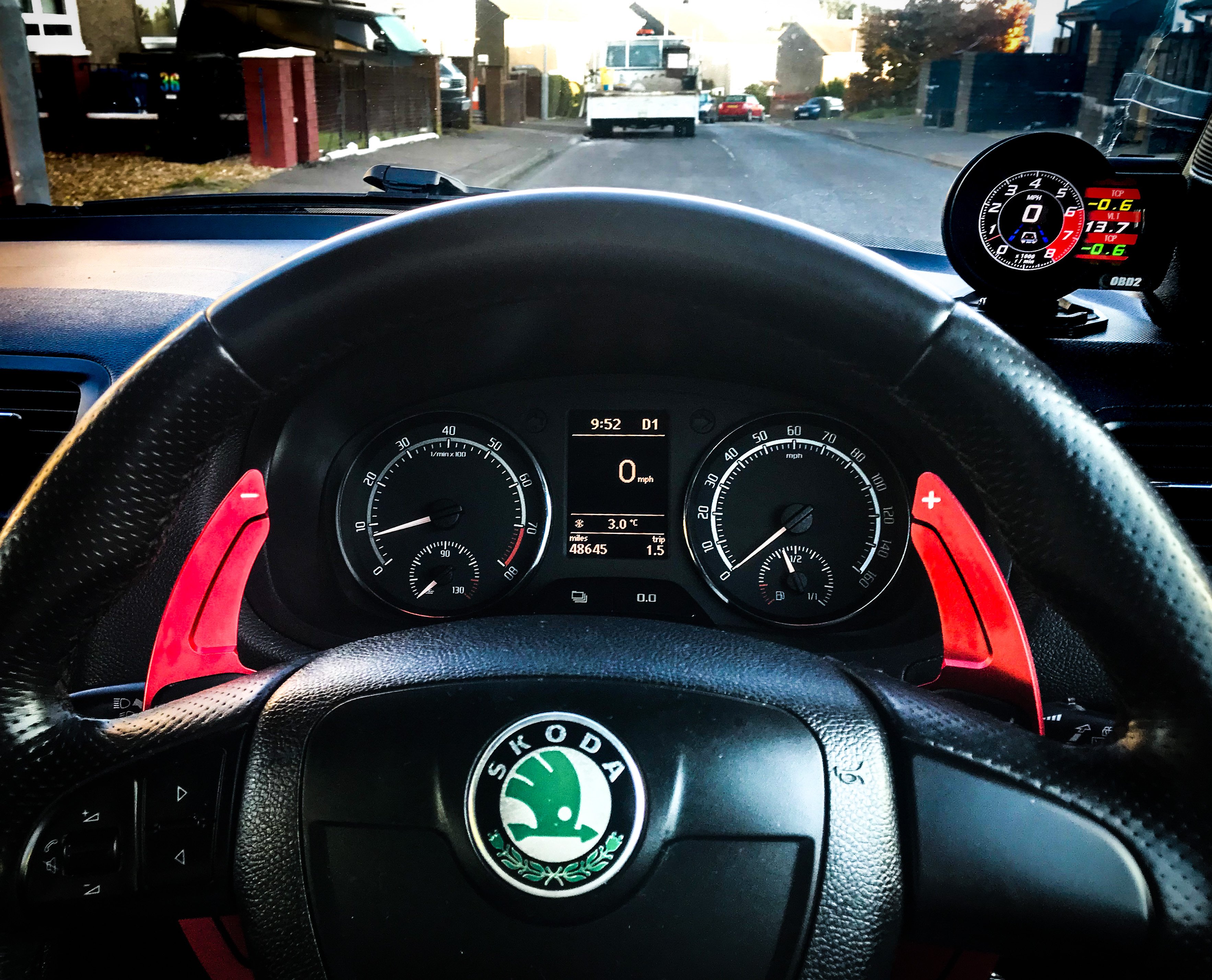

@Mickmartin
Your pic is that as custom display or do you have additional display set up boost gauge etc?

My personal choice would be the remap ecu specialist as if they might possibly have access to a rolling road or will plug it in and road test it whereas Skoda will plug it in and hit you with 100 problems and a huge bull IMO.
13 minutes ago, ArranMac1 said:
@Mickmartin
jus a digital gauge set up mate.
Edited by Mickmartin

Ah cool funky little gauge they cost much to have fitted? I know there is some where to get my oil temp back on the MFD but something to do with main dealer changing stuff??

15 minutes ago, ArranMac1 said:
@Mickmartin
Cheers for the honest advice I was kind of leaning that way he has full rolling road set up, will run full diagnostics for couple of hours see if can work out what's going on, plus he is one of my mates good friends so if get it running sweet again cheeky discount on a remap might be possible.
Wow looks like a beast from front even with the bumper off, love the bonnet vents too! 👌
The guage was only £60 and runs off the odb port so no wiring or cutting up vaccum hoses...Downside is it reads in absolute pressure however it’s easy enough to work out, Check my build thread out for more pics.
My bad I deleted that photo of the car in bits as I uploaded  it by accident.
