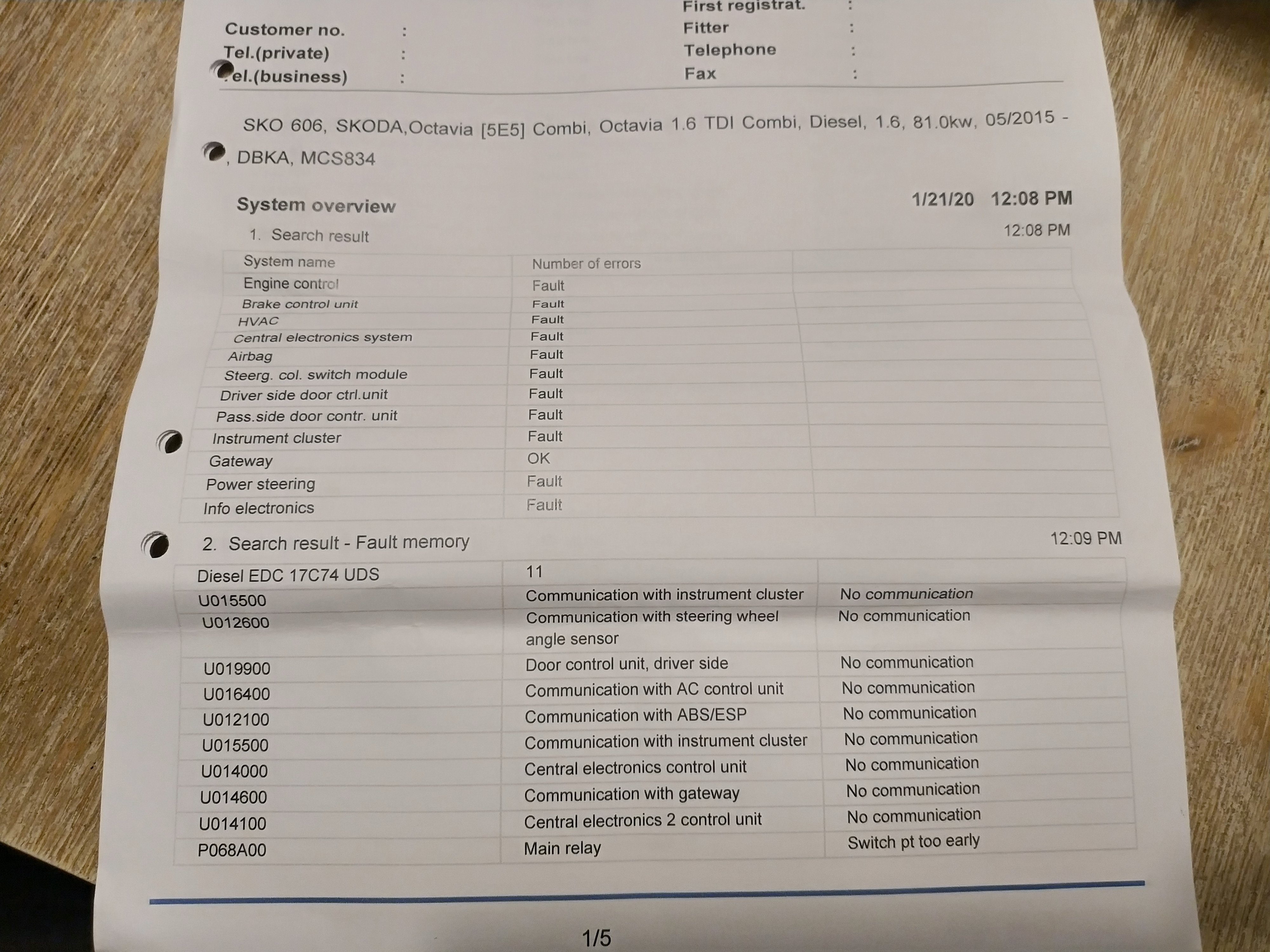

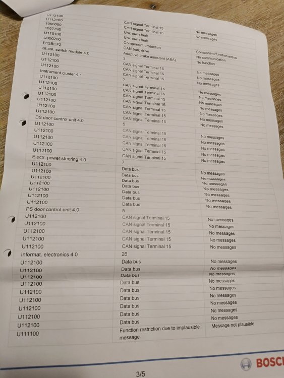

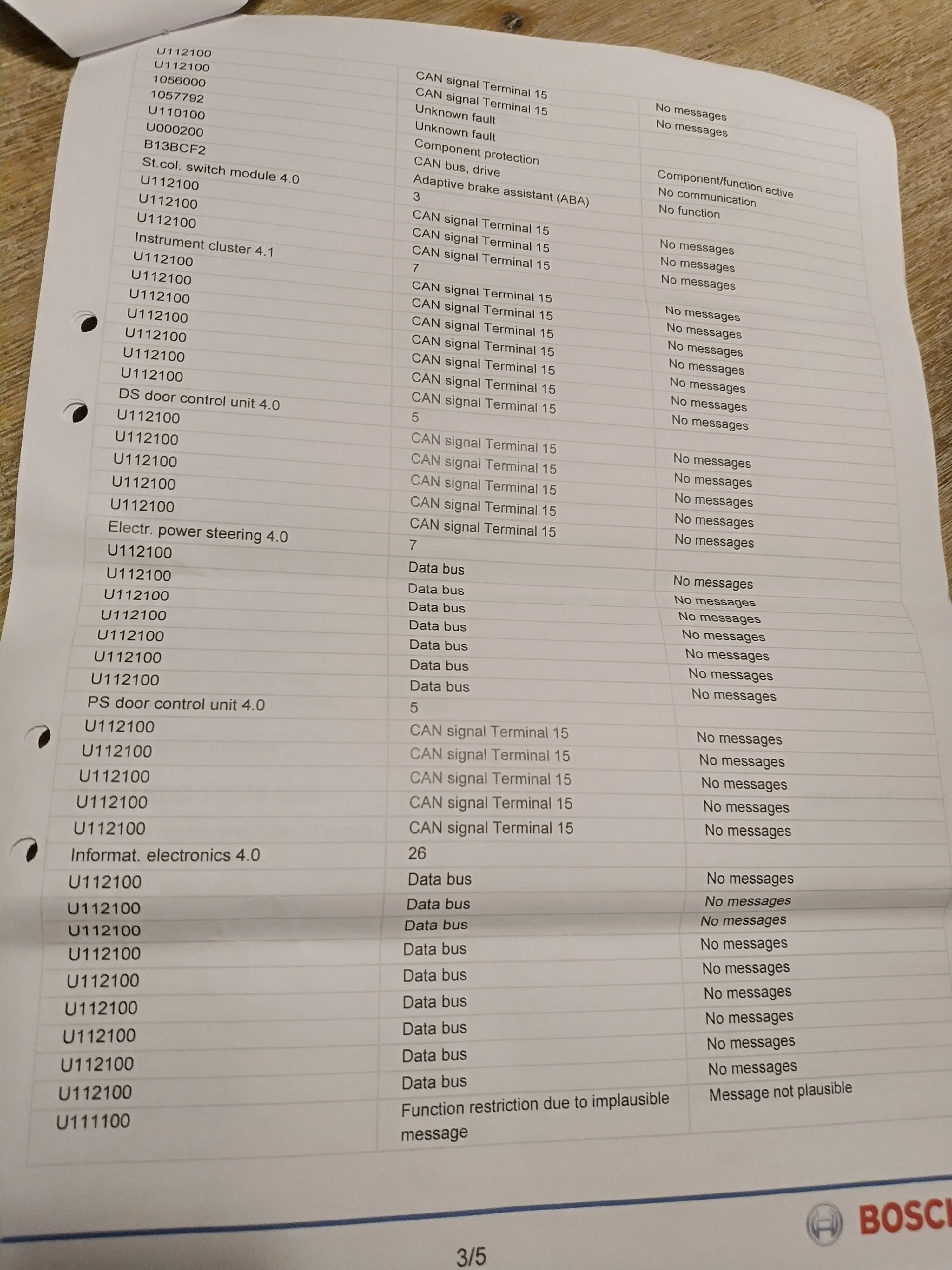

I tried to collect the car today from the workshop but couldn't because it won't start... Well it starts and the stalls. With a bunch off error codes. I got a list of 5 pages of codes... I'll post them in a bit.   All of them point to a communication problem ?... And there is a big bunch of them... I've now contacted a proper actual Skoda workshop and I'm gonna hand the car in .. at the earliest time...2 march 😭
Some pics from the workshop...
Can't upload more because of size limitations... But the rest is pretty much the same... No coms....
The mechanic at the non Skoda workshop thought it was corrupt file in the ECU or similar dataunit... Time will tell... He pointed out that sometimes a flat battery can cause this? Sounds s bit weird to me but I'm no car expert...
