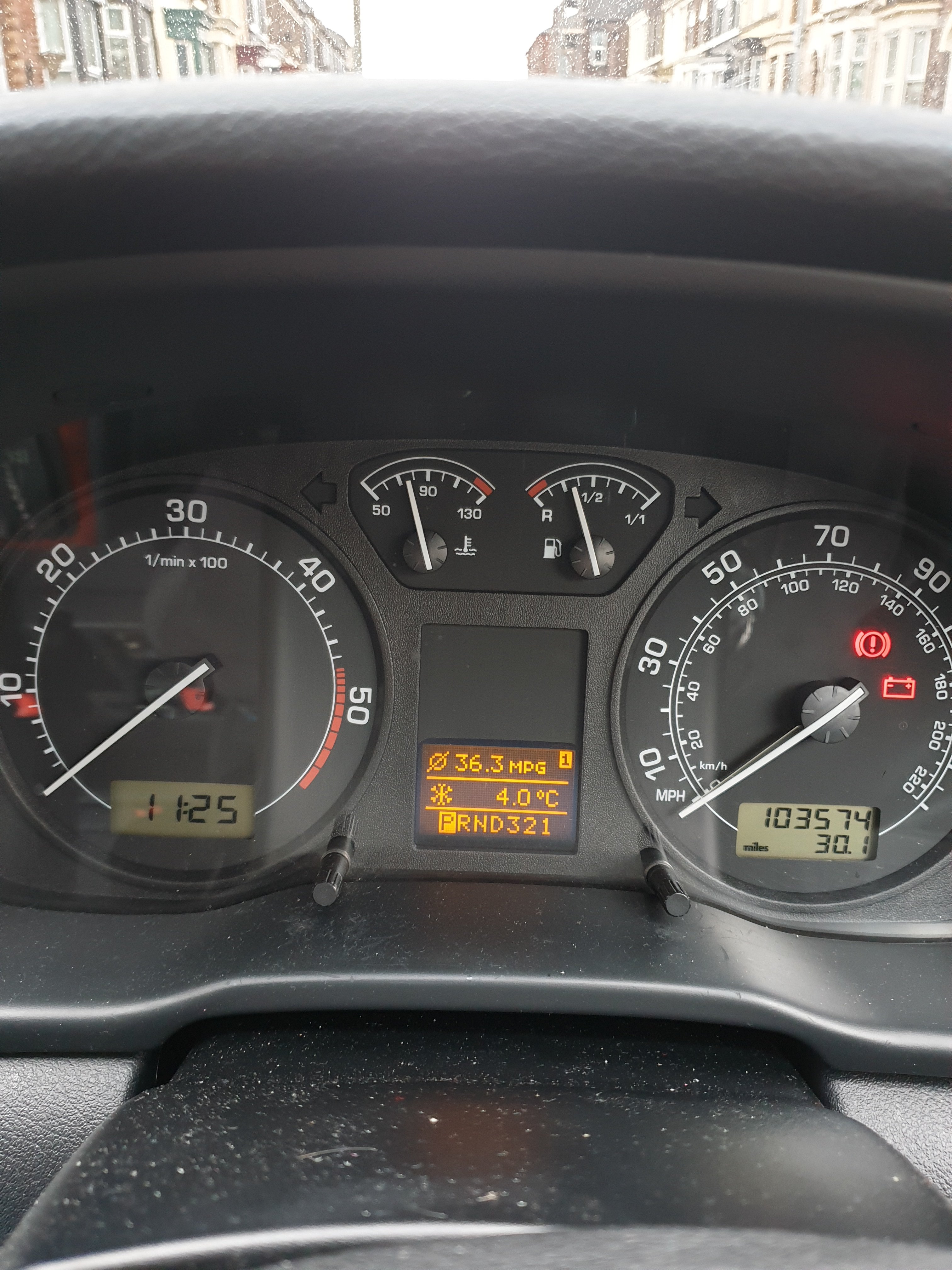

Any ideas. Temp low miles per gallon
Engine temps anything to do with low mpg. See pic of temp and average mpg
Does the engine temp increase when you're stationary or moving?
EDIT: My initial thought is the temp sensor/thermostat.  Often a problem on VW Groups cars of this vintage and when the cars where new/still in warranty, VW group replaced the units FOC as they knew they weren't fit for purpose (and yes, if the temperature readings are incorrect then a side effect could be poor economy)

Yeah I'll replace them both ASAP..also it does warm up slowly when idle. One other thing. I used a turbo cleaner additive last fill up. Seemed to work..until earlier on where it's gone back to being low powered when driven for a while..don't know if it's because this time filling up I added an injector cleaner also .wasn't even a long drive?
CTS not heating up fully makes engine over fuel.

Get a new cts and it will make a big difference.
