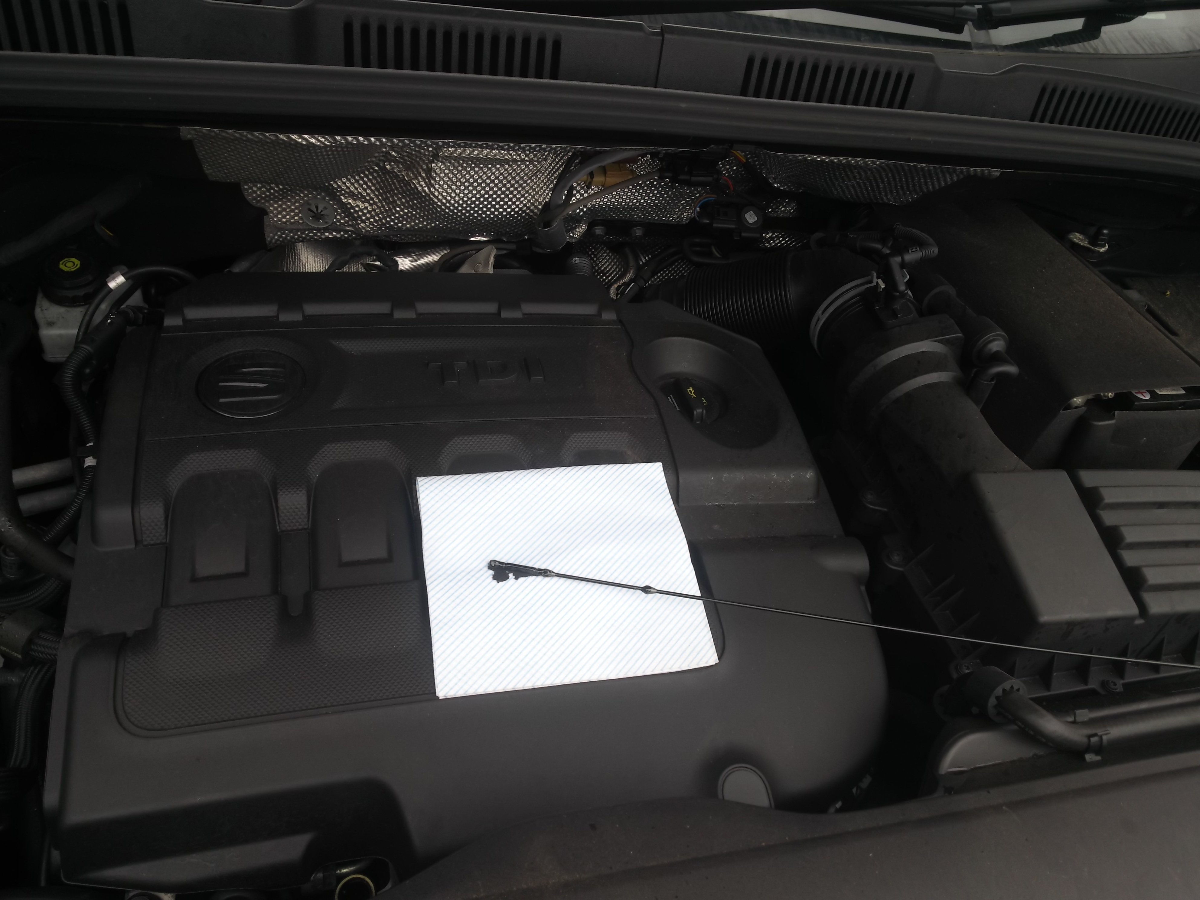

@MarkyG82
If half blind then maybe so,
Where do you swing your dip stick about as you withdraw it and give it a wipe, is that not over the top of the engine?
Maybe not, maybe just whip it out give it a shake and whack it back in.
Never looking at the coolant level either.
DSCN0239.JPG.c7eef09211e7c9d3d31714d7816239dd.JPG.95086807ff243f5e3c0257d8eb3a0871.jpeg
Edited by Roottootemoot
@Roottootemoot generally I pull the stick out and take a look while holding it over the ground in front of the car. Then give it a wipe a refit. Maybe give the coolant a glance. If I'm not overly familiar with the engine bay due to it being a new (to me) car then it would be quite possible that I would miss a missing filler cap.
I don't, because when the ground is wet it is obvious that a drip or 2 of oil hits the ground.
That is oil being checked at operating temperature.
I check the oil over the engine, wipe any drops that might drip, and usually wipe around the filler cap even if not putting oil in, sometimes there is sand and crap.
It is unusual when checking a TDI that i do not put oil in.
Anyone not noticing a hole where there should not be on the top of an engine should maybe get their eyes tested.

If you have a slightly recessed engine cover, like in George's photo, I could see it rattling around loose in that recess, and blocking any particular amount of oil spray before it got completely dislodged.  I could also see a closed bonnet keeping it located to a degree if it were not fully secure.
