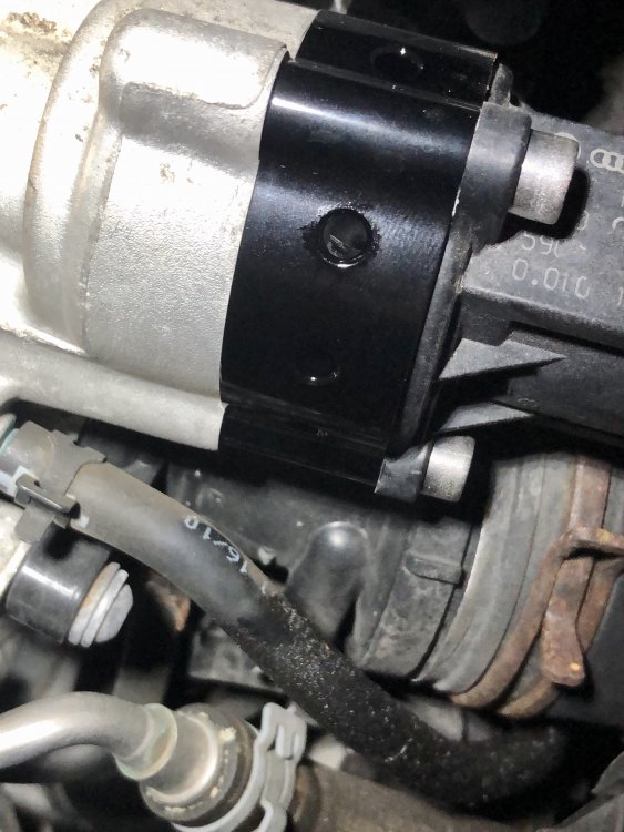

Around 2-3 weeks ago I fitted a forge BOV adapter, doing the usual under-hood checks and noticed a slight oil residue coming out the holes of the BOV adapter and a slight covering of oil on the black pipe below as you can also see in the picture.
So... my question is, is this normal or not.   I’m not very mechanically minded haha.

Not normal but not unusual either. Doesn't appear to be a great deal. Changing the fine oil separator / pcv on my fl 2.0 tsi helped reduce oil leakage there. Not sure of what is fitted to the 1.2tsi, presumably something related to blow by gasses.

Its totally normal to have a bit of oil in the intake system, if you are venting this air to atmosphere its pretty obvious there is going to be traces of oil.

im guessing the valve is some sort of hybrid recirc/bov? If so I’d agree that some oil will be normal due to the oil in the intercooler piping.
Yes, especially so, if this adaptor allows the DV to vent to atmosphere instead of recirc in the turbo, as is the standard arrangement.
